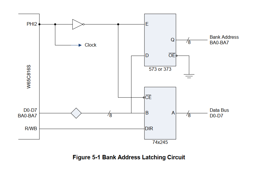

wayfarer wrote:
8 Pins, 26-33 on this pic I viewed here: https://encrypted-tbn0.gstatic.com/imag ... E&usqp=CAU
are D/B 0-7, shared or 'multiplexed'? pins that are both data and address pins.
this raises numerous ideas about the PC-MP/MC notion of video or other data over address pins instead of data pins.
for the moment however, I want to focus on the various circuits that break these pins out into two distinct paths, one for data and one for addressing. they are written in the datasheets. if it is that simple, is there an IC package with this already done, and if so, why not?
This is the Bank Address Latching Circuit from W65C816S datasheet that drogon mentioned:
There isn't a dedicated IC to break it out but that's probably for the best. It would probably cost tens of dollars whereas a couple of 74 series ICs have probably cost me not much more than a dollar and I've just dropped them in and forgotten about them.
If you're using a clock oscillator running at twice your clock speed and running it through a 74x74 flip-flip to get a nice 50/50 duty cycle then you will already have the inverse clock from /Q and will not need the inverter. In my case I need a 74LVC4245* to do voltage translation as the '816 is the only IC I have that is at 5V CMOS voltage levels - everything else is 3.3V TTL voltage levels - so I needed a '245 anyway. That leaves only the '573 as a bit of a nuisance.
Adrien Kohlbecker speaks about the latching circuit in his first two videos Bank Address Latch and Data Buffering on the '816. He goes into quite a lot of depth in the timing requirements too.

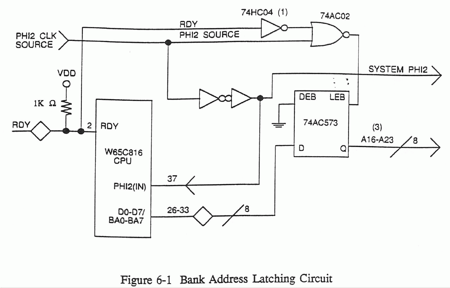

AndrewP wrote:
This is the Bank Address Latching Circuit from W65C816S datasheet that drogon mentioned...
Check out this bank latch version from a 1994 edition of the 65C816 data sheet I recently discovered while cleaning out a file cabinet in my office:
File comment: 65C816 Bank Latch w/RDY Control
I also have a 1991 data sheet that I’ve scanned into a PDF (attached), which describes the 65C802, as well as the 816, but makes no reference whatsoever to a bank latch circuit. I guess you were expected to dream up your own design by staring at the data sheet and trying to guess what was going on. :D
I can only imagine what 65C816 data sheets from the 1980s must’ve look like. I’m suspecting poor-quality documentation likely hampered the acceptance of the 816 by anyone other than Apple.

wayfarer wrote:
So the shared data pins, they are clearly R/W depending on what they are doing at the time, and the rest of the data pins are R/W; what about the rest of the address pins?
D0-D7 is “multiplexed,” not “shared.” “Multiplexed” means different signals are present during the two clock phases. The bank latch separates the A16-A23 address component from data by opening only when Ø2 is low. The other multiplexed output is M/X, which indicates in real time the state of the m and x bits in the status register—m is present during Ø2 low. As with capturing A16-A23, latches are required in order to use M/X.
The 816 always emits A16-A23 on D0-D7 during Ø2 low, i.e., D0-D7 are always outputs when the clock is low, regardless of the state of RWB. This occurs tBAS nanoseconds after the fall of the clock. A0-A15, VDA and VPA become valid tADS nanoseconds after the fall of the clock. According to the data sheet, tBAS is slightly longer (worst case) than tADS. It’s kind of screwy and I am inclined to think the data sheet is in error, as according to it, the 816 should barely function at 14 MHz. However, WDC advised me that production testing is at 20 MHz. My POC V1.2 unit ran fine at 20 MHz and others have run their 816 machines even faster.
I know its a silly notion, I just want to make sure, the address pins always assert a voltage, they always write, they never are selected or driven or use to read by the 65816/6502 correct?
A0-A15 are always outputs, unless the BE (bus enable) input is low, in which case, A0-A15, D0-D7 and RWB are hi-Z (BE has no effect on other outputs, e.g., MLB). RDY is bi-directional. All of this is covered in the 816’s data sheet.
