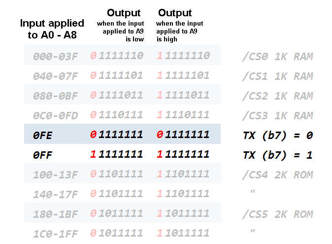

PostPosted: Thu Mar 23, 2023 6:58 am
Posts: 589
hmmm, does the ROM contain a pair of locations whose Bit7 content deviates from the rule I described above?
Yes... Here's how I imagined the ROM tables could be set up (see below). Use something like sta $0FE0 to set TX = 0 and sta $0FF0 to set TX = 1.
My question is whether this B7 -> A9 connection can create a viable 'latch' that can survive address/data transitions? Do you get nice smooth data output transitions if you're not toggling the ROM chip select and output enable inputs each clock cycle?

PostPosted: Thu Mar 23, 2023 12:57 pm
I think you can get nice smooth data output transitions if /CS and /OE are held low and only one address input changes state. Indeed, I remember a homebrew CPU whose main board featured about a dozen very large EPROMs... and, astonishingly, no 574s or similar registers! :shock: If I can find the link again I'll post it. Anyway, IIRC the EPROMs had /CS and /OE held low, and they were being "clocked" (!!!) by having only one address input change state.
Your proposed scheme fails to meet the stipulation of only one address input changing state, so I think you have to assume there will glitches on the outputs. But perhaps the glitches could be absorbed by a simple low pass RC filter between D7 and A9. The time constant would have to be slow enough to eat a glitch but fast enough to respond when there's a memory access that's intended to change the Bit7/A9 state. And arranging that doesn't sound too hard, assuming that a glitch will be much shorter than a memory access... :)
ps- in case anyone's drawing a blank on the chart (as I initially did), perhaps this version will be helpful.
