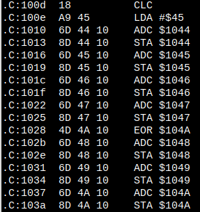

IamRob wrote:
I would imagine some starting seeds would go farther than others? What starting seed did you use to get the 4 GB output?
I used all zeroes for testing.

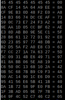

Arlet, i've not the same results with seed: .byte $00,$00,$00,$00,$00,$00,$00
How do you create the next byte? do you call the first line $100D for each new byte ?
Here is my code first byte:
Second byte:

Oops. I see that something went wrong in my test code. I used some C macros to emulate the ADC instruction, and didn't use enough parentheses.
Unfortunately, there's no easy way to fix the 6502 code to do the same.
Fortunately, even though my output was all wrong, the actual 6502 code was working fine for the intended purpose. I have fixed my emulation, and the random number output still passes PractRand (up to 16 GB right now, and still going).

Arlet wrote:
Here's my attempt at a random number generator optimized for 6502. An 8 bit random number is returned in A. It needs 7 bytes of RAM (preferably zero page), and has a period guaranteed to be at least 32 bits. It passes Dieharder and PractRand tests (up to at least 4GB of output).
I find this quite intriguing! I ported it to BBC Basic so I could easily see how the state vector evolves (especially with numbers other than 0x45)

If we change 0x45 to 0x01 it's not too hard to follow the first round or two
RUN
         0     10101   1010101
         2     70605   5040302
        17    1A130D   F0A0603
        35    735946  23140A04

Here is the detailed code for educational purpose.
// ARLET RANDOM C CODE
