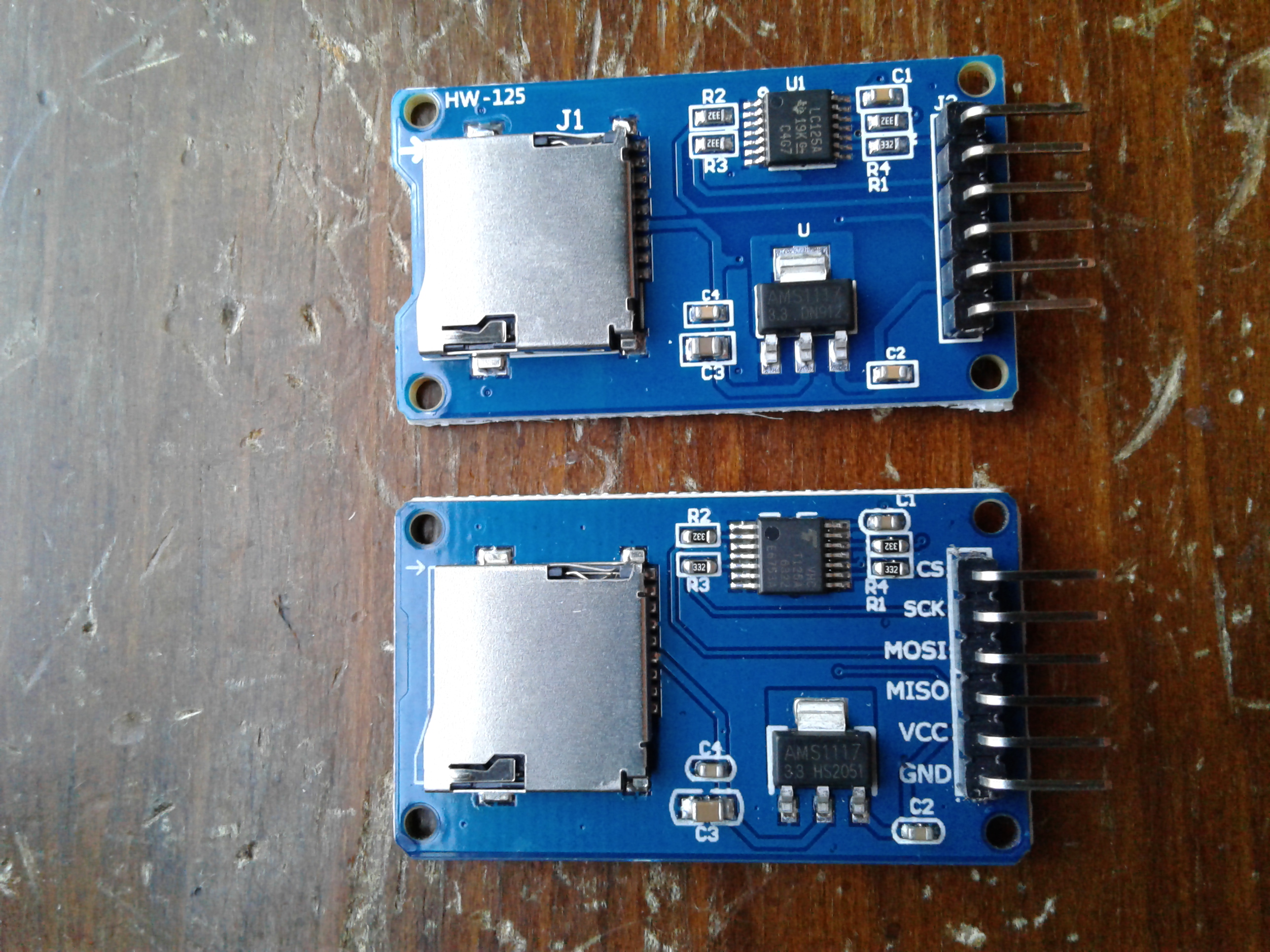

Can you spot the difference in the picture below?
The one on the left (without edge cut) uses a T125A, the one on the right (with edge cut) uses an LC125A. World of difference.

Testing: For months now, I've been using the MicroSD card adapter on the left. And had NEVER NOTICED this behavior. Ever. But on my most recent board, I used the MicroSD card adapter on the right, and it was very screwy. It does continue to drive the MISO line even when CS is high, but Elm-Chan is right in that 8 clock pulses and that's no longer the case... mostly. This particular MicroSD card adapter stopped driving the MISO line high, but started to toggle between high and low at near random it seemed. It wasn't floating, it would drive it (at least) low for some time, like a second or so between changes.
Then I would have another SPI device try to drive the MISO line, and I got: A) all $FF's, B) corrupted data, or C) good data. It was nearly random, as long as I pulsed that clock 8 times before it would *try* to work, but would only work sometimes. If I popped the SDcard out of the socket (but kept the adapter on board), it would work again... mostly. I think it would permanently drive the signal low or something, but not hard enough to force other devices off the line. Very strange activity.
Conclusion: Not all MicroSD card adapters are the same! The one of the left, using the T125A, seems to make the SD card act like an actual SPI device, releasing the MISO line when not in use (as *should* be expected). The one on the right, using the LC125A, continues to drive the MISO line as Elm-Chan and George Foot both have also witnessed.
Ponderings: So, was I just lucky in getting a 'better' version at first? Or should an SPI adapter be expected to act like an actual SPI device?

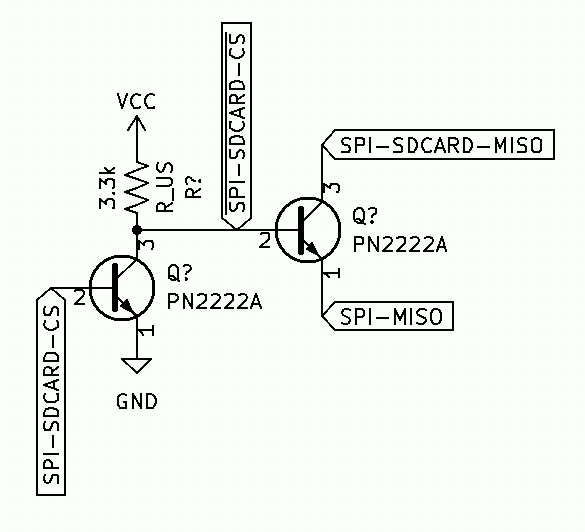

Anyways, I found a solution using 2x PN2222A transistors and 1x 3.3K ohm resistor. Attached is a picture. Basically I'm inverting the /CS line, and using the inverted signal to (essentially) tri-state the MISO line. I am having no problems with any other SPI devices that are plugged into the system now. The old adapter works great, the new one works... mostly. It has been sending an error on the first attempt to start every time, so I just told it to 'try twice' and it works fine now. Silly way of doing it, but hey, it works.
Whelp, there is my full analysis. You now have the problem, and the solution. Thanks!
Chad
