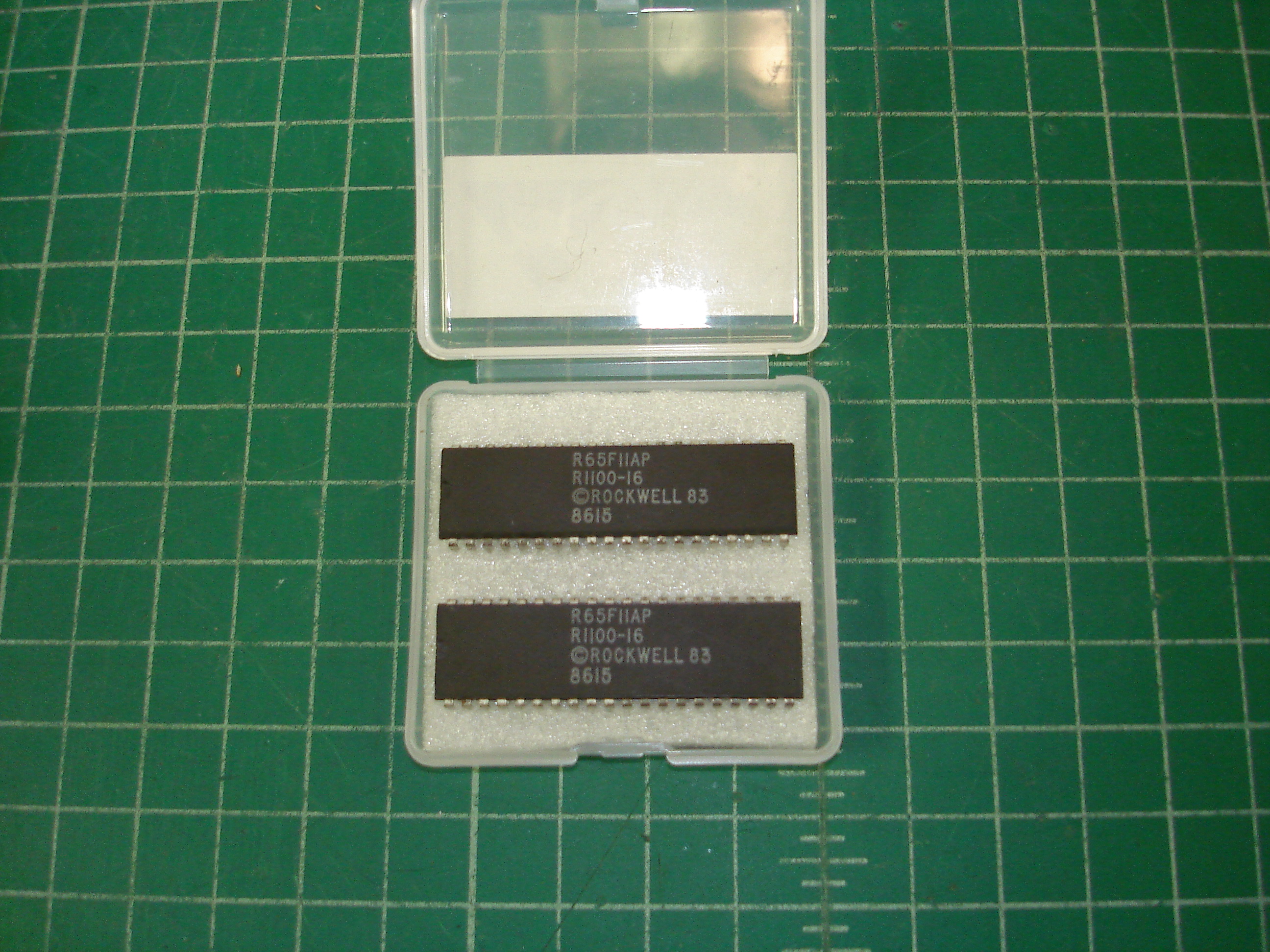

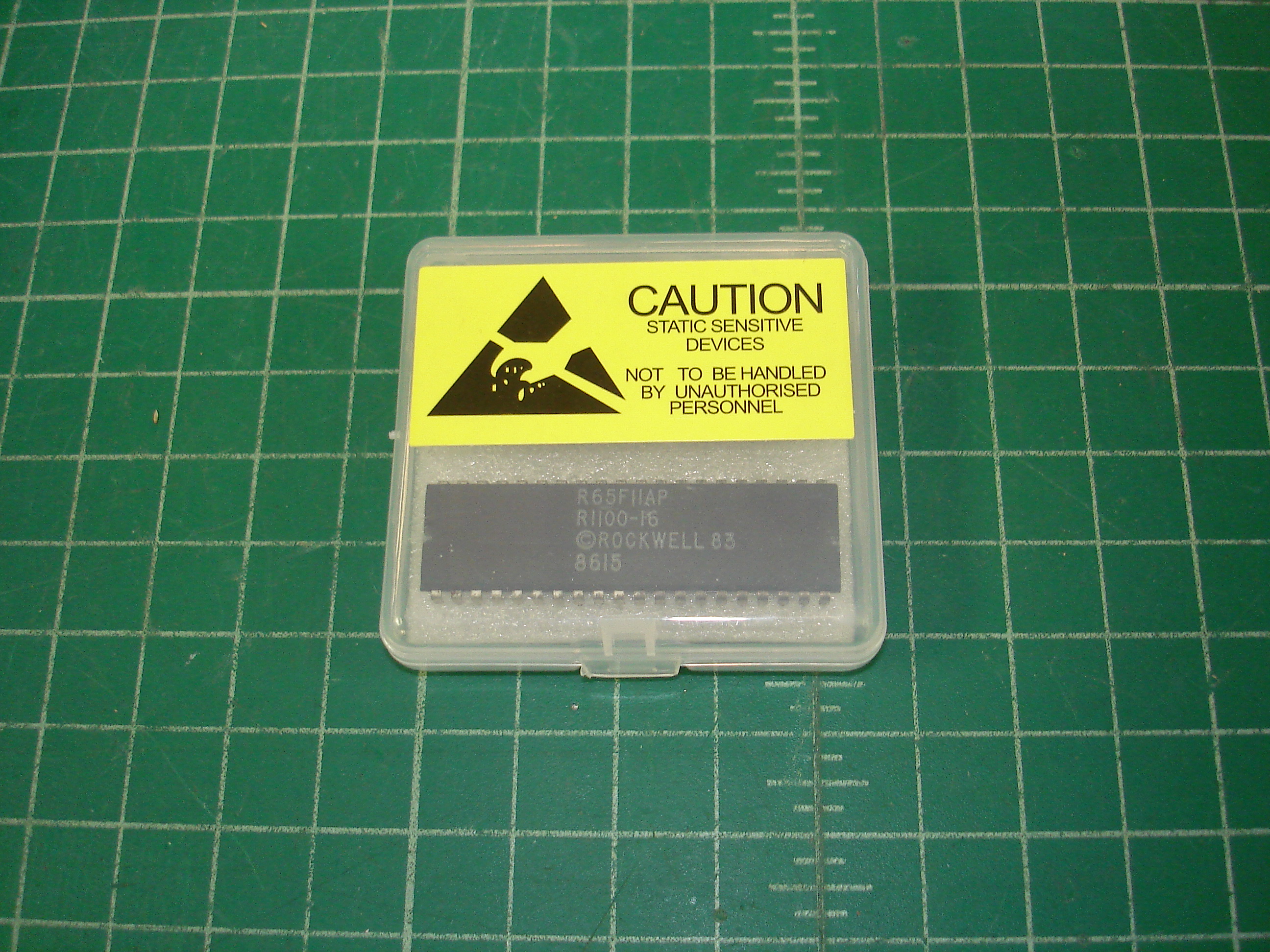

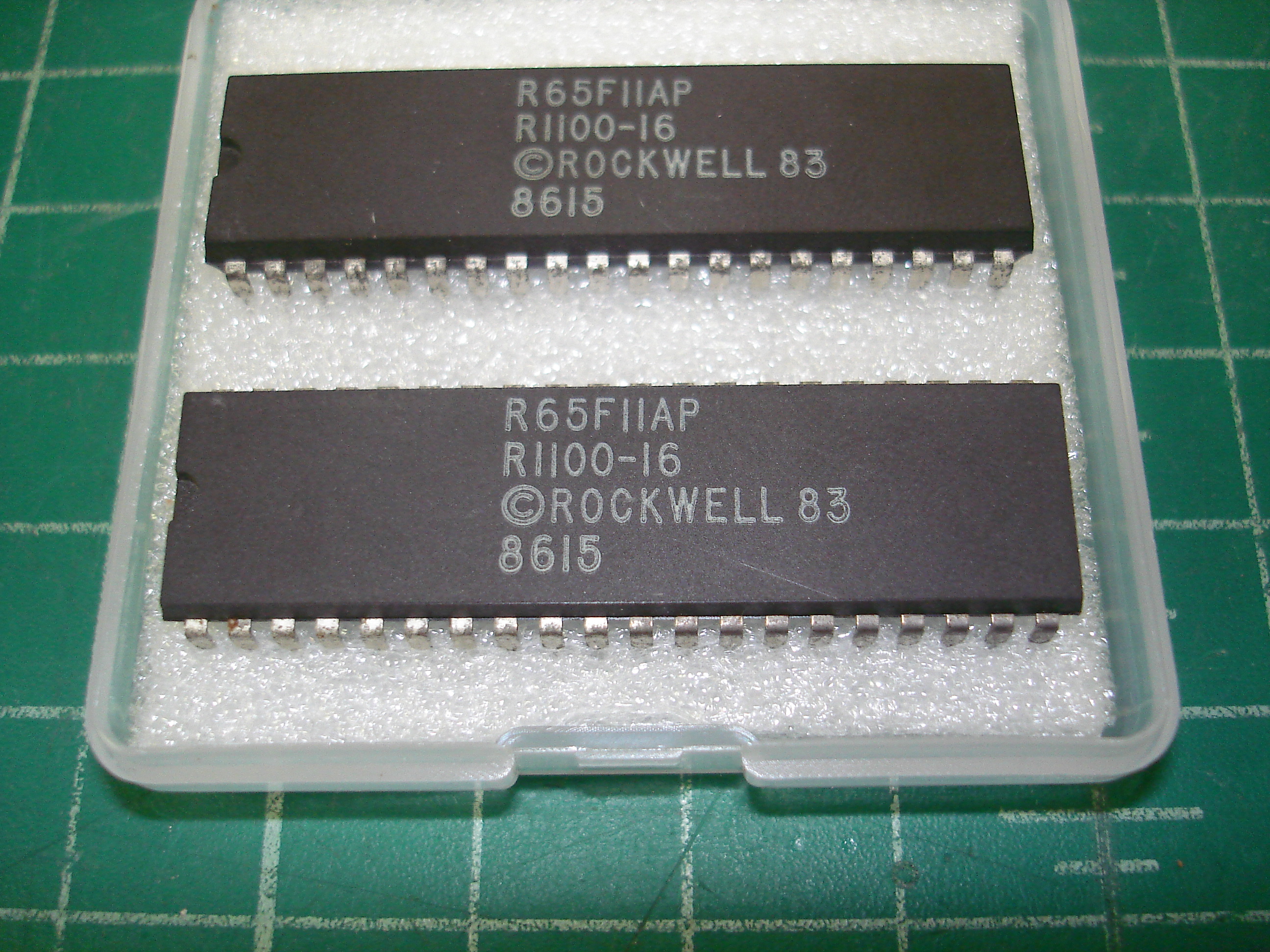

These finally arrived! I tested them in my little R65F11 project board and they work; however, I ordered three and the seller only shipped two. I've contacted them to see if I can get the third shipped to me, as these are nice quality chips that haven't been "refurbished" (blacktopped or walnut blasted, and new marking engraved). Here's a picture of them, as received:

Final follow-up, the seller did send the chip missing from the initial order, and the one received is also genuine and not remarked.
