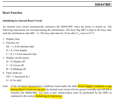

That version of the code is intended to be used with the slow clock. It won't work with the 1MHz crystal because it does not include logic to wait for the LCD to be 'ready' before sending each command, hence the missing characters. You'll want the 'final' version of the code instead: https://eater.net/downloads/hello-world-final.s.

If I remember correctly, Ben's code worked on Blue April but only at power up. The power up met the LCD module's setup requirements, but a system reset did not; so it would stop working after a reset. Using the full setup sequence Garth described along with some appropriately proportioned delay loops let me run Blue April at 8Mhz (instead of 1Mhz!) and also switch the LCD to 4-bit mode.
For me, Ben's code worked fine at higher clock speeds and after power on or reset, as long as I was using 8-bit mode for the LCD. It was only once I switched to 4-bit mode that I discovered the need for the extended "3x" initialization sequence which handles the LCD being in an unknown state re 8-bit vs. 4-bit mode depending on power on vs. reset. In my experience, as long as the LCD is never put into 4-bit mode, the shorter initialization sequence is reliable since it can count on the LCD being in 8-bit mode when it runs.

The Hitachi datasheets currently available online (excerpt below) state that the internal reset can fail if power supply conditions are outside the supported envelope. So that is a documented scenario in which the 3x initialization (which the datasheet calls 'initializing by instruction') is required. Of course I have no idea if that could have been what Garth experienced back then at work.

That said, I think OPs main problem (as I posted earlier) is the code they are using does not include the LCD busy flag checks - the code they posted is an interim simplified version designed for a 'slow' clock module. I know from experience it produces garbled output when run at 1MHz, which happens because at that clock speed it sends commands to the LCD controller while it is still busy executing prior commands.
