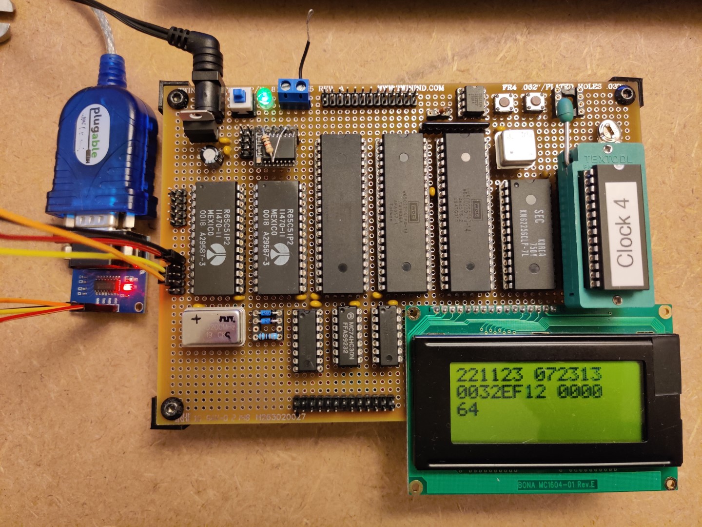

I have completed my rebuild.
It works.
I don't (yet) have theory why it works - or rather, why the old one didn't.
The old one worked with a Rockwell 65C02 so its wiring was correct as per the schematic. It did'nt work with the WDC 65C02.
This one works and is steady as a rock. It has run a memory test program for 48 hours now.
I will think about it some more and post my thoughts soon.
EDIT: I may have found the issue. I made one change in the new build. I replaced the Alliance AS 6C62256 RAM chip with a Samsung KM62256CLP-7L which as far as I can see is pretty much identical in spec. This is the one that has just undergone 48 hrs testing.If I replace it with the Alliance chip, I get errors. I have two other Alliance chips, all the same - 6C62256 - various levels of crash.
I can't determine if it is timing problems or all three Alliance chips are damaged. I will make a ram tester with some breadboard and an Arduino when I get a moment.
Thank you once again for all the help and thoughts from everyone.

Glad to hear that you are successful. Also interested that you have had the same experience with the Alliance chips that I did in my reply on Nov7. It would be interesting to understand exactly why this is the case as you have 3 and I have 2 that would make us very skeptical of where and how to use them in future designs. It is also interesting that floobydust and plasmo have not noted these issues in their experience. My hardware skills are limited so I don't expect to solve this on my own but will follow any future discussion with interest.
It's perhaps neither a timing problem nor damaged chips. Instead, we might be circling back to the question of whether or not the RAM's output levels sufficiently exceed their spec (which promises only TTL levels). If not, then the non-TTL-compatible WDC CPU can't be expected to operate reliably.
You didn't mention whether the Alliance chips work properly when the TTL-compatible Rockwell CPU is in use... Might be interesting to try that if you haven't already. Just a suggestion...
Hmmm... So, will the tester be satisfied with mere TTL logic levels from the RAM? Or will it, like a WDC CPU, require something beyond TTL spec? Seems like a pertinent question, I'd say.
It would be interesting if the tester included a socket for a '245 transceiver on the RAM's data bus. Then you'd have the option to put either an 'HC245 or an 'HCT245 in there, and compare results. (You might find this idea preferable to swapping WDC vs Rockwell CPU's in your SBC... a process with which you understandably may've grown frustrated!)
Alternatively, you could 'scope the RAM's output levels while the test runs (presumably at fairly low frequency). I expect you'd get much cleaner traces than those taken from the SBC.
Sorry Jeff, my barin [edit: whats's a barin?? ] brain wasn't working. I was thinking about "signal levels" and all your help when I posted that above and "typed timing problems"! Unlikely to be timing problems at 1mHz.
