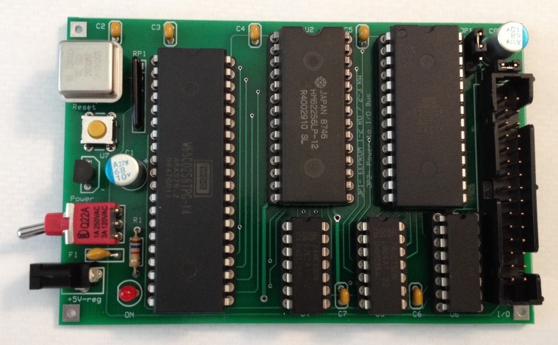

Just to chime in... attached is a pic of an old CPU only (2-layer) PCB I did over a decade ago. The actual design dates back to the 80's... but it's quite similar to what you have. 7400, 7430, 74138, RAM, ROM, CPU. The layout is compact and there's a 30-pin dual header for attaching I/O.
I built up 3 of these with an I/O board that uses a 65C22 and 65C51... I've run them at 4MHz without issue (with a Rockwell R65C51P4). I've also used the same Alliance memory on this board along with both 74HCT and 74HC logic chips without issues. The full design is on my github.
It's still quite odd that you're having such problems. The design is almost identical and I've never had a single issue... go figure.
