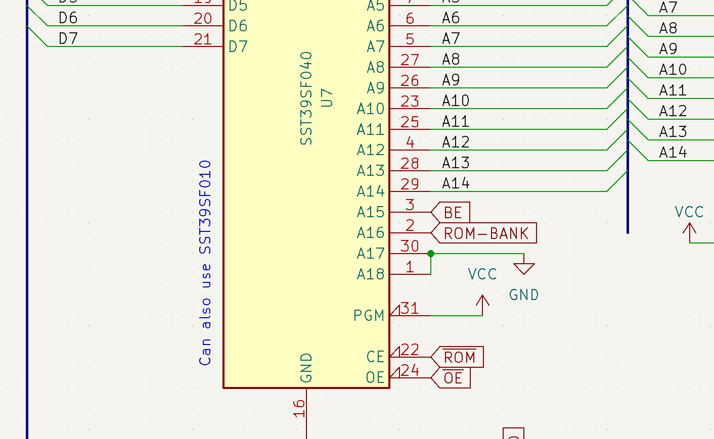

Hello everyone!
I'm here today to ask for a second pair of eyes on my schematic. Full story (still short): I had been working on a design like this for almost 6 months, but when I soldered it all together a couple of weeks ago, DOA. I am pretty sure it is data-bus contention because I tied BE directly to PHI2. To correct this mistake, I have redesigned the computer and am posting what I have here.
Here is the link to my video explaining the schematics, it's 12 minutes long:
<VIDEO LINK DELETED>
Attached are the B&W and Color versions of the Schematic I used in the video. Also, below is my IRQ-ISR code.
I would love to have your opinions on it. Not just that, but if you find anything that potentially won't work, I would *love* to know now before I order some boards and waste money on soldering parts to a large paperweight (again).
This is not meant to be fancy! It is fairly simplistic, hardly any expansion capabilities, but that's just the point. I'm not looking for "hey you should add X to it", I'm looking for "hey your logic here is wrong."
Any criticism is greatly welcomed. Thank you all very much, have a wonderful day.
Chad

PostPosted: Wed Nov 02, 2022 6:34 pm
Posts: 8514
What’s the purpose of wiring the MPU’s BE to Ø2?
irq_store              ; cycles = 1 (sub-total 34)
   PHA                 ; cycles = 3
   PHX                 ; cycles = 3
   LDA key_data        ; cycles = 4
   LDX key_write       ; cycles = 4
   STA key_array,X     ; cycles = 5
   PLX                 ; cycles = 4
   PLA                 ; cycles = 4
   INC key_write       ; cycles = 6
   PLX                 ; cycles = 4     <———???
   PLA                 ; cycles = 4     <———???
   RTI                 ; cycles = 6 -> total = 82
The above code segment appears to be putting the stack out of balance. If so, it will virtually guarantee the system will go haywire.
Well, big oops on my code! Yes indeed to that, I just fixed it. Thank you for that. I must have missed that while copy/pasting something back and forth.
I wasn't using this code on the previous build, I was using a VIA for all I/O there, so I had my traditional IRQ-ISR. I know that wasn't the reason for the last board not working.
When BE is high, the 6502 runs as usual. When BE is low, the addr and data buses go to high-Z, which allows for my '590 counters to jump onto the address bus and talk to the RAM and ROM directly for the video colors and signals. I do this while PHI2 is low, so thus:
BE high -> PHI2 high
BE low -> PHI2 low
On this particular build, I forced BE to only go low during the second half of PHI2-low, allowing for the PHI2 falling edge to have the address and data buses unaffected. Essentially the BE line is saving me about 3x '245 chips.
But now that we are talking about it, I have something small to alter. I'm going to replace the A15 line on the ROM with BE instead of PHI2. Attached is the change. Thank you BDD.
Chad
EDIT: Added the B&W version too.
I'm not seeing what you changed due to your graphic having color combinations I can’t discern.
PostPosted: Wed Nov 02, 2022 10:12 pm
Posts: 718
Just attached the B&W version too, sorry about that BDD.
