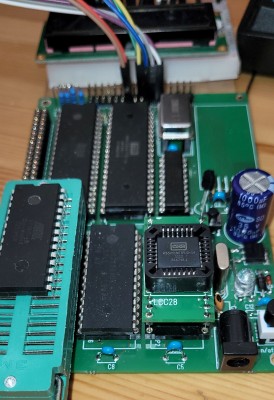

Just remember that the W65C51 has the xmit bit defect, which includes the DIP and PLCC versions:
viewtopic.php?f=4&t=2543&start=30#p29001
Also note that the latest WDC parts require a 1Meg resistor in parallel with the crystal to oscillate.

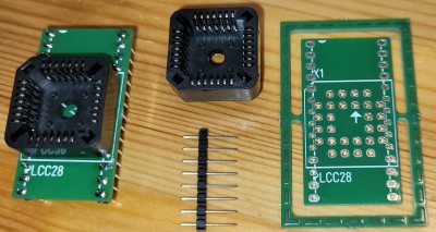

Adapter time,
PCB have come and seems to work.

Nice! Can you give a link to those pins. Interplex NAS has some nice pins for this kind of application but I just looked into them for a work project and found that because they have so many combinations of options, they don't want to stock them or even start up the machines to make them until you order, and minimum order was tens of thousands of dollars, non-returnable and non-cancelable! We had to find a different way to do the job.
PostPosted: Sun Oct 02, 2022 7:54 am
Joined: Wed Jul 27, 2022 6:14 am
Posts: 54
Sure, this are Pin strip RM 2.54mm, straight, 1-row, 36-pin with round contacts 0.5mm.
https://www.reichelt.de/stiftleiste-rm- ... tml?&nbc=1
Its my favorite distributor for my personal use.
Here is the datasheet:
https://www.reichelt.de/index.html?ACTI ... _DB-DE.pdf

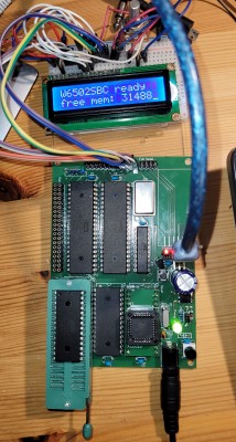

Next big step done:
implementing 6551 transmit/receive and a extended version of wozmon:
https://hackaday.io/project/186414-w650 ... 5c51-die-2
Mow the next evolution is coming, a simple basic...
