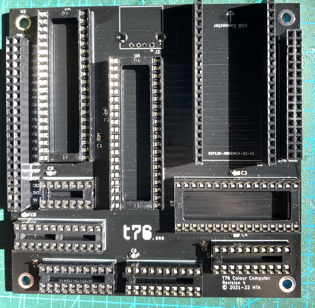

Hi all!
I ordered a new batch of PCBs for my SBC, and, now that I have received them, the power rails are, inexplicably, shorted together, even with no components soldered on. I can't see anything in my schematic that suggests that anything is amiss, and so I'm not sure if there was an issue with manufacturing, or if there is a problem with my board :-)
I attached the gerbers and schematic here in case anyone wants to try and see if they spot the problem, but mostly I would be grateful for suggestions on how I could figure out whether this is on my end or whether I should get in touch with the manufacturer. The schematic is a bit terse, I apologize—I could redraw it, but I'm afraid that I would accidentally fix the problem and make things even worse.
TBH, I'm all out of ideas, though maybe I'll get some fresh inspiration tomorrow after a few hours of sleep.
—Marco
gerber.zip [515.14 KiB]

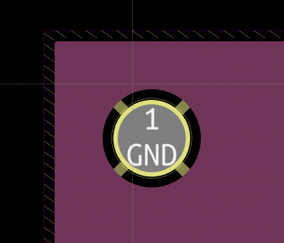

The mounting hole (H2) at upper left corner next to U9 may be the problem. It is a plated-through hole but there are no clearance pads for power nor ground plane so power and ground are shorted.
Bill, thank you so much, I think that's it! That mounting hole was clearly not rendered at all in the inner layers. That's got to be some kind of weird bug in KiCAD… I didn't notice because I was looking at the actual layout inside the program instead of looking at the gerbers, and the problem doesn't show up there:
Interestingly enough, I just plotted the gerbers again, and now they look fine. Gotta love software :-)
Well, mystery solved! At least it's not some design mistake, and in the end it only cost me a few dollars… and a couple weeks' of wait time. I suppose I could try cutting that corner off the board to see if it solves the problem, though I suspect that the risk of shorting the power planes along the cut would still be pretty high.
Thanks again for all the help!

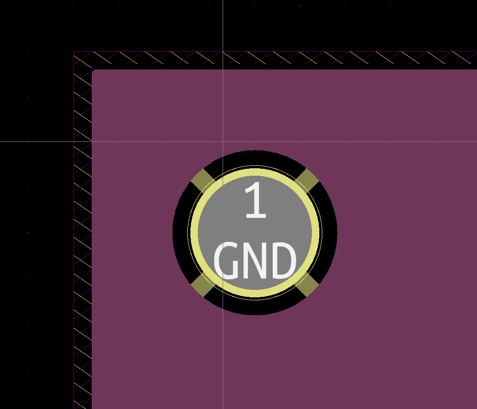

speculatrix wrote:
Is it possible you forgot to rerender the fills before outputting. When using KiCad I keep hitting the B key like it’s some kind of nervous tic.
I usually have automatic refilling turned on in the plotting dialogue, but what happened this time around is that I used a plugin to render the gerbers, and perhaps it didn't run a fill command. I don't think I will be using it again :-)
In any case, I followed George's suggestion and drilled the plating out of the mounting hole, and that seems to have done the trick—no more shorts. On to the next fault!
