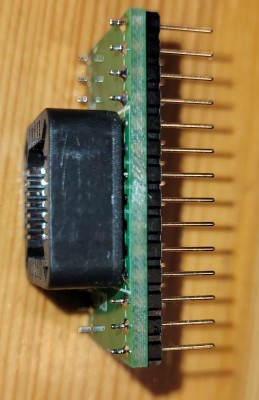

Adapter time,
PCB have come and seems to work.

PostPosted: Sat Oct 01, 2022 6:31 pm
Posts: 8436
Nice! Can you give a link to those pins. Interplex NAS has some nice pins for this kind of application but I just looked into them for a work project and found that because they have so many combinations of options, they don't want to stock them or even start up the machines to make them until you order, and minimum order was tens of thousands of dollars, non-returnable and non-cancelable! We had to find a different way to do the job.
PostPosted: Sun Oct 02, 2022 7:54 am
Joined: Wed Jul 27, 2022 6:14 am
Posts: 54
Sure, this are Pin strip RM 2.54mm, straight, 1-row, 36-pin with round contacts 0.5mm.
https://www.reichelt.de/stiftleiste-rm- ... tml?&nbc=1
Its my favorite distributor for my personal use.
Here is the datasheet:
https://www.reichelt.de/index.html?ACTI ... _DB-DE.pdf
