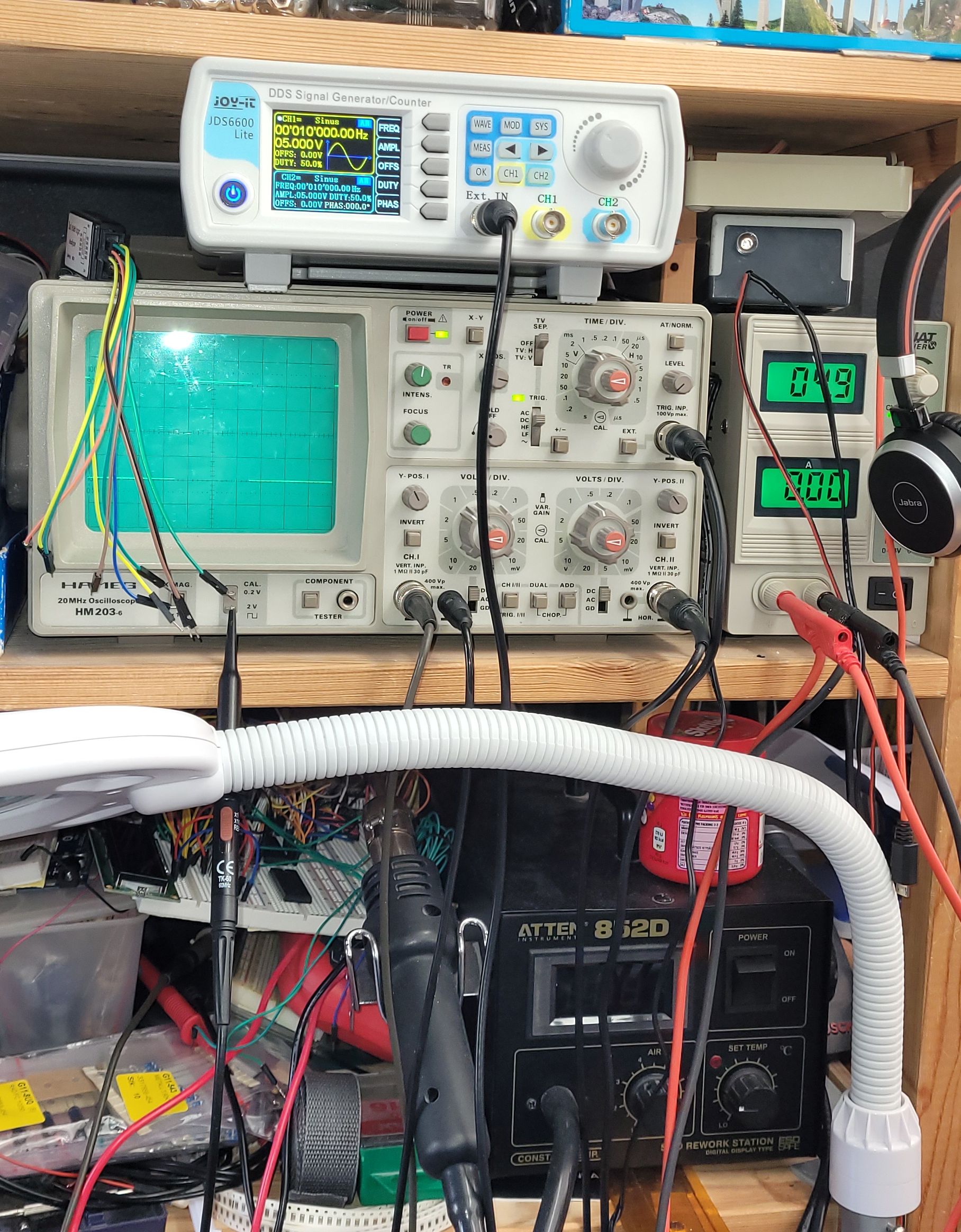

i love my hameg. This one is round about 35 years old. The function generatr abouve just 1/2 year.
I had several UNI-T's, i think they're ok, but i didn't try to get support or repair something.
Don't be angry with me, but 12 years for a digital device from China is a decent amount of time.
