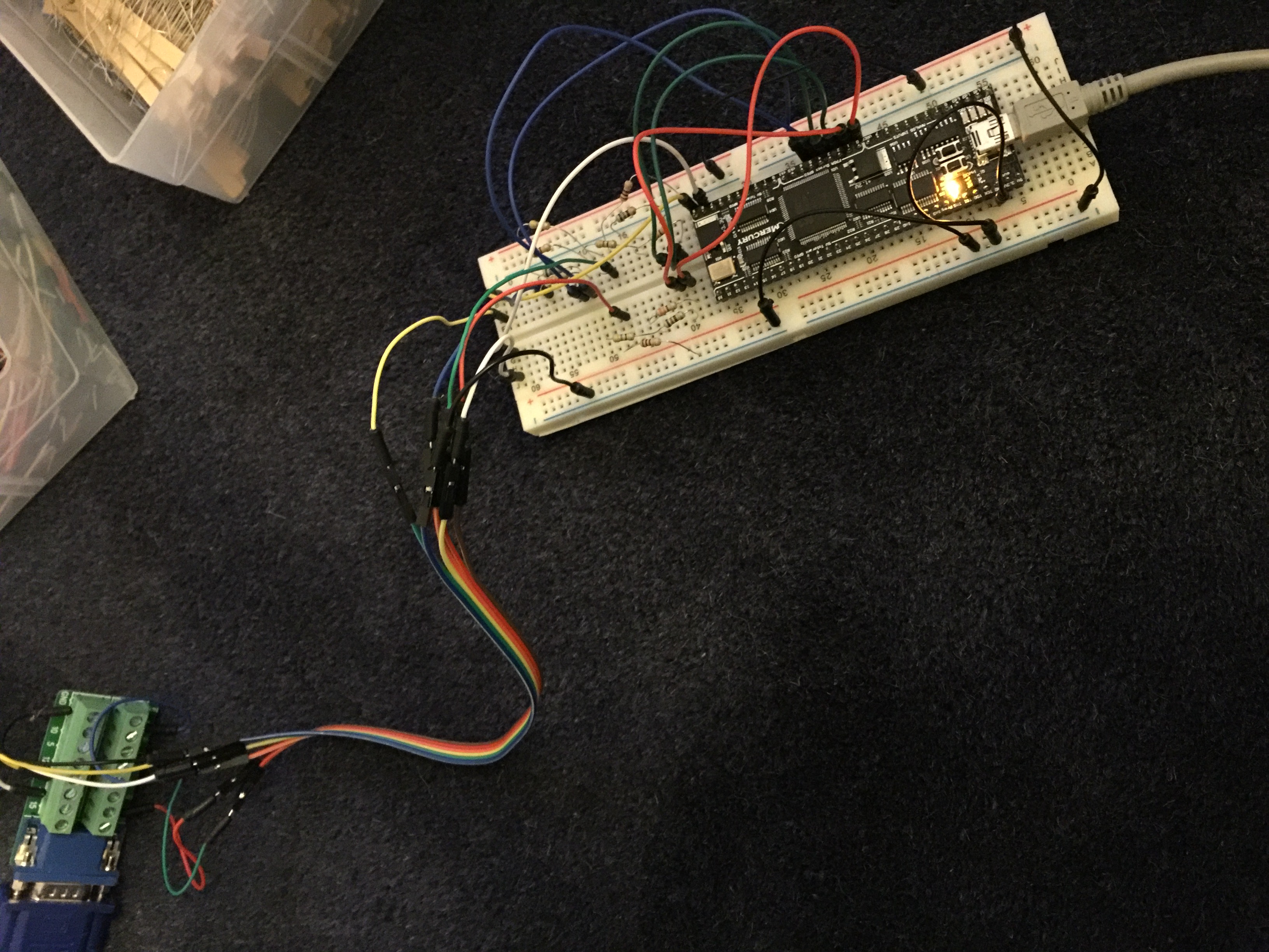

First time getting HSYNC and VSYNC working on the FPGA to get a 640x480 signal recognized by a monitor
File comment: FPGA Start

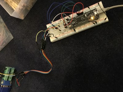

I got 6-bit color working! Displaying the full palette

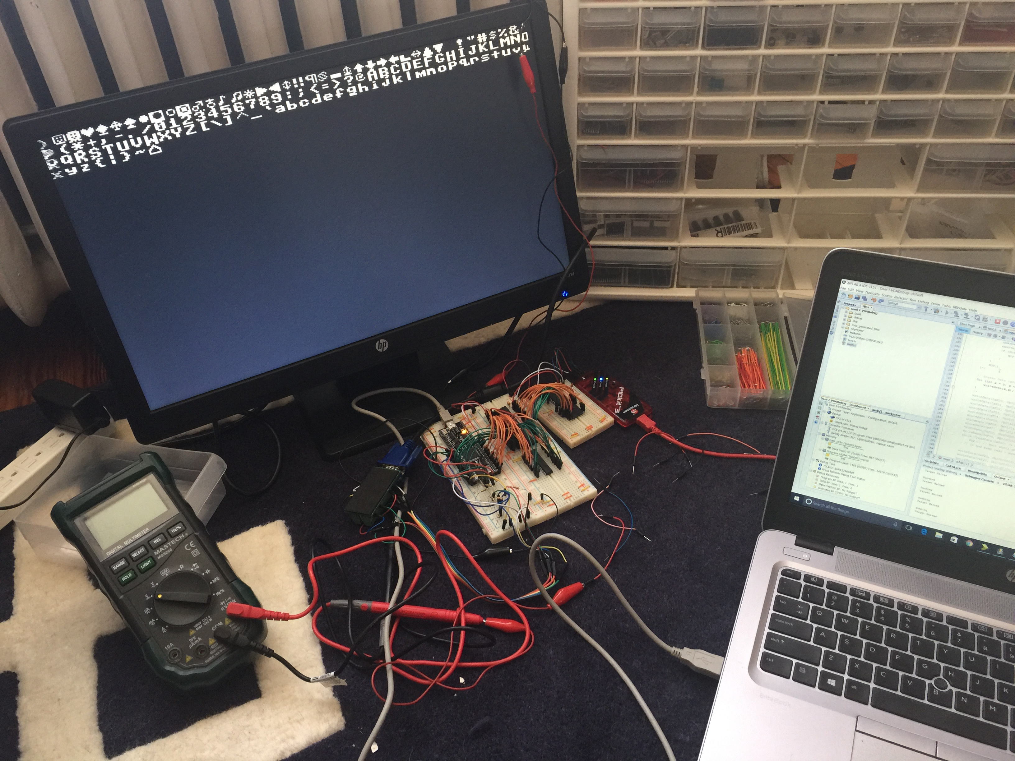

The Dual Port RAM is now interfacing with a VGA debugging device I created, It is accurately showing text on screen

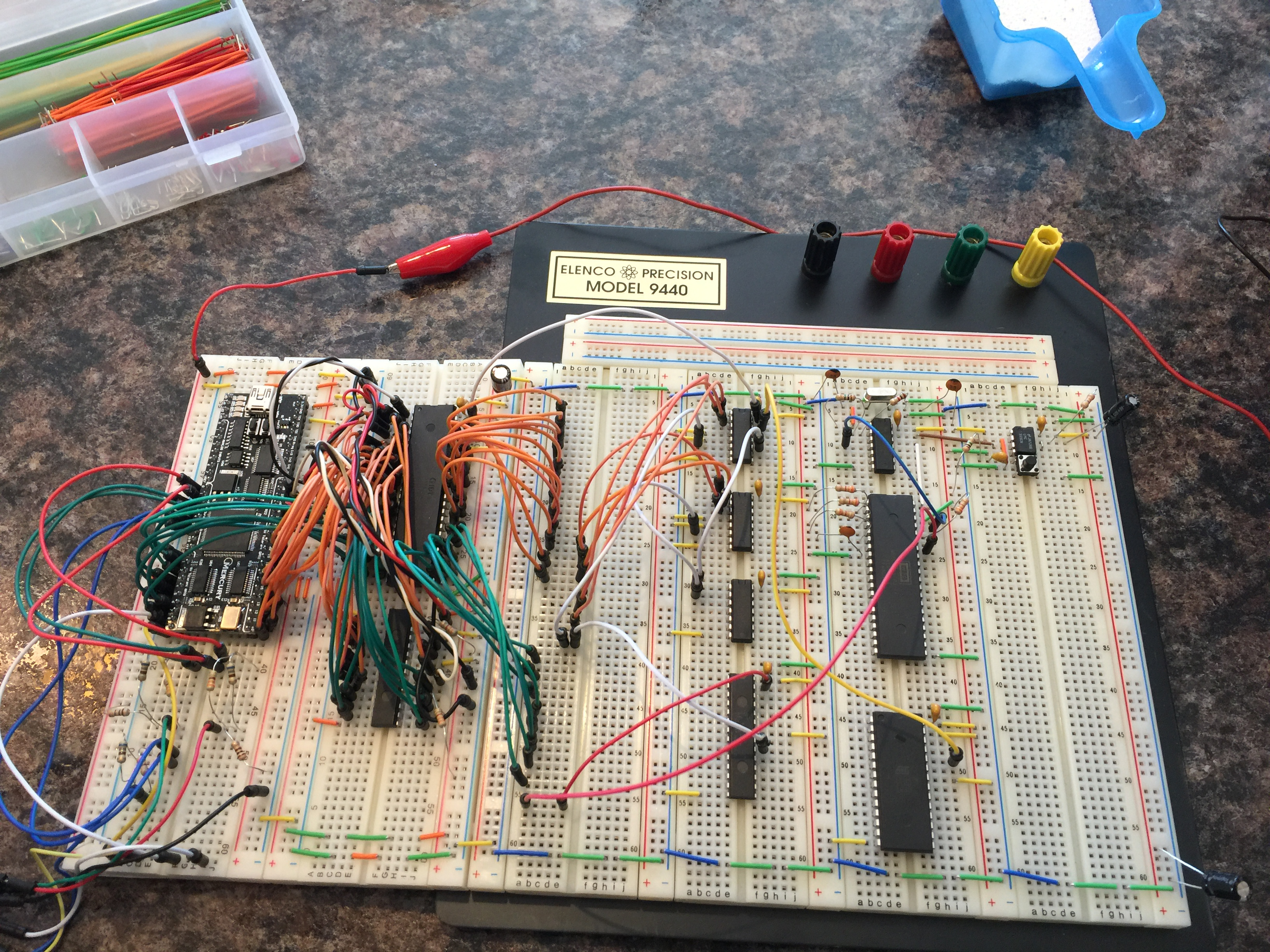

Adding the SRAM, ROM, and the Glue Logic to select everything
I never really realized how important placement is on a bread board until months later

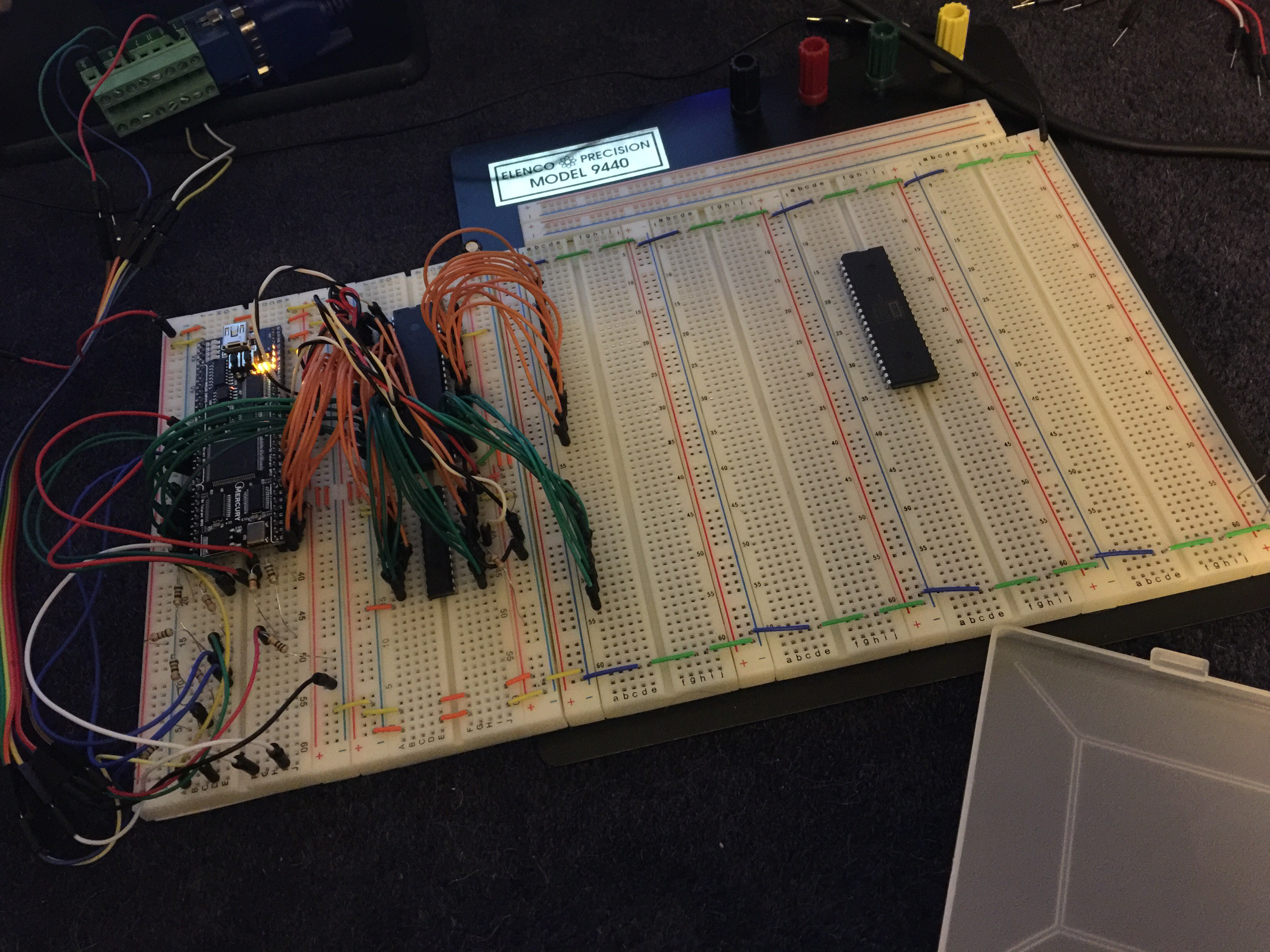

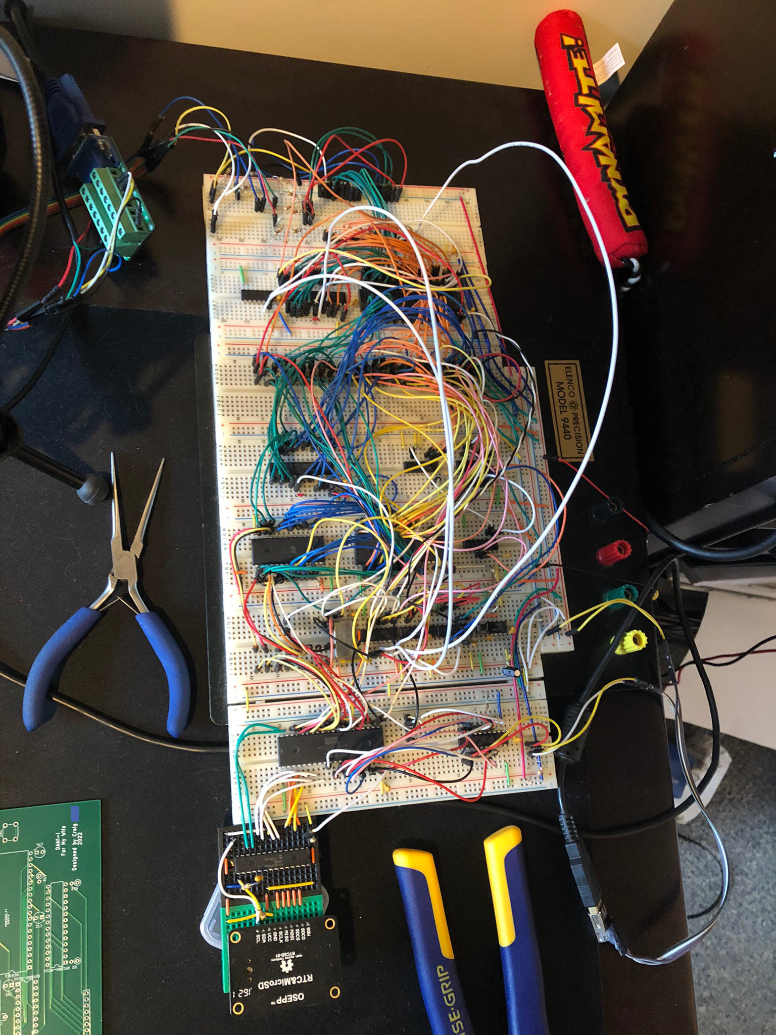

Wiring the busses up
Months later I would realize using this type of wiring was horrible, I wish I cut hookup wire and did it all properly. All part of learning though

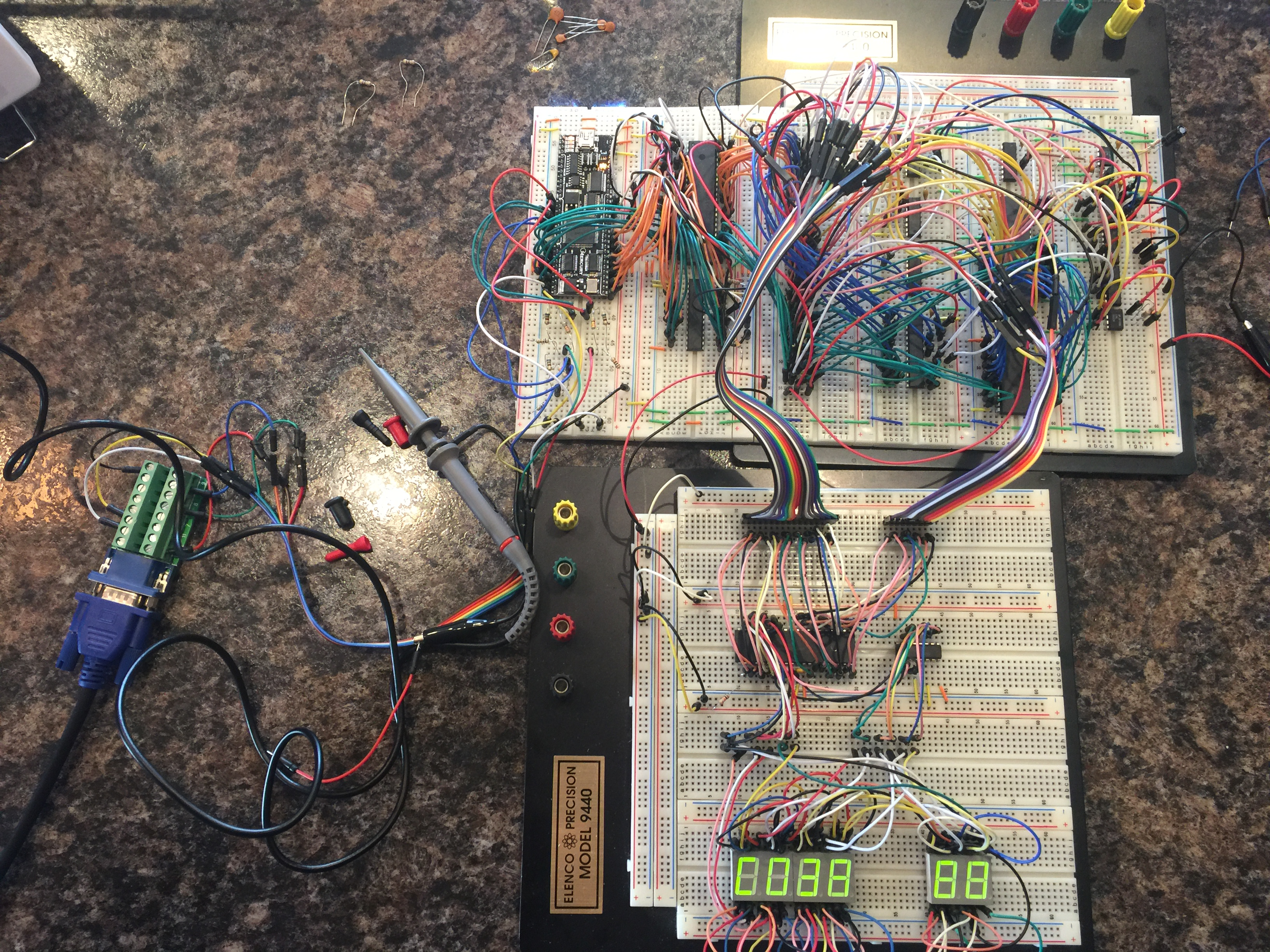

Custom Debugging board
I created this custom debugging board to allow me to step the 65C02 and look at what is on the data bus as well as the address line through the 7 Segment LEDs

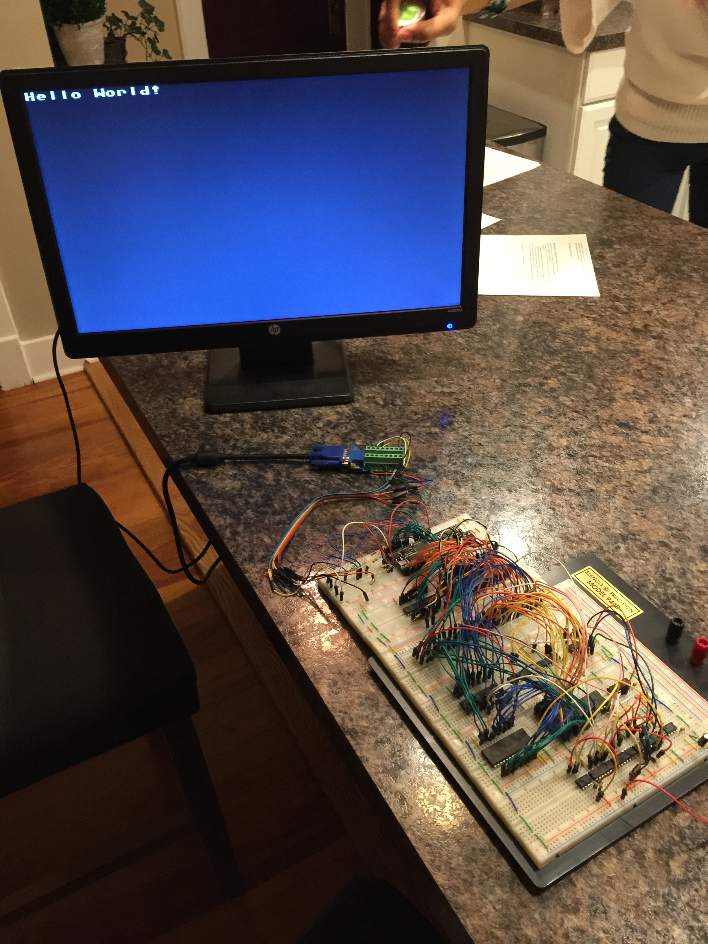

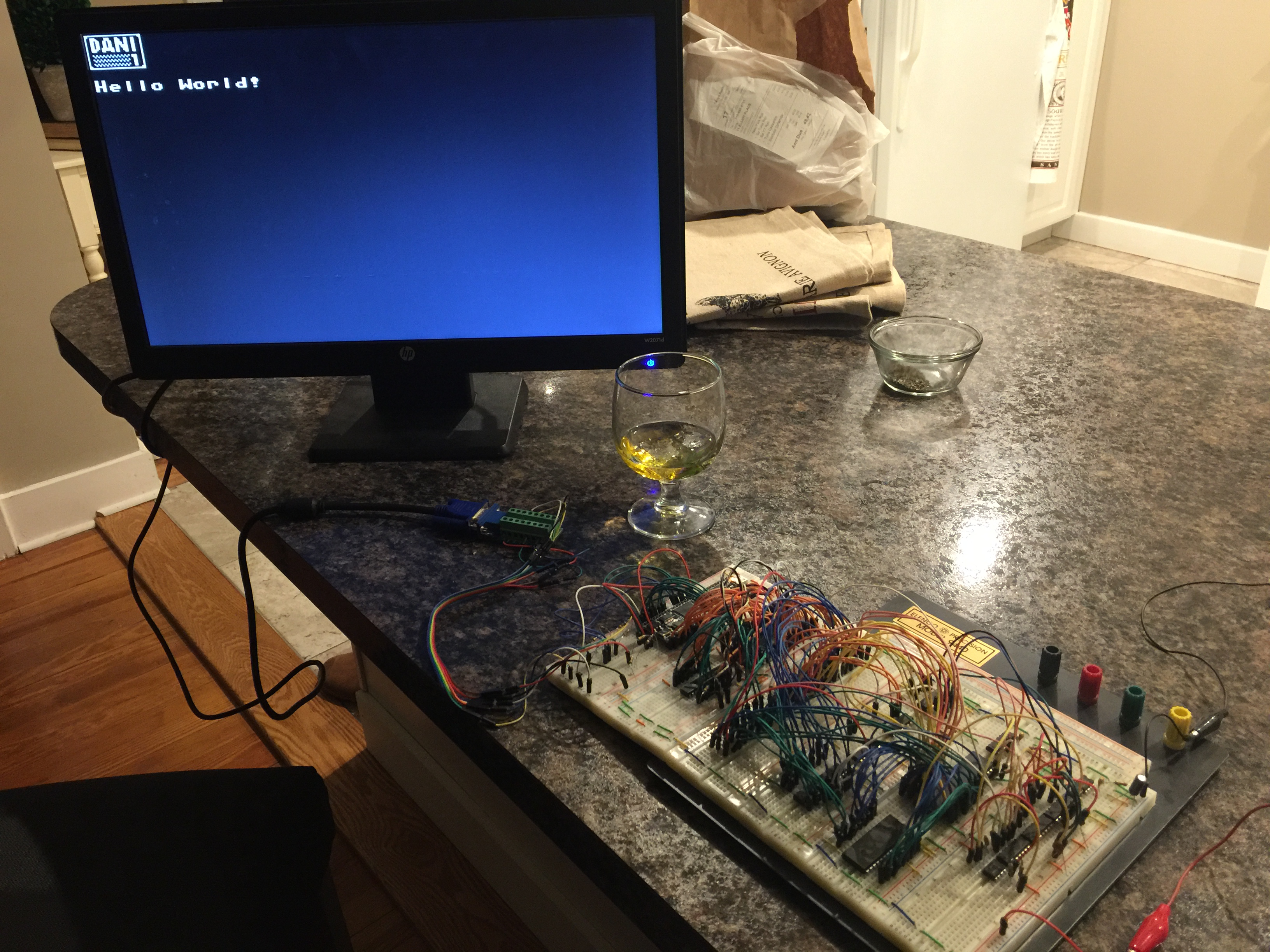

Hello World
Another huge moment for me, getting some 6502 code assembled and have it print Hello World on screen

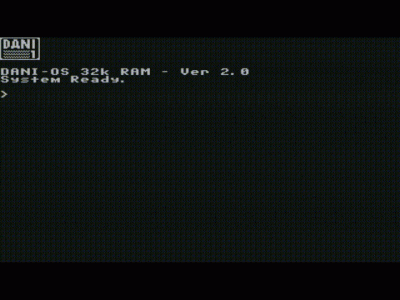

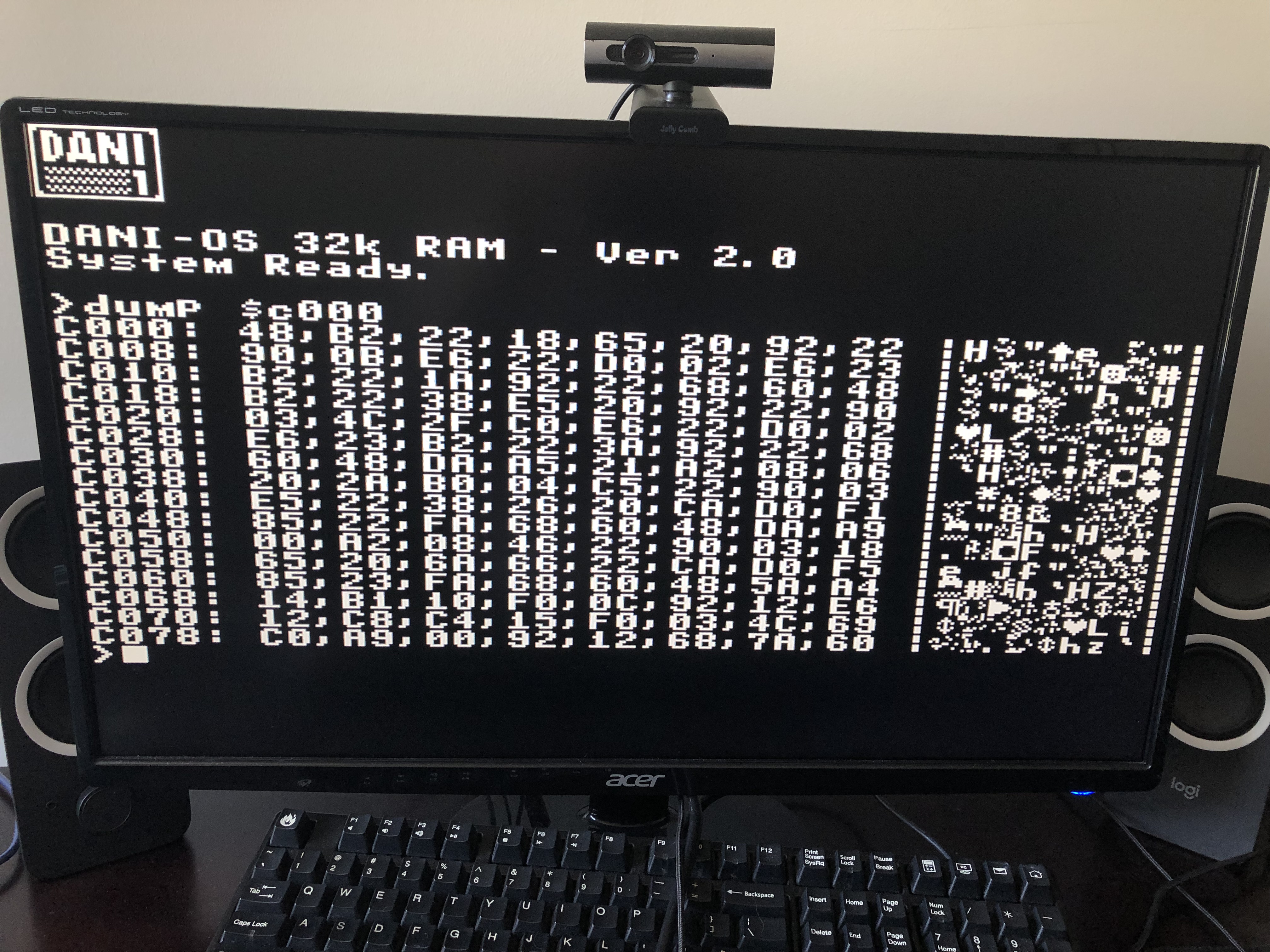

Version 2.0 Of The DANI-I Monitor
Introduced EhBasic, DUMP Command, WRITE commands, JMPR, LOAD, SAVE, DIR - basically everything i needed to load programs off of SDCARD as a binary, or from basic and execute them
File comment: DUMP

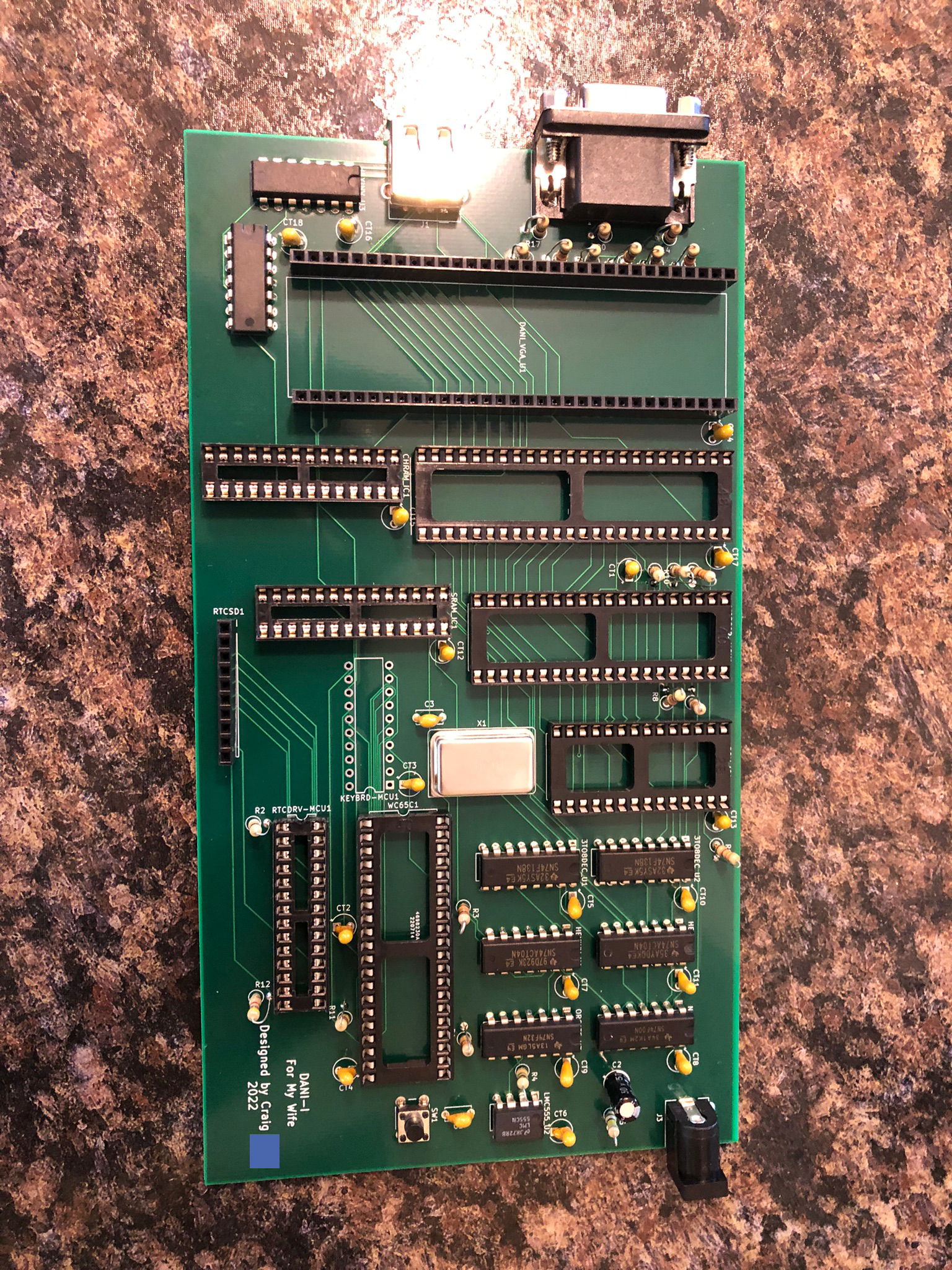

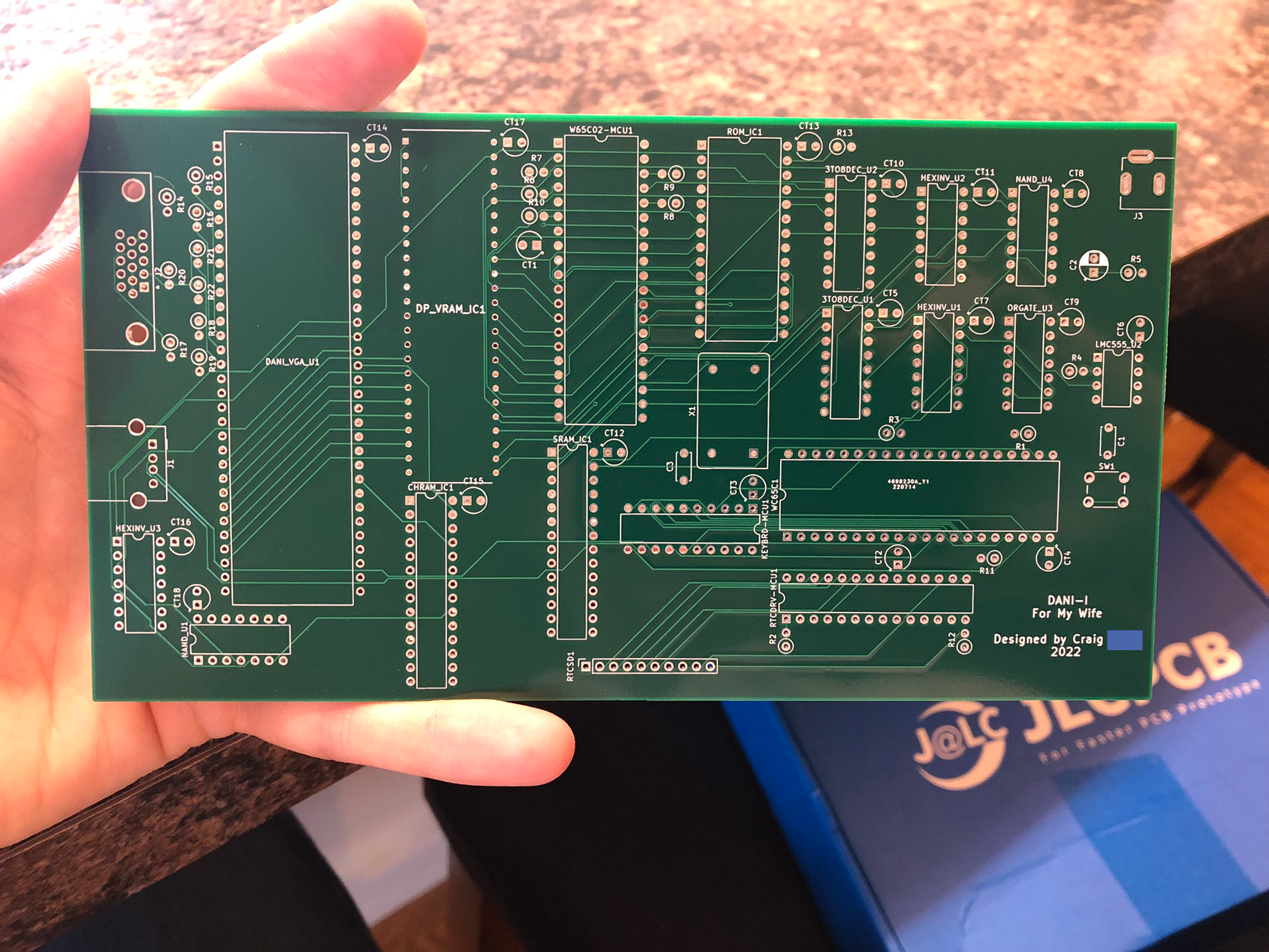

KiCAD & Schematics
Probably the most fulfilling point of this project was when these guys came in, I designed, routed and sent off for PCB's to be printed. I checked the mail every day for them to come in.

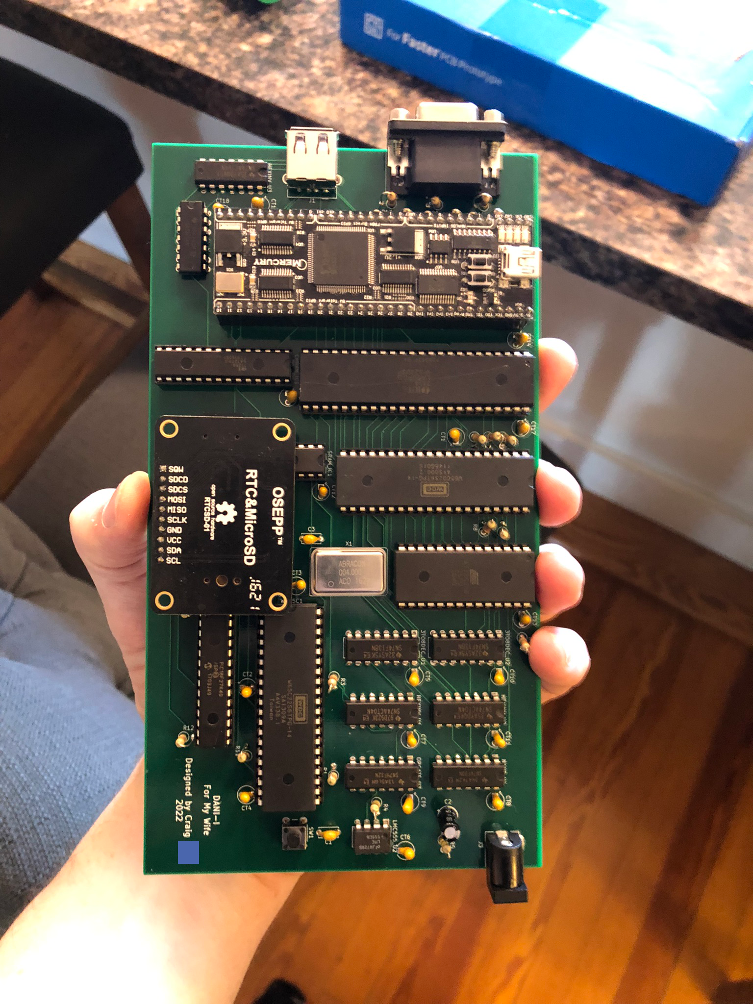

Solderfest 2022

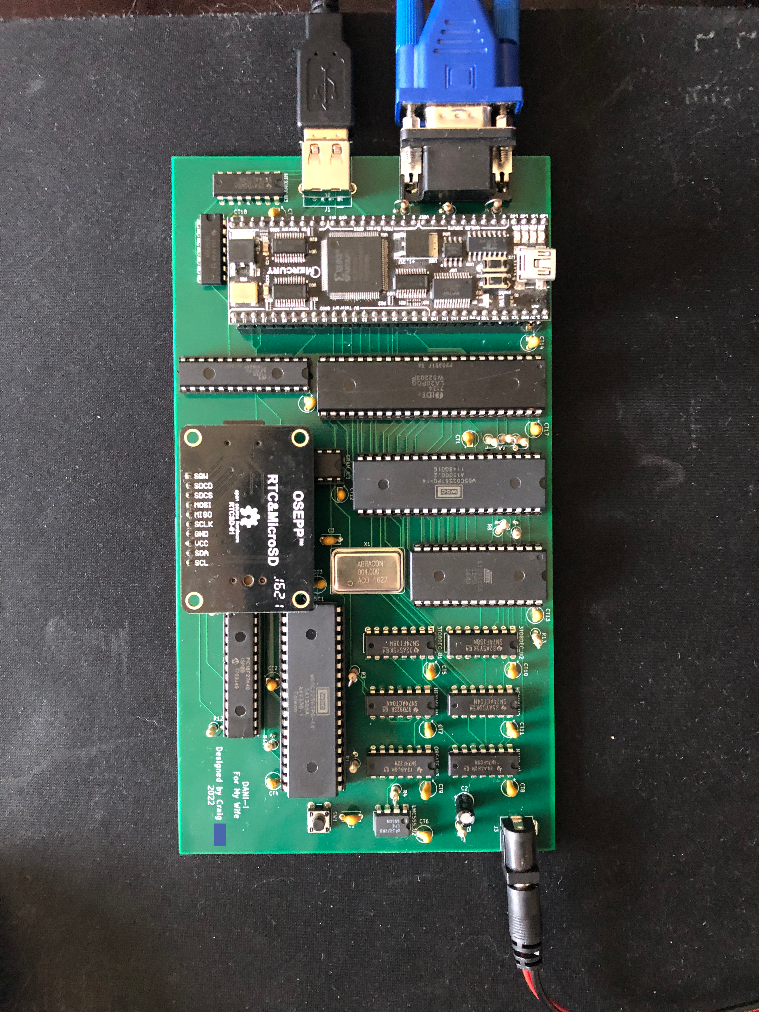

The payoff
Hooking it up and booting up for the first time was insanely nerve wracking for some reason. It felt great to finally see this through tho.
