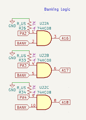

PostPosted: Wed Jun 01, 2022 8:26 pm
Posts: 718
First off, thank you for all of the help Bill. I appreciate it and will be keeping this on my mind while I continue through the next board revision.
So, I've been re-tooling my address decoding logic for the next board revision, and I've been hesitant to post it yet as it is still fairly early in development. But perhaps I could get some helpful thoughts on this new direction:
Attached are some pictures and my new schematics of my re-workings, of the address decoding in particular. The reasoning is that what I am missing from my current board is the ability to read Video RAM. This led me to find a new way to distribute what I'm already using, and with the addition of a single 74HC02, was able to really fine-tune my memory map.
$0000-$01FF = Zero/Stack
$0200-$02FF = I/O (with the VIA at $0200-$020F in particular)
$0300-$3FFF = ~15KB "Low" RAM, unbanked, general purpose
$4000-$FFFF = ~48KB Banked RAM or ROM, 8 banks each (16 total).
$8000-$FFFF = 32K write-only Video RAM, unchanged.
The idea is that I typically would be in say ROM Bank1, with the System Monitor, Assembler/Disassembler and other little programs I made for it. I could switch to another ROM Bank (as I already do for the 16-color bird demo picture) to run games or whatever else I might have. Because ROM is read-only, the Video RAM acts as write-only, so I double the usefulness of that area. But then I could also switch to RAM banks instead, which I figure would be helpful if I were loading a big program from the SD card or something. With the 16K Low RAM available, that is plenty of common ground between switching.
When I have a RAM bank selected, and I write to Video RAM, it would auto-duplicate in the selected RAM Bank, so now I could easily read what's on the screen without having to do weird coding workarounds. On top of that, I implemented CA2 as a "write-enable" for the Video, so it only really writes to the screen when CA2 is high, thus I can decide to use the RAM from $8000-$FFFF for other purposes if I wished.
I calculated that this would give me exactly 400KB of RAM possible with a 512KB RAM chip. Similar for the ROM. That seems pretty hefty!
I guess I'm wondering if you think this setup is useable. Feasible, sure, but is it practical? Could you see something that could change for the better? For example, earlier in my re-tooling, I only had 8KB of Low (Unbanked) RAM. I thought that was probably too small, so I reconfigured it for 16KB instead.
Thoughts? Comments? Anything is welcome.

PostPosted: Thu Jun 02, 2022 3:23 am
Posts: 1117
Since video memory consumes 32K, it is a good idea to overlay multiple banks of memory to make it read/writable. I can see multiple banks containing multiple sprites that you read, move, write back, and fill in the void left behind. It is also a good idea to disable the write to the video memory so the bank can be used as regular program memory. I do think when you are dealing with so many banks of memory, you should think about using 65816. Another observation is your logic decode is getting fairly complex so SPLD like GAL22V10 may be helpful to speed it up and reduce chip count, pc board size, and cost. GAL is inexpensive and can be programmed with your TL866 programmer. WinCUPL is a pain to use but there are a number of proficient users here on 6502.org (however, I refuse to use WinCUPL myself). You can also double your 6502 clock to 6MHz using SPLD.
PostPosted: Mon Jun 06, 2022 3:39 am
Posts: 140
Another alternative for mapping your video memory is to use a small window & a register.
The window could be from $300 to $3ff in CPU space. Currently only 128 bytes is required to map a whole row. Allocating 256 bytes leaves room for future expansion of the row size & is the maximum the 6502's indexed addressing modes can use.
The register controls which row the window maps to.
This actually simplifies the video routines a little. Acol_!.zip contains a sample.
The 65816's built-in bank address handling can simplify dealing with many mapped memory sections.
Whole 64kbyte banks can be assigned to each of the RAM & ROM & video RAM sections, so they're always addressable without adjusting mapping.
Loading or storing a byte of data in another 64k bank can be done in a single instruction using the absolute long addressing modes.
Calling a routine in another bank can be done with the JSL & RTL instructions.

PostPosted: Mon Jun 06, 2022 12:30 pm
Posts: 718
Thank you leepivonka, good suggestions. And thank you for the code demo. Bill, I read your post a long time ago and have been thinking it over. Thank you as well.
It seems both you and Bill are thinking the 65816 is the future here. I do agree, but I am hardly trained and qualified to use that processor, as of yet. I will be considering it though, thank you.
As for the $0300-$03FF range for video, I was actually thinking of that very thing last night. It would free up a lot of room for general purpose RAM for sure. Thing is, it would be harder to read from video memory that way, as far as I can tell. I had at one time set up a bi-directional bus to the video RAM, but in the end I dropped it because the logic was getting very cumbersome. Still, I will be considering that. Thank you.
Thank you both!
