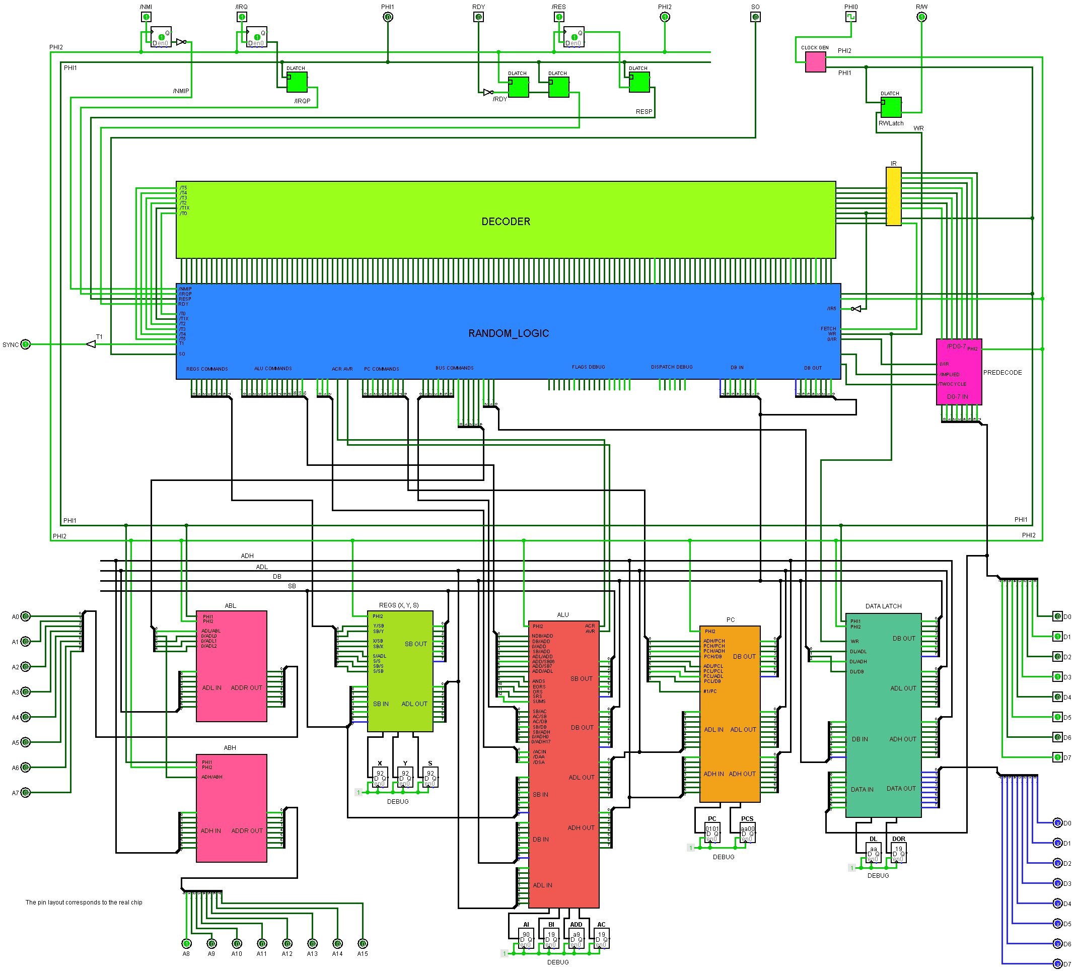

Hi, we have completed the 6502 circuit design in Logisim.
https://github.com/emu-russia/breaks/tr ... 02_logisim
There are two options there: for classic Logisim 2.7.1 (6502.circ) and for Logisim Evolution 3.7.2 (6502_Evo.circ).
The schematics kind of works and all main processor parts are implemented, but it obviously still needs to be debugged.
Probably, it will be interesting for someone and we will finish it together :)

We are making some progress.
The 6502 in Logisim successfully passes the BRK sequence and executes the first few instructions. Some kind of problem with the JSR. We are working on it.
Next to it is visual6502.hex in Logisim format, which can be loaded into RAM.
Also there is a script bin2hex.py, which converts binary files into Logisim format.

All problems have been eliminated. The 6502 now works in Logisim as well.

Nothing new :) Again there were problems with the bi-directional transistors used for SB/DB and SB/ADH commands. I had to do a little hack for the logisim, which does not support bidirectional connections, to account for the "dirty" buses.

@org, my students downloaded the Logisim circuit currently available at github, and they're getting errors when they run the Logisim circuit. The 6502 circuit has wires that are "red" and in error (SB OUT, DB OUT, etc.). Has this been fixed?

Yes, the 6502.circ works well.
Maybe they downloaded the "Evo" version (for Logisim Evolution), which may still contain bugs since it hasn't been updated in a while.

If I'm not mistaken, the file named 6502.circ currently at https://github.com/emu-russia/breaks/tr ... 02_logisim, when opened in Logisim, looks like below.
File comment: This seems to be an older version of the circuit.

I get it. You are looking at the state after the very first half cycle (PHI1), during which 6502's behavior is Undefined.
This is due to the fact that the command latches for the lower part are only updated during PHI2, so on the first half-cycle of PHI1 the lower part "goes crazy", as almost all latches issue down all commands at once.
It is enough to perform one more half-cycle and the processor stabilizes.
