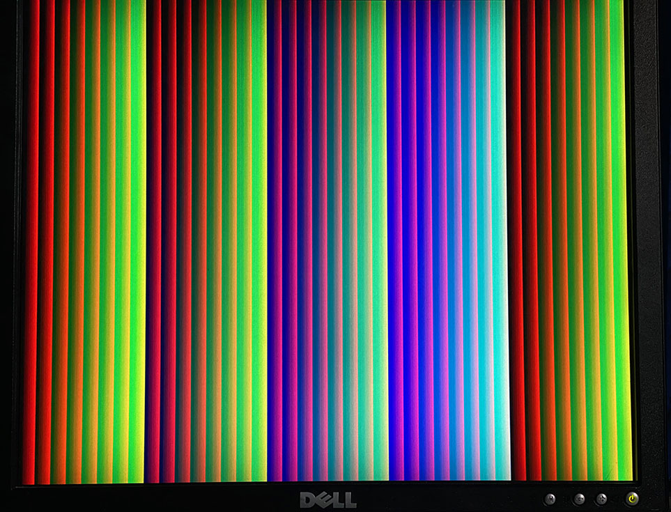

I had no idea to expect (and really no expectations that I would be able to do anything useful with a $2 chip), but I was surprised to find out how much capability can be squeezed out of these devices. In particular, I was surprised by how much more quickly one can prototype a circuit, especially using Verilog. Once you get past the fact that it looks like C but doesn't quite behave like it, it's remarkably easy to build what circuits that would be pretty complex (at least for me) implemented using only discrete logic.
In any case, I started with blinking a LED, and somehow ended up implementing the VGA controller that I've always wanted for my SBC :-). Here's a final list of features:
  • Completely asynchronous operation; you should be able to just bitbang data into the registers at the typical speeds supported by most hobbyist projects.
  • 320x240 resolution at 8BPP (RRRGGGBB), rendered as a 640x480 @ 60Hz standard VGA signal.
  • 640x240 resolution at 4BPP “high res” mode using a CGA-like palette, capable of 80x30 text (though you will have to implement the text rendering in software).
  • Hardware accelerated vertical scrolling (handy for text displays).
  • Toggable self-incrementing X coordinate for faster data transfers.
  • Active-low interrupt when entering the non-visible area at the bottom of the screen.
I uploaded a demo of it running to YouTube (this is currently powered by a PIC18 running at 64MHz, because I didn't have a working 6502-based SBC handy), and have attached a copy of the schematic below (though, to be honest, it's not that interesting… all you really need is the Max II, 128kiB of RAM, and a handful of passives). Here are some photos from the output, which is rock-solid and flicker-free—and looks much better in person:

Time for a quick update: I finally got the PCB for my reference design, and it looks pretty spiffy:
Soldering the CPLD to the board was quite the adventure… the first attempt ended up releasing a bunch of magic smoke, but the second time around I took care to avoid shorts and it worked right away. I was silly enough to place the decoupling caps on the other side of the board—a mistake that I'm not going to make again, because they're a pain. Also, I think that I should make a version of the board that acts as a shield that connects to the MAX II development board, which should eliminate the need to solder SMDs altogether.
I was pretty surprised to find out that the circuit worked right away… it only needed a bodge wire because I had forgotten to force the RAM's chip select line low. It took a little doing to interface it with a version of my 6502 SBC running at 3.3V, but only because I had forgotten to qualify the chip select line with PHI2, much like you have to do when interfacing to RAM.
Once I figured that out, it worked like a charm with the 6502 running all the way up to 13MHz (at which point my SBC ceases to work for reasons that I have not yet investigated—I suspect that the video interface can handle faster clock speeds). Here it is connected with some temporary wires while I await angled pin headers from China:

A final update on this project: I have added support for reading the video RAM and for blanking interval detection/interrupt. This makes the interface with the host computer bidirectional and allows for smooth animation.
I still plan to create an advanced version with a customizable palette and support for sprites, but I'm going to call this version of the project complete for now—if for no other reason that I have used all but one of the available macrocells in the CPLD :-)
The interface works really well, incidentally. I was able to test it with my SBC running all the way to 20MHz and it's nice, responsive, and completely glitch-free (though, in all fairness, my code isn't yet fully optimized).
Just for fun, here are a couple shots of the card plugged into the SBC, and some 80-column text output from the SBC to my VGA monitor, using Gordon's most excellent font (thanks again, Gordon!).
67485268540__9B2FAE27-9573-49CC-BD70-4969934E67CC.jpeg [ 88.26 KiB | Viewed 39925 times ]
