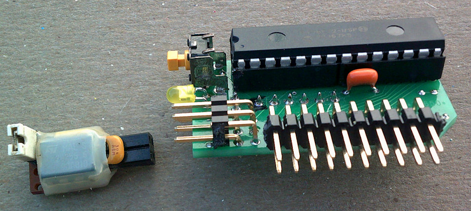

I just tentatively finished a project that does a similar thing for a ROMless '816 system.  It hijacks the motherboard's Φ2 source (also disabling RAM's output), and its reset, then as it lets the processor out of reset the first time, it watches the VP\ output and feeds the data lines an artificial reset vector, then watches the VDA and VPA lines for the first instruction fetch, and then starts feeding LDA#...STA instructions to put the bootloader code into RAM.  You can have multiple stretches of RAM, held as separate records in the I2C-6 EEPROM module plugged into the bootloader board.  [Edit, 7/28/22:  The I2C-6 EEPROM module is on the front page of my site now, and there's a link to the data sheet there.]  Each record has a record type field, a starting address, a number of bytes in the payload, a link to the next record, and the program or data itself to load into RAM.  When it has finished the last record, it puts the '816 back in reset, releases the clock source it had hijacked, puts its own data lines in hi-Z, and releases the RST\ line so the '816 can now boot up with the vectors and bootloader you just put in RAM.  It uses a PIC16 microcontroller.  I plan to make it available to others.  I just have to figure out some details of how to do that; for example, many users won't initially have any way to put the data in the serial EEPROM.
PostPosted: Sun Apr 17, 2022 4:38 am
Posts: 586
Which PIC are you using? How much EEPROM/Flash storage do you need? If it's a relatively modest amount, you might consider using a 20-pin 18F16Q40 (64K Flash) or a 28-pin 18F27Q43 (128K Flash) and ditch the external serial EEPROM.
It's a 16F72, partly because I have a lot of them from earlier projects.  I'm sure many other variations with 28 pins could drop into the same spot.  Part of the idea was to be able to quickly swap out the EEPROM if desired.  The 16F72 is not the cheapest around, partly because it has the A/D converter which I'm not using for this; but I tentatively plan to provide 24C256 I2C-6 EEPROM modules too, 32KB, and I can get the EEPROMs really cheap in quantity, and I use them for other things too.  [Edit, 7/28/22: The I2C-6 EEPROM module is on the front page of my site now, and there's a link to the data sheet there.]  This particular project might never use even half a KB.
How much EEPROM you need depends on how much you want to load.  Early bootload routines will probably be pretty simple, partly because of the chicken-and-egg situation regarding how to develop boot-up code for a computer that has never run yet.  Each record in the EEPROM has 9 bytes of overhead, and then there's the payload.  One of the bytes tells what kind of record it is.  You could have a record that's just text, to use as a volume label or explain something about the version.  The bootloader will just ignore that and go on to the next record.  The main kind of record is code to load in.  Let's say you wanted to load $E4 (228) bytes starting at address $300, and then the reset and IRQ vectors at $FFFC to $FFFF.  (228 bytes' length is an arbitrary guess, hopefully enough to load in the real OS.  It could be any quantity you want though, as long as it fits in the 32KB EEPROM.)  So you have 228+9=237 bytes for one record, and then 4+9=13 bytes for the record that gives these vectors.  There's no need to fill in all that space between $3E3 and $FFFC.  Another kind of record, which I have not implemented yet, is for other code for the '816 to execute in the process, like to put something in the display.  The bootloader won't be able to read it though, only write.
