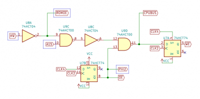

PostPosted: Wed Mar 02, 2022 4:07 pm
Posts: 704
I've been looking at George's schematics much more closely now. And I truly am confused about one little part!
https://github.com/gfoot/simplevga6502
On the '74 flip flops, George is using /CLK2 as the clock. That means, in my mind, that a falling edge is what triggers the flip flop.
But when I lay this out in Excel, I see that it should rather be CLK2, not /CLK2. That is a rising edge, instead of falling edge. I must be terribly confused!
If using the rising edge of CLK2, we get the flip flop holding CLK4 or /CPUBUS in the middle of CLK4. Basically shifting the signal by a time of CLK2.
But if we have the falling edge of CLK2, we get the flip flop holding simply the inverse of CLK4 or /CPUBUS, which is certainly not what George in intending.
I have looked at the datasheet for the '74 and I must be missing something small here. I know what George is wanting to do, but I don't see how the '74 does that in this particular configuration.
Thoughts? Assistance?
Thanks everyone.
Chad

PostPosted: Wed Mar 02, 2022 6:14 pm
Posts: 741
Yes, I meant to mention it in the PM just now - that configuration is wrong and I'm not sure why it worked! I was very confused when I discovered that, and double-checked it between the schematic and the circuit because it shouldn't really work - but the schematic matches the circuit.
What I'm actually running at the moment though is a modified version, consolidating those two flip-flops and most of the logic gates into a simple PLD. I haven't had time to really write up the details of that yet though. :(

Well, here I am, giving it another go! I've had a fair amount of time at work to play around with this (no time at the house though!), so here we go:
Attached is my timing Excel spreadsheet, as well as the new schematic. On the schematic itself there is a 'graphical' timing display.
I borrowed heavily from George's design ideas. Instead of using the 74HC74's though, I decided to just use NAND's and NOT's, but the timing is the same.
I also slowed PHI2 down to 3.14 MHz, giving me plenty of time to grab data from the RAM at the tail end of a high clock phase without overclocking. The trade off is that I had to grab all 8 bits of data for color to make it to the next latch! So I moved the signals over to a FlashROM instead, and because PHI2 is slow enough to access it, I was able to remove many logic chips and replace it with a single programmable one!
Writing to the Video RAM is back to the 'Apple II' style, just as George does. PHI2 high is for the 6502, PHI2 low is for VGA.
The logic chip count is FAR less now, and I am able to manipulate the timing using an EEPROM programmer. I still have room to make other timing signals, so I might see about reducing timing logic even further, who knows!
Thank you George, and thank you everyone else. I'm going to print this thing very soon, because I'm tried of manipulating schematics and want to get to coding!
Chad
EDIT: I'm removing those schematics. The timing was *still* off. I won't post any more until I have it printed and working. Thanks!
