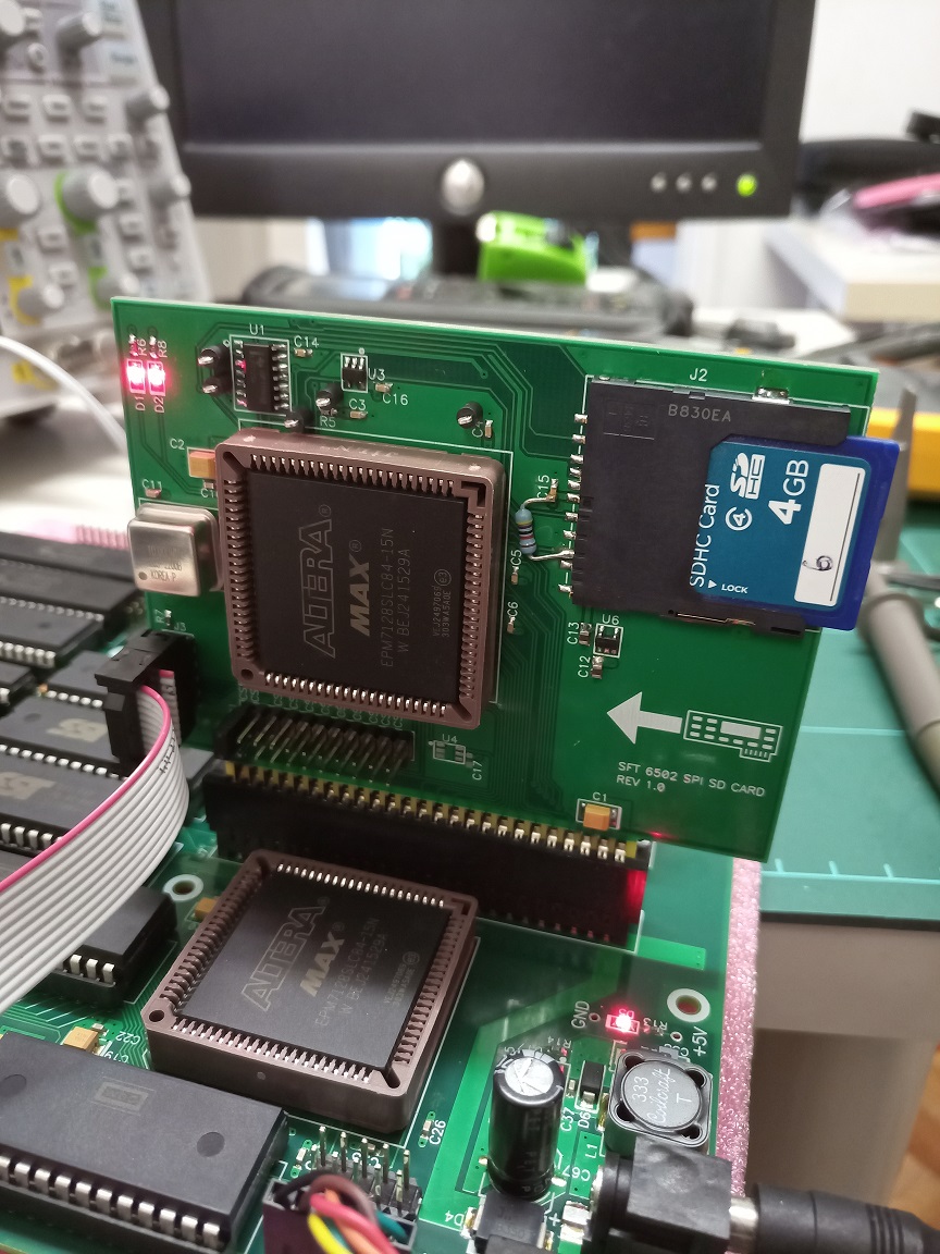

CPLD's combined with the 6502 are definitely the way to go. I'm using the (obsolete) MAX7000 series, but they are compatible with the Microchip ATF15xx series which are still available. I use Quartus II 13.0.1 for schematics, compiling and programming of the MAX 7000 series, but I found the latest version of Quartus II better for simulation. Simulate small chunks of your design and then combine them in a final schematic for testing on hardware.
I've started work on a SPI to SD card interface. This is my progress so far.
The current hardware supports
1. MSB first
2. selectable clock frequency
3. polling for TX complete
4. SPI MODE 0
There is still plenty of space in the CPLD for more features.
I have included some information
1. the plug-in card with the CPLD and SD card
2. the CPLD schematic
3. Logic analyzer trace with SD card CMD0 command / response
Here is some C code that I have been testing with,

Reading and writing is as fast as the 6502 can access memory.
I need to increase the CPLD clock. It is currently 10MHz, but I lost speed due to to the arrangement of logic to drive the SPI clock and MOSI shift register.
If anybody has any input or want more information please feel free to ask.

Hi again,
I've been working my way through SD card initialization.
I found this tutorial from RJH coding very useful. (http://www.rjhcoding.com/index.php)
Also this post https://electronics.stackexchange.com/questions/303745/sd-card-initialization-problem-cmd8-wrong-response
referring to a incorrect response to CMD8 which is what I ran into.
The post recommends adding additional dummy writes.
I added a SD_Card_Dummy_Clock function that generates 2 SPI writes resulting in 16 additional clock pulses before the command starts.

The tutorial shows the interpretation of SD card command responses which I have copied.
This is where I am now.
SD CARD INIT
RETURN 0x01
CMD0
In Idle State
CMD8
In Idle State
Command Version: 0
Voltage Accepted: 2.7-3.6V
Echo: 0
CMD55
In Idle State
ACMD41
In Idle State
CMD55
In Idle State
ACMD41
Card Ready
CMD58
Card Ready
Card Power Up Status: READY
CCS Status: 1
VDD Window: 2.7-2.8,
2.8-2.9,
2.9-3.0,
3.0-3.1,
3.1-3.2,
3.2-3.3,
3.3-3.4,
3.4-3.5,
3.5-3.6
The card is ready for use.
The CPLD SPI interface is holding up so far.
Regards
Andre
