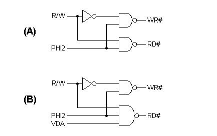

For purposes of discussion, let's consider (A) and (B), below. (A) is a widely used snippet familiar to pretty well everyone, and (B) is somewhat similar to the excerpt Adrien posted.
In some cases, failure to qualify addresses with VDA may result in a location being touched during a so-called dead cycle. If that location is a chip register, it being touched may cause the device to behave in an undefined way.
Yes, exactly. Users of the original (ie, NMOS) 6502 occasionally get bitten by this, although it is fairly rare. The 6502 has no VDA output. Luckily, 6502 folk are able to solve the problem by being careful in regard to certain programming practices, such as indexed addressing of an I/O device and using Read-Modify-Write instructions on an I/O device.
The same solution is available to '816 users, and therefore it's not "strictly necessary" to use VDA. :!: But using VDA does relieve you of concern about "breaking the rules," and some of us may value that advantage quite a lot. YMMV.
Something worth noting: it's fairly common for I/O devices to include registers (such as the 6522's Interrupt Flag Register) which'll be adversely affected by the spurious read that occurs during a "dead" cycle. (Dead cycles are always reads, never writes.) But as a rule, memory devices simply don't care about a spurious read -- it won't cause the least bit of trouble. The only exceptions would involve wonky stuff like the "knock sequence" used to unlock certain EEPROMs and/or Flash memory chips. (And besides, the potential problem can be sidestepped by following the rules.)
Since only the wonkiest memory chips may benefit from protection against dead cycles, we can usually satisfy ourselves by only protecting I/O... and that's what (B) does. In other words, use RD# and WR# from (B) to drive your I/O devices.
Of course, I/O chips from the 65xx family don't have RD# and WR# inputs. But most (all?) of them have two Chip Select inputs, one active-high and one active-low. If the active-high CS is otherwise unused then the 65xx I/O device(s) in your design can be protected very easily indeed. Simply connect the active-high CS to VDA. :)
ps- there's a carefully researched list of dead-cycle behaviors here. This includes the 65C02, which has its own unique remedy for the dead cycle issue.

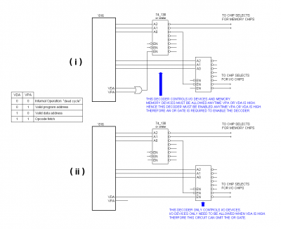

A footnote. Some '816 designs use an OR gate so that both VDA and VPA play a role in dead cycle protection. But there are pros and cons, and their relative weight will, as always, depend on prevailing circumstances and priorities. Most often the balance will favor ignoring VPA.
If you want your design to include dead cycle protection you can, as shown in the preceding post, inject a signal into the logic that generates RD# and WR#. In this post I'll show how a signal can be injected into the address decode logic instead. Circuits (i) and (ii) inject the signal at two different points. And circuit (ii) allows VPA to be ignored.
Obviously circuit (ii) is faster and requires less logic. That said, I suppose situations may exist in which (i) would be a "win." Maybe your level-two decoder doesn't have an extra Enable input that's available, and you're unwilling to rework the circuit. Or maybe you feel memory, too, ought to be protected (although that's virtually always unnecessary, as noted in the previous post). In that case the OR gate and its speed hit may be a price worth paying.
But clearly, VDA alone can be sufficient to 100% protect I/O devices from the spurious read associated with a dead cycle. To anyone contemplating a new design, I suggest you begin with the default assumption that VPA will have no role. Beginning with the opposite assumption can, if you're not careful, lock you into a compromise whose pros and cons aren't the best fit for your needs.
(And a reminder: 65xx I/O devices whose active-high CS is unused can be protected simply by connecting that CS to VDA.)

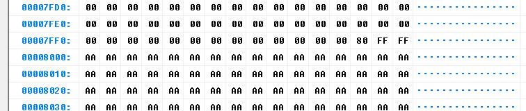

I updated my assembly to that in the attached image. I filled the remainder of the flash ROM with 'AA' so I could see if it was pulling something in the remainder of the ROM (versus 'FF'). I can see in the debug output that it's pulling 'AAAA' from the ROM for the reset instead of '8000', so now I need to track that down. I have verified continuity for all address lines to the flash ROM. If I'm getting 'AA', it must be pulling it from an address greater than $FFFF. My first thought is that A16-18 must be coming through with a bit set to '1' for it to get to the 'AA' values. (I'm just thinking out loud at this point and need to noodle more on this.) Or my references to addressing are wrong somewhere. More to come...
File comment: Debug output
File comment: Reset vector in ROM
File comment: Source assembly

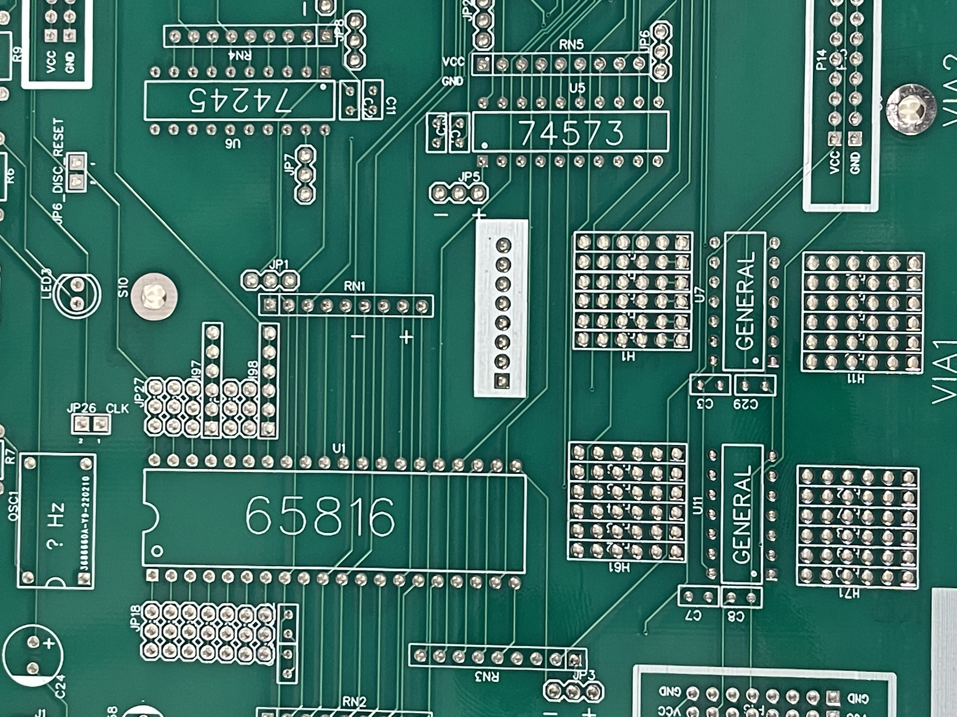

65816 definitely needs reset vector at $FFFC and $FFFD, so the ".org $fffc" and ".word reset" are required.
Looking at the image of your pc board, I see on the top side there is a trace running very close to pin 9,10,11,12,13,14 of a 14-pin DIP next to 74AHC74. Can't read the part number but is it 74HC00, the one you are having problem with? Trace is actually shorted to the pins on the image, but is that just an illusion?
Hi, Bill. I'm trying to determine where you're looking. Any chance you could post a pic with it circled? My 74AHC74 is on the small clock board stuck to the top of the main PCB.
PostPosted: Mon Feb 28, 2022 2:19 am
Posts: 1116
It is the 14 DIP above VIA1 and below 65816 (not directly below, but low right of 65816). The image I'm looking at is marked "TOP" of this post:
viewtopic.php?f=12&t=7032&start=15#p91004
PostPosted: Mon Feb 28, 2022 2:41 am
Joined: Sat Feb 19, 2022 2:18 am
Posts: 47
I think I see what you're looking at. Yes, it's just an illusion. I quickly checked the board. I am not using that IC location at the moment, but it was good to check. Those general IC locations only have VCC and GND connected (with pin headers for actual connection to the rest of the circuit).
I missed Adrien's question earlier about ERC. Yes, this was checked with EasyEDA.
