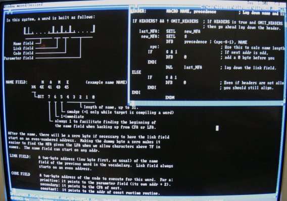

IamRob wrote:
I thought of that too. Using a full screen of 80 cols by 24 lines.
I have the Trident 8900 video chip set on a video card on my DOS machine where I do my software development for the workbench, so I have 132 columns, and I usually choose 43 lines, although if I don't mind them being squished together with less space between them, I can go for 50 or 60 lines. In the picture below, I kept things to 80 columns for someone else; but you can see how much more space the 132 affords. When I write stuff that will be compiled by the workbench computer where I only allotted 128 bytes for TIB on my '02 Forth, I just don't use the last few places on the line. (In my '816 Forth, I made TIB $88, or 136d.) MultiEdit, BTW, lets me have dozens of files open at once, tiled and windowed any number of ways.

At one time I had a Videx Ultraterm which offered 128x32 or 160x24, but no-one has implemented support for those screen sizes in any emulators yet. But yeah, I am envious of all that screen real-estate you have access to.
