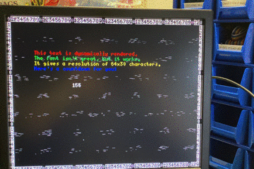

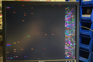

Hey folks—
I've managed to redesign the interface so that it provides 320x240 resolution natively, and fix all the bugs that I had.
In the end, this took a relatively minor number of changes to the circuit, without increasing the chip count. All I did was to use a separate set of counters for the X and Y coordinates, which requires a larger signal EEPROM but about the same amount of RAM as before. I also interfaced the PIC directly with the RAM's data bus, which makes read/write activity possible.
Switching to '161 counters fixed the distortion at the top of the frame (thanks, George, for the suggestion!), and the spurious pixels turned out to be a problem with power, rather than timing. I added a 4.7µF cap near the SRAM chip, and they went away (they still occasionally occur when the PIC programmer is connected to the breadboard, but not when the circuit is freestanding).
Here's the new diagram (I've attached both colour and b/w versions below):
I also had a chance to add a couple more primitives to the graphics library, as well as the ability to draw text using a (pretty terrible-looking) 5x8 bitmap font.
Here's the obligatory demo (which definitely looks better on video:
I think this is good enough for a PCB so that I can start working out an interface with my SBC. There are still some substantial optimizations that I can make to the pixel rendering algorithm; if I run the demo without syncing the PIC with the blanking interval, you can see just how much faster it can run, though at the cost of some artifacts (other than the sync, this is the same exact code as above):
In any case, I've also become convinced that, at some point or other, I will need to add a text-only mode, because the graphics are cool, but this would be unusable with any kind of textual data.
Cheers!
—Marco

PostPosted: Fri Feb 04, 2022 8:06 am
Posts: 741
Very nice. In the setup where you don't wait for the blanking, how do you instead synchronise the pic, and the OE signals of the address latches? The artifacts on the screen shouldn't appear if you time the writes to occur when CX1 is low - this is how my circuits all work, as the 6502's clock is linked to the equivalent of CX1.
