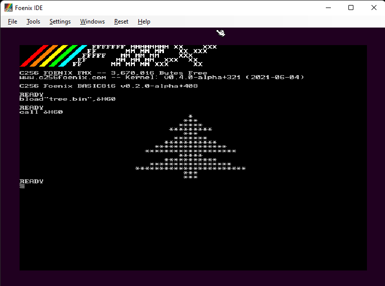

I'm too late but my attempt comes in at 66 bytes on the C256 Foenix's 65816 using my own assembler.
cpu '65816'
org $60
const width=72
const treepattern=array(1,3,5,9,3,7,11,15,19,5,11,17,23,3,3)
PUTC             = $001018
main:
   phk
   plb
   sep #$30
   ldy #sizeof(treepattern)-1
      lda #' '
      ldx treedata,y,b
      jsr draw
      lda #'*'
      ldx tree,y,b
      jsr draw
      dey
      bpl -
   rtl
draw:
   pha
   jsl PUTC
   pla
   dex
   bne draw
   rts
var space1,space2=0
var treespace=array()
for i=0 to sizeof(treepattern)-1
   space1=trunc((width-treepattern[i])/2)
   treespace[i]=space1+space2
   space2=width-(space1+treepattern[i])
next
treedata:
   for i=sizeof(treepattern)-1 to 0 step-1
      byte treespace[i]
   next
tree:
      byte treepattern[i]
   next

And yes, that works. Output:
* ftp get tree
*load tree 8000
* go
Starting program at $8000 (Emulation)
code length is now $47, or decimal 71 bytes.
