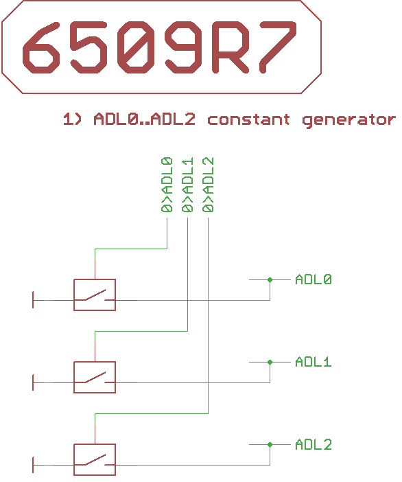

1) ADL0..ADL2 constant generator
Interrupt vectors are at the upper end of memory.
The internal addres bus lines of the CPU are precharged to 1 during PHI2.
//External address lines change later during PHI1.
The interrupt logic controls three FET switches for pulling the internal addres bus lines ADL0..2 to GND
according to the interrupt vector, for more details see "23) interrupt logic".
Control signals for these three FET switches are named:
0>ADL0, 0>ADL1, 0>ADL2.
The three FET switches are located at the North West side of the mill,
and physically they almost look like an integral part of the A0..2 address bus latches\drivers.
//We now travel from West to East trough the mill of the CPU.

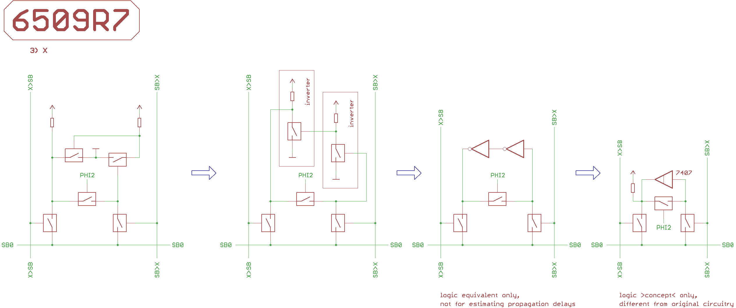

PostPosted: Thu Dec 16, 2021 8:46 am
Posts: 1431
3) X register
X register is located East from the Y register in the silicon.
Circuitry is identical to "2) Y register".

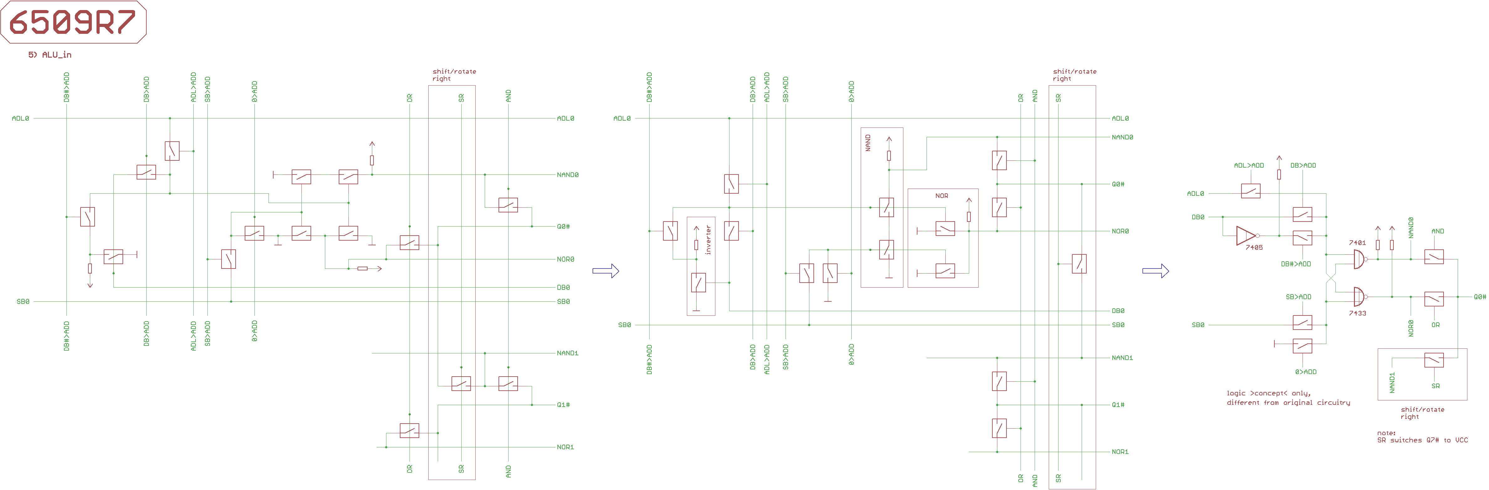

5) ALU_in
ALU_in is located East from the Stackpointer in the silicon.
For understanding how the ALU works, it was necessary to break it into three parts.
For convenience, I had named the part where the bus signals enter the ALU just ALU_in.
What isn't exactly correct, because it also handles things like AND, OR, shift right.
Three bus signals enter ALU_in:
ADL, the internal A0..7 address bus,
DB, the data bus from/to the "15) data latches" (which connect to the external data bus),
SB, the special bus.
One ALU input is either ADL, DB, or inverted DB.
The other ALU input is either SB, or 0.
ALU_in generates NAND (open collector with pullup) plus NOR (open collector with pullup)
for both ALU inputs, these signals are used later for the ALU carry chain, the BCD detection\correction,
also for "9) V evaluation" (overflow detection that is).
The ALU result bus Q# is low_active,
FETs controlled by 'AND' are switching the NAND output signals on the Q# bus,
FETs controlled by 'OR' are switching the NOR output signals on the Q# bus.
Shifting/rotating right just switches the NAND output signals in a different order to the Q# bus,
except for Q7# which is pulled to VCC.

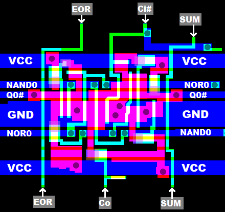

PostPosted: Thu Dec 16, 2021 8:53 am
Posts: 1431
ALU carry chain is located East from ALU_in in the silicon.
The ALU carry chain features the usual inverted/non_inverted carry scheme for binary adders.
For more details, start reading here.
FET switches controlled by 'EOR' place an XNOR (open collector with pullup) of both ALU inputs on the Q# bus.
FET switches controlled by 'SUM' place the inverted adder sum on the Q# bus.
