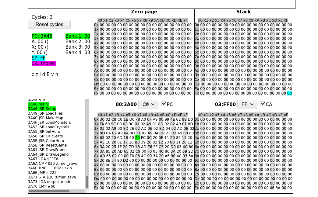

That's really nice! I like the view of various memory areas of interest. Here's an illustrative screen grab (it's in-browser so very easy to increase the font size)

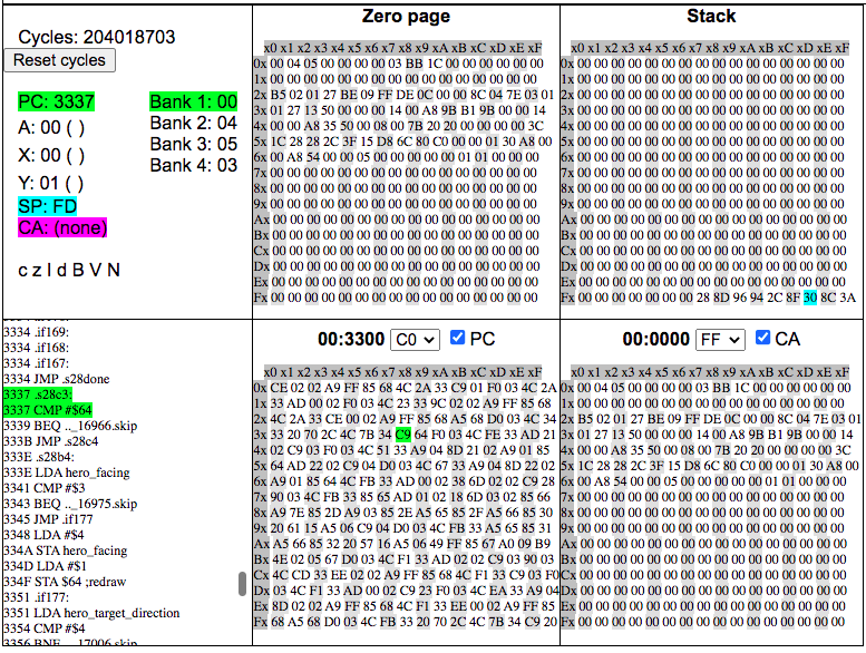

Thanks, BigEd. What browser are you using? The gray and white rows should be aligned straight...
My guess is that it's to do with the font - proportional width vs. fixed width font - likely in the original page on the server that page comes from (all I see is a static image here, so the image is as Ed saw it in his browser).
Maybe force a fixed-width font (or pre-formatted text tags?) in the javascript?

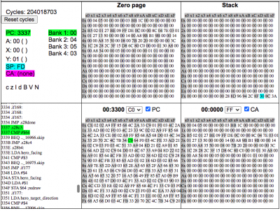

Below is what I see accessing the website from Windows. The problem is that I use the font Lucida Console all over the site which has been my goto fixed width font since the earlier 2000s. Apparently, it was designed for situations exactly like this where you need to cram a lot of text into a small area and have it be legible. It turns out that the font comes with Windows but not everyone else has it. The website is updated now to use Courier New as a fallback then whatever your monospace font is if you don't have that. Would you guys mind having a look again? I should stick to embedded programming and stop pretending to be a web developer...

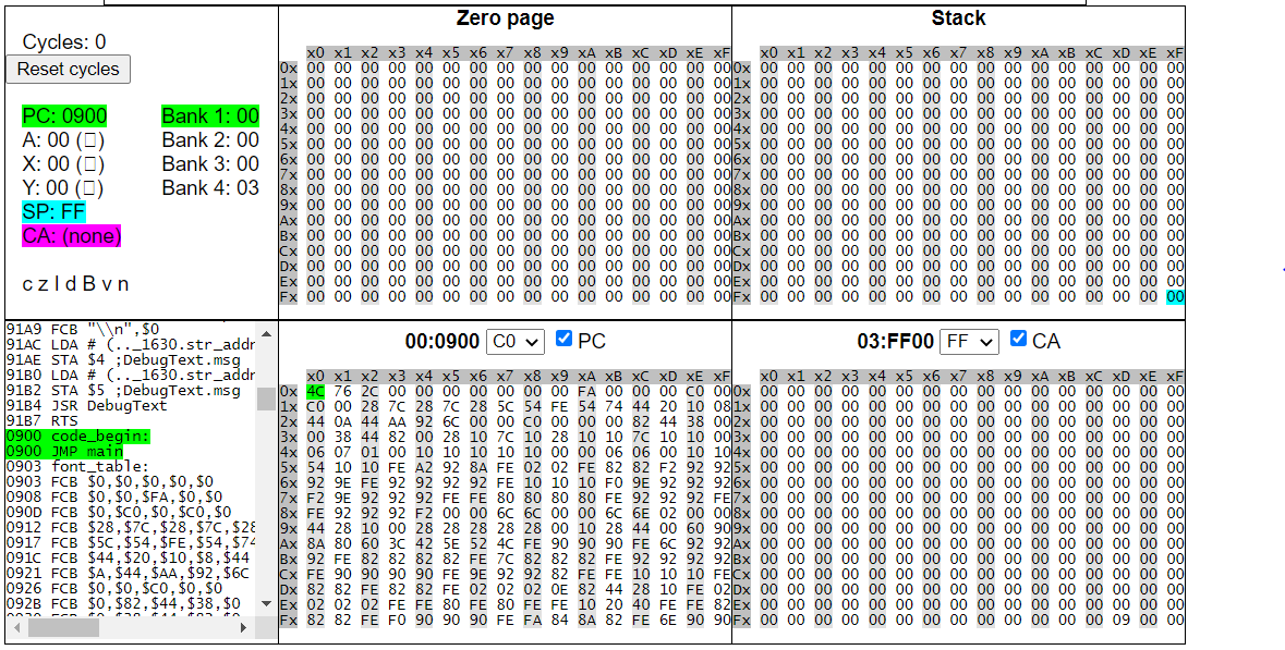

It's still a bit wonky for me. I even tried changing the font to courrier-10 and telling my browser (firefox) to use my fonts all the time. I tried with chrome too. Same. Example here:
Can you use <pre>...</pre> tags?
