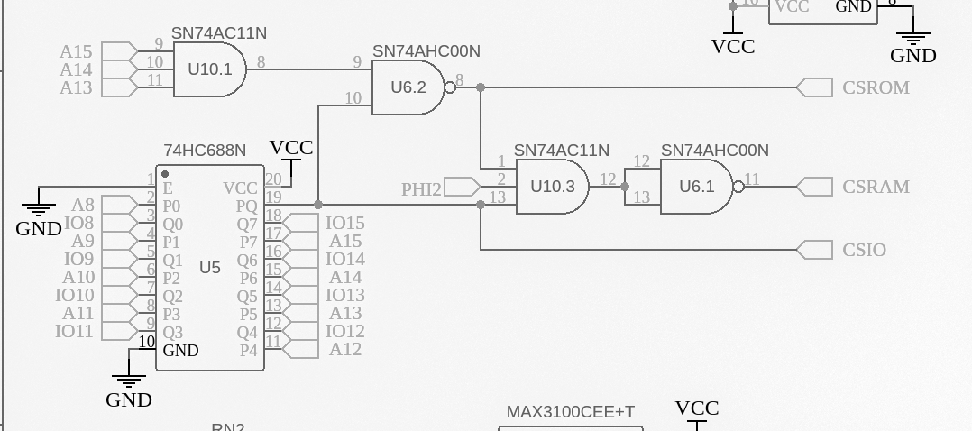

Can I just point out that some members here have difficulty reading coloured schematics. It would be appreciated if you can either post black and white diagrams, or provide both.
Also that there is normally no problem with 74HCxxx driving 74HCTxxx. And there is no problem with 74HCTxxx driving 74HCxxx, as both have the same type of output stages.
Mark
(facepalm) I forgot to grayscale the schematic. Argh..
I read somewhere that both HCT and ACT are more susceptible to noise, and that's why I am going to snag a few HC/AC replacements.
Steve

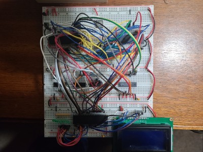

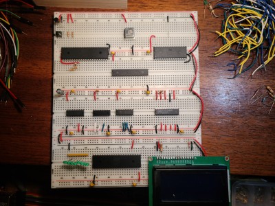

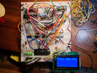

It's alive! There must've been either a bad connection or a crossed connection. It works now. I'm running my LED loop test except I changed it to store the $55 value to $C000 and $AA to $7000 so as to test each side of the 32k threshold. It's been running for about 5 minutes without issue now. I've uploaded some pictures. I have a shipment from Mouser that should come in this week. It has some 74AC10s in it which should allow me to do away with the inverter.. but I don't know if I want to have more than one 6522 which would necessitate keeping the 74AC11 so I can share the IRQ line with everything.
I also found that I left one gate on the inverter floating.. perhaps that was the issue.

File comment: The old wiring
File comment: Projects 1 and 2
File comment: Before I re-wired it.
File comment: Sweet

This new logic will allow you to place the IO page anywhere on the map. I've tested it at $FE00 and $0000 and it works. I wonder if there's an application where having IO on zero page would be useful. Perhaps if you were controlling something where every clock counted.. but I suppose the 6502 may not be the best solution in that circumstance.
I did get some 74AC10's and replacing the '11 and removing the inverter worked fine, but you couldn't place IO in ROM space with that setup.
