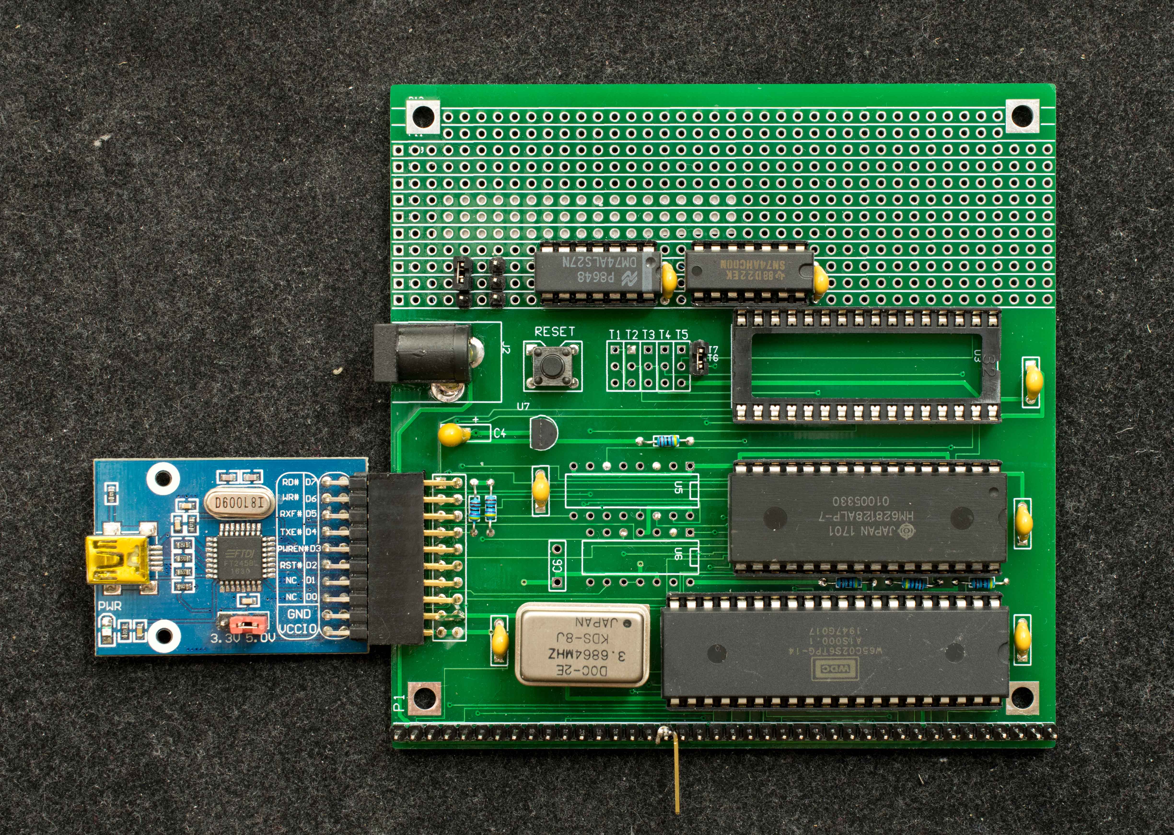

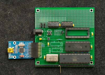

I have not given up on the idea of ROM-less 6502-based EPROM programmer. I did give up the original concept of putting EPROM in location $0-$7FFF and RAM in $8000-$BFFF--it is just too difficult to write program with such memory map. Programming is hard without stack and Zero Page.
So this is another concept and modified pc board (schematic and board picture attached):
RAM $0-$7FFF
FT245 $8000-$FFFF in programming mode, $8000-$BFFF in normal mode
EPROM is writable shadow at $8000-$FFFF, $C000-$FFFF in normal mode
I have been waiting on 74ALS27 which came in yesterday. Hardware is now working, I can load program into RAM through FT245 and I can run it. Now I need to come up with software to program the shadow EPROM resides in $8000-$FFFF.

I believe I have a working 6502-based EPROM programmer. This is the programming flow:
1. Switch to programming mode, load bootstrap (Prog65boot), then load the 4-function monitor (ProgMon), and load the SST39SF040 programmer (ProgSST). Run SST39SF040 programmer which erases EPROM from $C000-$FFFF then copies data from memory $4000-$7FFF to EPROM.
2. Switch to normal mode, and power up to run software of the newly programmed EPROM. Picture shows a basic 4-function monitor (load, display, modify, go) running on Prog65.
Some additional details:
RAM is from $0-$7FFF. Bootstrap loader and EPROM programmer are located in lower half of RAM. The upper half of RAM (16KB) contains the image to be programmed into EPROM. Different EPROM will require a different EPROM programmer software because they have different command sequence. Bootstrap and EPROM programmer are small software; bootstrap is 256 bytes and SST39SF040 programmer is 200 bytes. It only takes a few seconds to program 16KB.
A double-pole, double throw switch can simplify switching between programming and normal mode. The board only consume 30mA at 7.37MHz, so it can get its power from USB via FT245R. I'm getting rather fond of FT245R. It is really fast and an effective I/O device. It is somewhat expensive at $12, but offset the cost by replacing an I/O component resulting in a simple SBC consists of CPU, memory, and glue logic.
OK, I'll write up this design and release it to public domain. Normally I put my design files in retrobrewcomputers.org, but I also like to enter it in the document area of 6502.org. How do I access the 6502.org repository?
