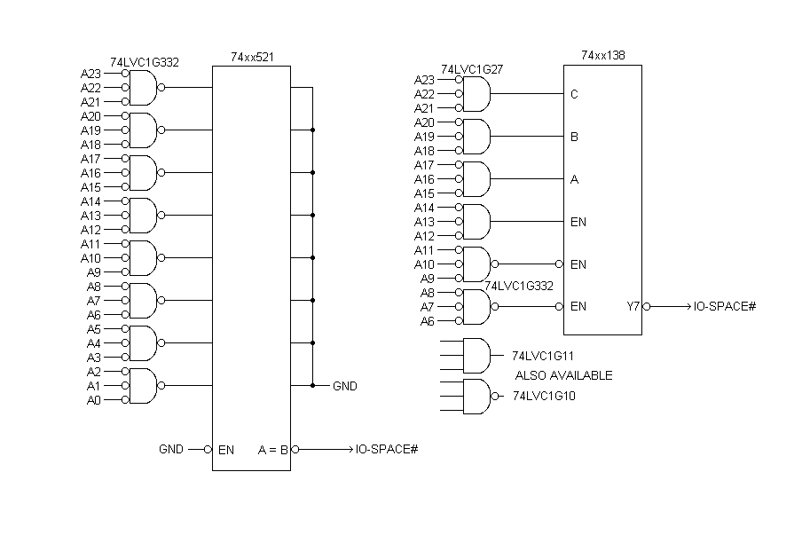

To manage bank-aware decoding, programmable logic is one option, as BDD noted. And the diagram below shows how familiar chips like the '528 and the '138 can have their input capacity tripled to handle the wider addresses produced by the '816. The little 'LVC1G27 and 'LVC1G332 gates you see have maximum prop delays of 3ns or less, so the arrangement is faster than you might suppose. The real bottleneck will be the '528 or '138, and in that case FCT Series logic is probably the fastest choice.
BTW, I agree when Sheep64 points out that, "The "best" arrangement depends upon total RAM and usage patterns." Different circumstances result in different tradeoff choices. But I myself would never dream of breaking up the 816's big, beautiful, flat memory space!
- Attachments
- '816 IO-decode.png (10.08 KiB) Viewed 1392 times
