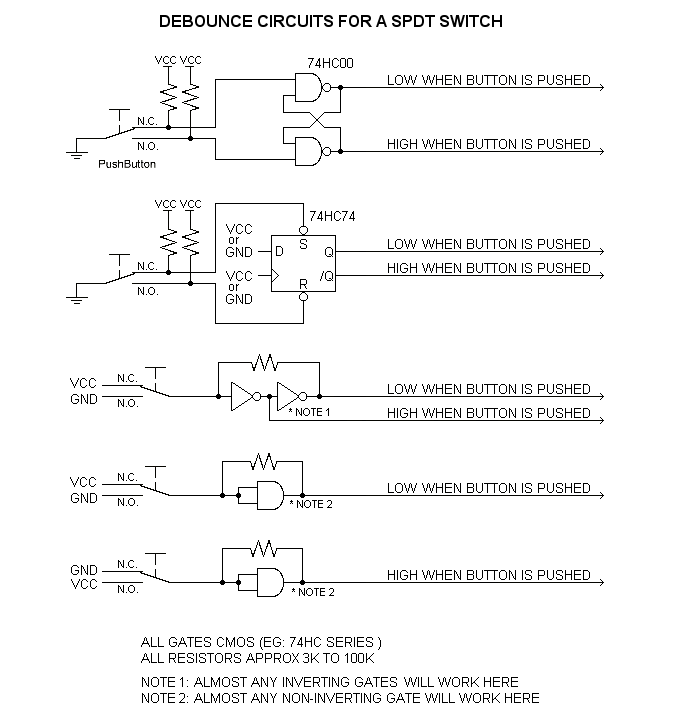

PostPosted: Sun Oct 31, 2021 1:57 pm
Posts: 3366
It sounds like you didn't de-bounce the switch. An RC followed by a Schmitt-trigger gate will do the job.
Yes, there are various ways to debounce a switch. Garth mentioned an RC followed by a Schmitt-trigger, and BDD's Maxim DS1813 suggestion is also good.
As shown below, several other options become available if the switch is a double pole type (ie, equipped with both Normally-Open and Normally-Closed contacts). These options may make better use of available resources (ie; if your project has leftover gates available).
