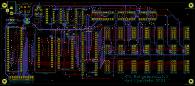

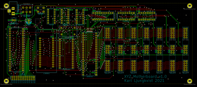

I am working on my own 8-bit computer based on the 65c02, and after about a year at the breadboard stage, I am now preparing a PCB for a more permanent design.
Basically, the architecture is based the one from Ben Eaters video series, but with a slightly more advanced address decoding scheme to accommodate a number of expansion cards/peripherals/devices. Also, there is interrupt multiplexing circuit to handle all the devices. The first device is integrated on the motherboard (a 65c22 with GPIO pins). Here is the address map:
• 0x0000-0x7fff RAM (32KiB)
• 0x8000-0x87ff Dev0-Dev7 (256 registers per device)
• 0x8800-0x8fff IrqDev (really only one register)
• 0x9000-0xffff ROM (28KiB)
Oh yeah, I am aiming for a 1MHz clock, so hopefully pretty permissive in terms of propagation delays.
I have been working on this motherboard PCB for a while, I am starting to be happy with the design (see attached pictures). Any feedback before I send it off for production would be greatly appreciated! Of course, there are endless variations in a design like this, but it would be good to avoid making any bigger mistakes that I regret later. Some particular questions:
• Does the power supply design make sense? I thought a simple 5V input would be the simplest solution, but is there any drawbacks with that?
• The reset circuit is just the simplest possible. Would I regret not making something more fancy?

Unfortunately, I can't read some of the schematic because of the color, but I was able to make out the reset circuit (and one or two other details). As designed, reset won't work properly. You need to add something to hold reset down for a short while after power is first applied—150-250 milliseconds is sufficient. You can use something like a Maxim DS1813, or you can "roll your own" with a Schmitt trigger and a simple resistance-capacitance delay. As the 65C02's reset input is not Schmitt, merely attaching an R-C delay will not produce a clean reset.
10K is too high a value for pull-up resistors—your circuit will be noise-sensitive. I recommend going down to 3.3K.
It's best to not mix 74LS logic with CMOS logic. While CMOS can reliably drive LS, the other way around isn't true. You should be using all CMOS.
May I suggest you refer to Garth Wilson's "6502 primer" article? His series of pages offers much more detail than you can get from some videos.

Thanks for the heads up regarding the reset circuitry; the page you linked to explained what I need to do pretty clearly (http://wilsonminesco.com/6502primer/RSTreqs.html). I did find that there were three versions of the DS1813 (-5+, -10+, and -15+) with different threshold voltages. Does it matter which one I choose? I guess the most permissive one should be okay (-15+ with threshold 4.13V).

Updated schematic with added ds1813, and a smaller CXO. Are these colors better?

I'm blue-green colorblind (tritanomaly), along with some trouble distinguishing yellow from white. Blues and greens on a white or yellow background are almost invisible to me, moreso on white. Reds and greens are fine.
Your choice would depend on how stable your power source is. I use the -5 version (4.62 volts), which works for me because I use an old PC power supply to run my unit and can count on it to produce a stable output. If you're powering your contraption from a 5 volt wall-wart, you probably should go with the -15 version so you don't get nuisance resets.
The DS1813 is available in a TO-92 package, which is quite hobby-friendly. It's also available in SMT if you are pinched for working space.
Oh and thanks for pointing out regarding HC vs LS chip families. I have understood that the HCT family is TTL compatible, but it is still CMOS like the HC, so should be okay, or?
Yes, an HCT device's input will "understand" LS output. However, there is no good reason to use LS at all. Virtually everything that was developed in LS logic is available in CMOS—and if it isn't, you probably shouldn't be using it. There are also other CMOS families worth considering, especially 74AHC(T) which produces the performance levels of 74ABT and 74AC, but with "gentler" outputs that are less likely to provoke ringing and other circuit maladies associated with extremely fast edges.

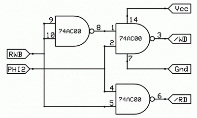

I wonder if you might want to include the PHI2 qualified read and write signals on that 'ctrl' bus to support non-6500 type peripheral ICs?
PostPosted: Tue Oct 26, 2021 6:57 am
Posts: 8175
That's a good suggestion. Something like this:
File comment: Ø2-Qualified Read/Write
The attachment read_write_qualify_alt.gif is no longer available
I thought about that too. In fact, I guess I already have that signal available from this part of the circuit:
(for some reason I decided to use ~WE instead of ~RW)
But I thought for simplicity that each peripheral could be responsible for computing whatever signals it needs based on the raw phi2/rwb/csb signals.
But yeah, it might make sense, but now I feel a bit too lazy to rewire to rewire the two additional signals into the bus :P

honestly I wouldn't bother with including more voltages. the only one i could think of that would be useful to have on hand is 3.3V, to interface things like FPGAs, SD Cards, and a Raspberry Pi (and pico) if you're into that.
If you actually want to get into sound generation it should be somewhat straight forward to just use some existing chip like a YM3812 or SN76489, which don't require any negative voltages for their Amp circuitry, so i'm sure you'll be fine with just having 5V for now.
and one question i always had whenever i saw someone post about their retro computer but never bothered to ask... why an EEPROM over a FLASH chip?
i don't really see the appeal... unless you already had some lying around, or got an old programmer that cannot handle Flash (or don't want to spend time turning an Arduino into a Flash Programmer)
Flash is much faster, comes in higher capacities (not that relevant for an 8 bit CPU, but more for something like the 65C816 or 68k), and is usually much cheaper brand new.
also in your schematic at the Interrupt logic, why not have the output of the 74HC148 go to D1-D2 instead of D0-D2? that way you save yourself a shift instruction when handling Interrupts.
a bit more detail in the primer: http://www.6502.org/mini-projects/prior ... coder.html
overall it's a pretty neat looking board and i'll hope you make lots of cards for it!
though personally i would've used KiCad's "Conn_02x<number>_Odd_Even" symbol for the expansion connectors. as they look a lot closer to the actual footprint, so it's easer to wrap your head around where each pin is gonna end up on the PCB.
I also think I will settle with 5V and Gnd. Some limitations are actually nice and inspire your creativity.
That D1-D3 idea is actually quite smart, thanks for the suggestion and the link!
