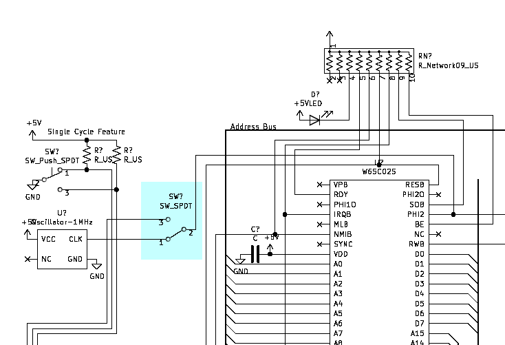

PostPosted: Sun Oct 17, 2021 5:06 pm
Posts: 3349

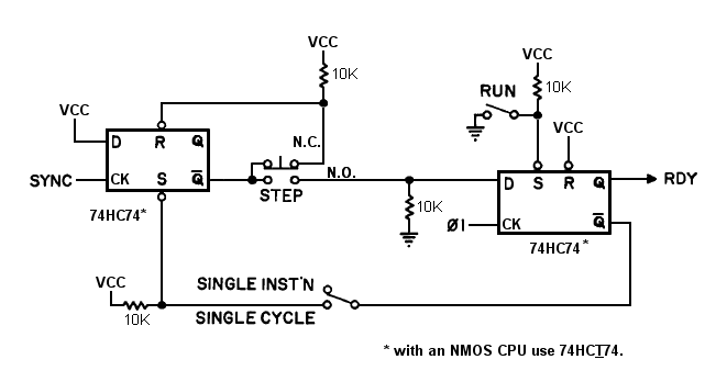

Chad, your approach (above) with the clock switch isn't the best. It'll work in full speed and it'll work in single step but when you switch between the two the machine will be apt to crash due to the CPU clock input momentarily floating and/or receiving mangled clock pulses.
Circuits exist to glitchlessly switch between clock sources, but they're not quite trivial. I'd suggest you omit the single step feature or choose an approach that uses the CPU RDY input (rather than manipulating the clock itself).
The manual for the Apple 1 has a single-step circuit using just a single 7474. It's somewhat obscure (to me, at least), so I redrew it in a way I find clearer. Also, with the CMOS 'HC74 in mind, I added some pullup resistors and Vcc connections which aren't strictly necessary with the TTL part.
"Single Instruction" mode allows the CPU to advance 2 or more cycles at a time, stopping when SYNC goes high (indicating the next opcode is being fetched). "Single Cycle" mode is slower and more detailed, stopping on every cycle. (Exception: During write cycles, NMOS CPU's cannot be stopped using RDY.)
PostPosted: Sun Oct 17, 2021 5:43 pm
Posts: 703
Thank you Jeff! Hm, go figure. I am finding more and more that "slap a switch on it" or "just put a capacitor on it" isn't good enough. These little details completely escape me, until you mention them. So thank you.
I had seen Woz's schematic for it, but yes, yours is better for sure.
So you mentioned to maybe ditch it altogether? I see that most if not all of y'all do not use it. But then again, y'all know what's going on and have been doing it for a while. The point of me having this feature at all would be to debug somehow. If it's worth an extra chip and more complexity, I'm willing to keep it. If it's not worth it in the end, then I'm willing to ditch it.
Either way, thank you Jeff, I will remember this for sure.

PostPosted: Sun Oct 17, 2021 8:49 pm
Posts: 3349
"Worth it" will depend. Yes it's helpful for debug but other debug techniques can take its place.
Being able to freeze the CPU means you can very slowly (at human speed) poke around and measure logic levels one by one by using a logic probe, or even a multimeter. That's pretty powerful if you don't have an oscilloscope... but if you do then in many cases the 'scope will be preferable to single stepping. And something that's more powerful yet is a logic analyzer, but at this level it's possible to get carried away with fancy tools; they can be a distraction from using your eyes and your brain to be on the lookout for simple mistakes.
If you do include the single step, you may wanna also include some LED's on the buses, because it's a whole lot easier to just look at 8 LED's and say, "Oh - that's hex 34," or whatever, rather than doing 8 successive pokes with the logic probe. Ideally you'd have 8 LED's for the data bus and 16 for the address, but last time I did this I omitted the LED's for A8-A15. Speaking of LED's, you'd wanna include R/W and probably SYNC.
Also nice if the LED current-limiting resistors are in an array; also nice if the array is socketed so you can unplug and replace the entire array if the resistance you initially chose turns out not to be the best.
