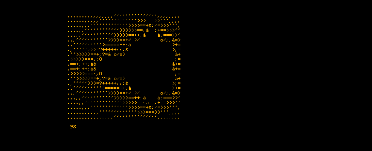

litwr
Posts: 188
Joined: 09 Jul 2016
Re: Benchmarking
Post by litwr »
Where was the fastest ROM Basic written? It seems that the fastest ROM Basic is not American, not British, not Russian, but Swedish.
Results of my experiments with the ABC 800 emulated on MAME/MESS show that the ABC 802 can build this fractal picture for about 93 seconds. It is faster than the BBC Master 128. The ABC 800 is a computer released in 1981. Its CPU is relatively slow, it is the Z80@3MHz. So its results are really great. However it uses single precision FP by default, 4 bytes for a number. BBC Basic uses 5 bytes. So if we normalize results giving 25% advance to the BBC Master we get that the BBC Master is slightly faster after all.
ABC Basic uses semi-compilation. It does error checking immediately, you don't need to start program to get a break on a error. Moreover it can handle long fp numbers with up to 125 digits! Such thing was possible only on mainframes in 1981!

litwr
Posts: 188
Joined: 09 Jul 2016
Re: Benchmarking
Post by litwr »
(do you have a reference for 125 digit calculation? I can't find it!)
I have made a screenshot
These long fp operations are described in this Basic manual.
It is astonishing that even the ABC80 from 1978 had almost the same Basic features as the ABC800. Of course, ABC80 Basic is less developed and slower than ABC800 Basic.

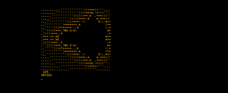

litwr
Posts: 188
Joined: 09 Jul 2016
Re: Benchmarking
Post by litwr »
I have just run the benchmark on the emulated ABC802 using double precision FP. The result is 205s - it is approximately 120% slower than single precision FP result. So the dependency between the accuracy and timing is more than linear and this means that the BBC Master normalized Basic performance is even greater if we compare it with the ABC performance.
More results is here. It would be interesting to add a result from the Master Compact. Wiki claims that its Basic is about 30% faster than Basic of the BBC Master.
