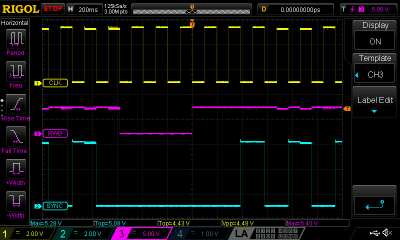

Indeed, in that last screenshot the scope channel was set to 10X erroneously.
So it's been a while since I was able to troubleshoot here, but I have some new findings that are making me tear my hair out. I have tried programming the ROM with "EA" in every bit. I'm still seeing very strange behavior. With the NOP-ROM in place, I'm still seeing LEDs driven by the 6522 illuminate. This was strange to me, so I set up my scope to capture CLK, SYNC, and RWB. It was my expectation that a ROM full of NOPs would never cause the RWB signal to go low. Is that a misunderstanding?
File comment: CLK, SYNC, and RWB

Three write cycles in a row can only happen one way: an interrupt. So you need to check your interrupt lines (and possibly your reset line.) (And also check for BRK which is another kind of interrupt: might the 6502 see a 00 on the databus?)

Yes -- what Ed said. Check the level on your IRQB pin. I think you'll find it's low, and that's what's causing the unexpected interrupts.

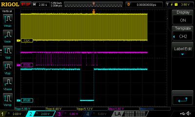

Hmm, something does seem to be pulling IRBQ low for a little while after a reset, but I am seeing plenty of RWB traffic before IRBQ ever goes low. NMIB has been reliably high in my experiments so far. I'm not sure what's pulling IRQB low, I'll do another visual inspection of the board, and I guess make sure nothing strange shows up on those signal lines with a DMM?
File comment: CLK, RWB, IRQB
Probes are directly clipped to the 6502 pins. This trace is immediately after depressing the reset pushbutton.

This is going to sound really stupid, but are you sure all the power and ground pins are connected to all the chips?
It's not unheard of for a chip with the Vcc pin disconnected to be powered by a high input through a protection diode - everything seems to work until all the inputs are low, when the chip loses power and forgets its state. Or, if it's powered through an input with a pullup resistor, a current surge could have a similar effect.

Is the schematic here: http://forum.6502.org/download/file.php?id=12101 (on the first post of this thread) what you are using?
If so, you appear to have made a mistake with the I/O decoding. You have an nIOSEL line decoded as
nIOSEL = !(!A15 & A14)
by logic gates U2A and U2C. This is an active-low select which is active for addresses 4000-7FFF. So far so good. But you have connected it to pin 24 on each 6522, which are active-high chip select pins. VIA U6 is active when nIOSEL is high and A13 is low, and U7 is active when nIOSEL is high and A12 is low. This means that:
U6 is active for addresses 0000-1FFF, 8000-9FFF, C000-DFFF
U7 is active for addresses 0000-0FFF, 2000-2FFF, 8000-8FFF, A000-AFFF, C000-CFFF, E000-EFFF
So you have some addresses where there is contention between ROM and U6, some addresses where there is contention between ROM and U7 and some addresses where there is contention between all three.
If your ROM is contains all EA's, the first opcode fetch will be from EAEA which will immediately result in a collision between ROM and U7.
What you need to do is connect nIOSEL to the active low chip select on the two VIAs. Then use your spare NAND gate as an inverter attached to line A13 and have the active high chip select of one VIA driven by A13, and the active high chip select of the other VIA by !A13.
