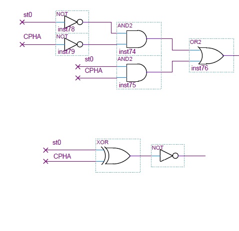

hello Bill,
It looks like you captured all the logic accurately. For the clock circuit of the SO[0..7], the following can be used. I may have had problems with an XOR in the logic, so I worked around it the long way. I'm not sure which is more efficient for Altera.
It does appear that the preset and reset of the flipflops are active low, so your added inversion also looks correct.
Please report back your results when you are able to test the functions in circuit.

Thank you for looking over the schematic. I'm please to know it is correct. Altera Quartus software will minimize the logic automatically so the gates drawn in the schematic are not necessarily implemented as is.
I do have SPI based Ethernet as well as and SD card. I'll let you know how the schematically based CPLD worked out. Using Atmel's pof2jed program I can also convert Altera's .pof file to jed file to program your ATF1504 so you can also check it out on your hardware setup.
Attached is the Quartus design files of the 65SPI that you've looked over.

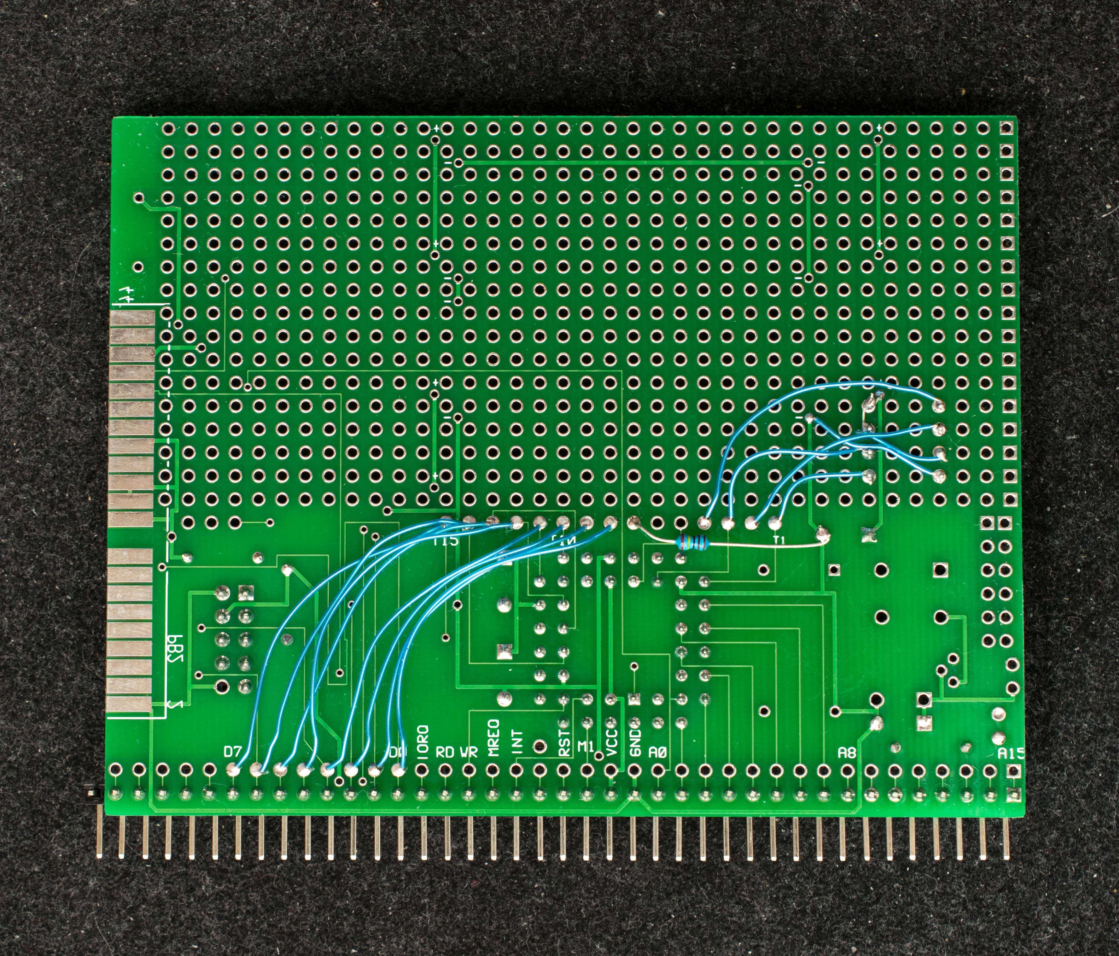

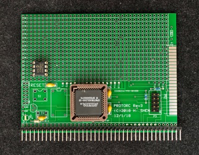

I ordered a few SPI EEPROM, 25LC080, from Mouser and built a CPLD protoboard so I can use CRC65 SBC to test the 65SPI designed in Altera schematic. The CPLD prototype board already have existing pin assignment so I removed a few pins from 65SPI so they will fit. The pins removed are MRD, MWR, CS2, and 5 slave selects. It compiled OK with 75% macrocell utilization. I'm ready to write the software to test the SPI.

Powered up the board and no smoke!
25LC080 is a relatively slow SPI device, so instead of using external clock, I just slow down 6502 to 7.37MHz. Fixed a couple simple mistakes and I'm able to talk to 25LC080, but there is a problem: writing to SPI control is causing soft reset even though the software reset bit is 0. I believe the problem is due to data bit 7 not valid until near the falling edge of PHI2 clock. While data bit 7 is changing, it can generate glitch on the asynchronous preset of flip flop. I redesigned the SRES logic so data is latched in on the falling edge of clock and cleared on the next falling edge of clock. In attached schematic, the bottom flip flop was the original SRES logic. The top flip flop is the modified logic (note: nCLK is inverted PHI2).
With that mod, I can now change the SPI control without spurious reset. I have more tests to do...

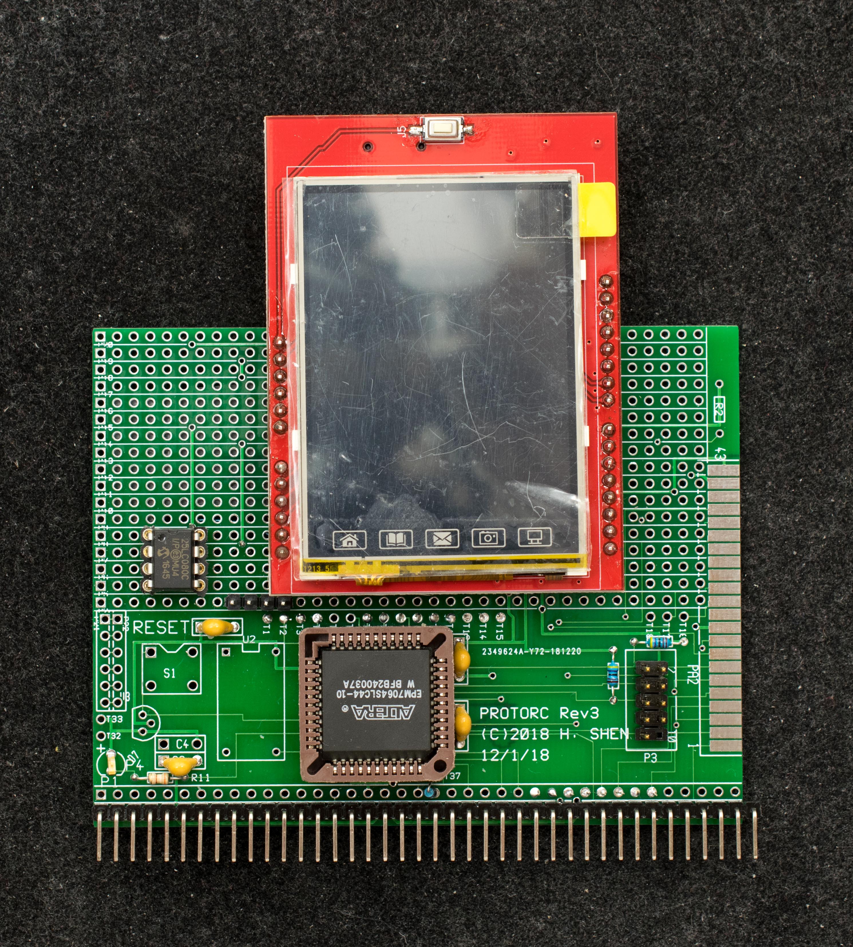

If I ever run out of projects (unlikely), I can work on this: QVGA over SPI. I have at least 3 projects ahead of it.
