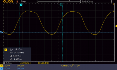

For the clock, I was running another Pi Pico firing at whatever frequency I programmed it to. For low-ish clock speeds (maybe ~15 to 20 MHz - can't remember), driving the PHI2 pin was fine, but anything higher than that, I had to route through a 74HC04, because the Pico's GPIO pins are only 3.3v and wasn't cutting it anymore. The 74HC04 gave it a nice 5v wave again.
At the end of the day I was able to squeeze it to 34MHz. As long as my little homemade analyser was sitting in the low $D000 area, I knew I was good. But, look at it sideways at that clock rate and it crashes and starts trying to execute code from all over the address space. :lol:
That's my personal best right there. At that rate I could see the occasional droop in the wave and more often than not, that's when the program would crash.
So my belief is that the clock is letting it down at that speed. I reckon the CPU still has more in it. And this is all still at 5V. 40MHz might realistically be in reach.
When you see the un-optimised stripboard layout and wires I have hanging from this thing, it really makes me wonder how fast these things could scream along in a decent environment.
What kind of test program is it? Two things I'd be inclined to try: Klaus' test suite on the one hand, and a Basic interpreter running a benchmark on the other hand. (When working with PiTubeDirect, we often use the attract mode of the game ELITE as a test. We also use the WOOLBAL or SPHERE demo, which is a Basic program which does trig and draws lines. Both of those need a graphics display, of course.)
The 74HC04 is likely not helping you as much as you'd like. Try a 74ACT04 and see if you gain some stability at the high speeds. The HC04's output transition speed isn't up to the WDC specs of 5ns or less.
If you do try the 74ACT04 make the connection from its output to the 65C02's Ø2 input as short and direct as physically possible. If ringing seems excessive try inserting some resistance in series with the connection, with the resistor (metal film) also as physically close to the 74ACT04 as possible. 100 ohms is a good starting point.
EDIT: For some reason, I had ±5ns. 5ns is 5ns. :D
