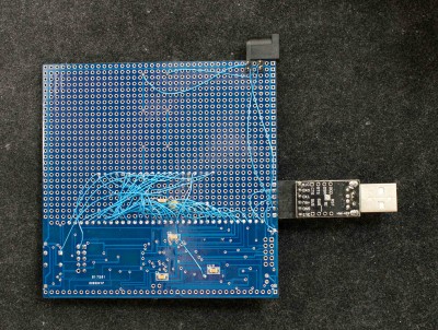

PostPosted: Mon Jul 19, 2021 4:38 am
Posts: 1076
I'm done for the night. This is where I am tonight. The wiring is finished. I have powered it up without the 6502 and able to program the CPLD. I had a working serial port design that I successfully ported to this CPLD. I'm able to get the serial transmitter to spit out data continuously by periodically jamming a byte into the serial transmit buffer. Tomorrow I'll write a 6502 ROM program for the CPLD and try to boot up a real 6502.
