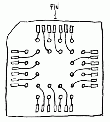

Do you by any chance have the pinout spec for these sockets? I am more interested in PLCC-28, actually, for 22V10s
Ok, I checked one with the DMM continuity-check function, and drew this. It's a top view. The contacts to the IC are shown farther out than they should be, just so there would be room to draw the connections.
I feel embarrassed... I could've done that myself :oops: but was too lazy after spending what felt like an hour on octopart... I thought you probably have a specsheet somewhere. Thank you.
