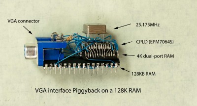

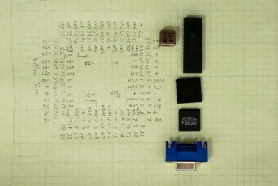

A VGA6448 daughter board can be constructed that plugs into the system RAM socket; the daughter board is consists of the original system RAM, 4K dual port RAM, ATF1504AS CPLD, 25.175MHz osc, and VGA connector. The original system RAM is plugged back in on the daughterboard and the RAM's address, data, control, and power are now driving VGA circuits. This way a VGA capability is added by piggy backing on the existing RAM. Memory map can be programmed such that the top 1K memory is programmable font tables; the other 3K holds 64x48 character memory.
I twisted my ankle and can hardly walk, so I'm taking a few days off gardening to work on retrocomputing projects. I thought I'll tackle something I've been thinking about: a stacked VGA interface for RAM socket.
This is a follow up to my musing about using system RAM socket as a VGA interface. The 4K dual port video RAM is shadowing a 4K portion of the system RAM such that all write to the designated 4K portion of the RAM is also written to the dual port RAM. The VGA controller is reside on the CPLD which will display the content of the dual port RAM on a VGA monitor. The interesting part is the circuitry is implemented as collection of stacked ICs so CPLD, dual port RAM and 25.175MHz oscillator are all stacked on top of the system RAM. The first figure shows all the components of a stacked VGA interface. The 2nd picture shows the components of stacked VGA glued to the system RAM.
To be continued....

The stacked VGA is all wired up. Here are the top, side, and bottom views. It is even smoked tested and no smoke are detected!
I'm looking for a test vehicle to check out this. I don't have a 6502 SBC with DIP 128K RAM, but since the VGA circuitry is invisible to normal RAM operation, any SBC with 128K RAM in DIP format is suitable for testing. The VGA video memory is mapped to 0xA000-0xAFFF in this particular implementation so writing to that block of memory will change the video display--that's the theory anyway.

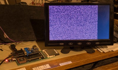

I decided to use a Z80 SBC, ZRCC, as the test platform for the stacked VGA interface. The original 128KB RAM is replaced with the 128KB RAM with piggybacked VGA. The power consumption went from the nominal 125mA to 230mA. ZRCC boots normally, passes memory diagnostic, boots into CP/M and can run CP/M commands. So the piggybacked VGA has no impact on normal operation of the SBC, as expected. What I see on the VGA display is also expected--random noises because video memory and font tables contain random data. Each line is blanked out after 512 pixels because there are 64 texts (8x8pixels/character) per line. There are two lines of blank pixels separating each line of text and there are 48 lines of texts. The magenta color is because I've only hooked up red and blue color. This is all good! Now I need to write some test software...
