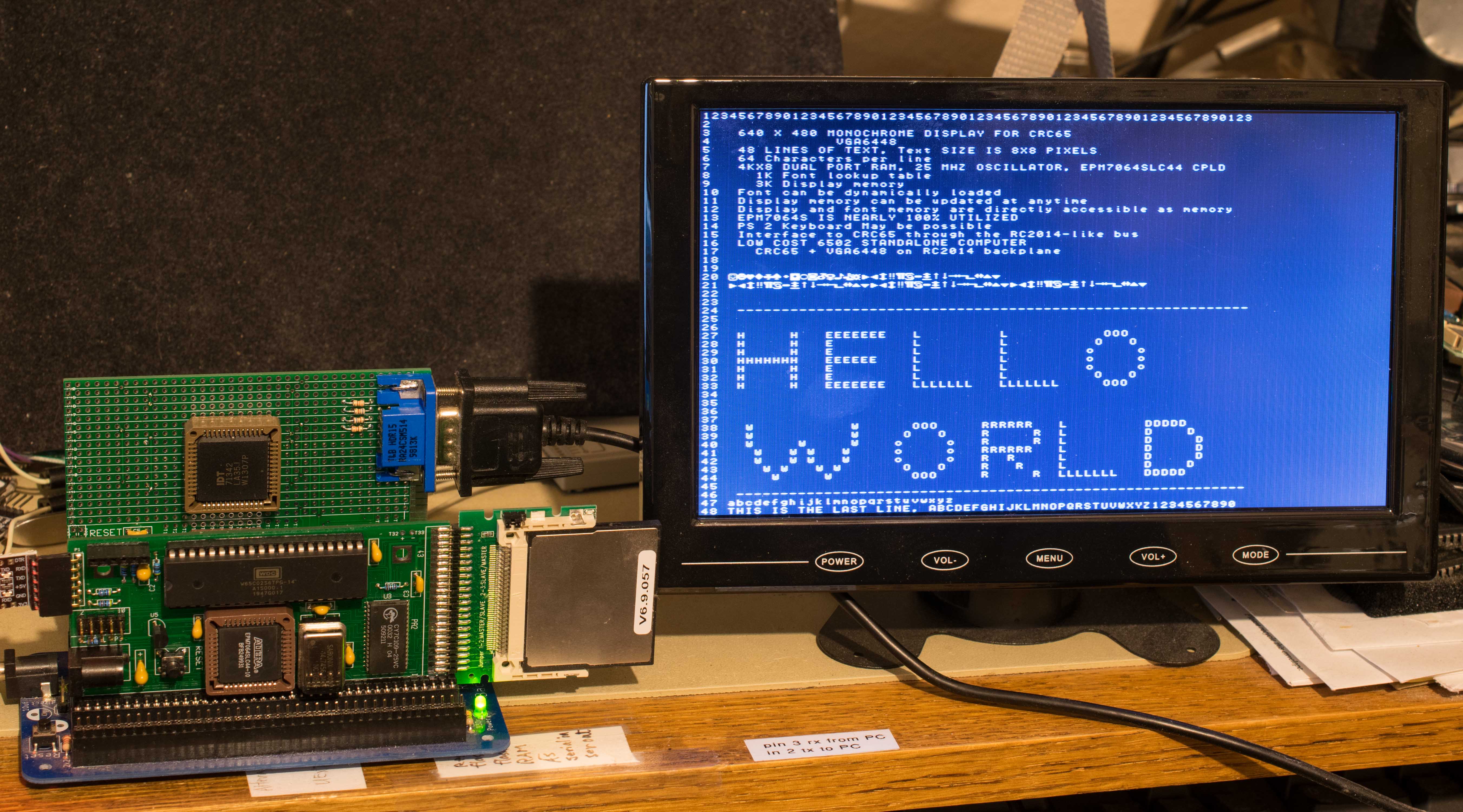

This is first cut of the VGA output from VGA6448. The CPLD design is not optimal, but it still fits within the 64-macrocell EPM7064S. PS2 keyboard function is not in the design because all CPLD I/O pins are in use. An external 74138 decode may free up sufficient pins to do PS2 keyboard function. VGA6448 design is fairly generic so can be easily adopted for other 8-bit microprocessors.
The left of the picture shows a 5-slot RC2014 backplane with CRC65 (6502 SBC) in the front and VGA6448 behind.
This is a 24-second YouTube video shows the "Matrix" screensaver running on CRC65+VGA6448. The ability to read/write video RAM directly at anytime simplifies the software significantly. The "Matrix" animation code is lesser than 256 bytes.
https://youtu.be/rQiBJkjPg44
