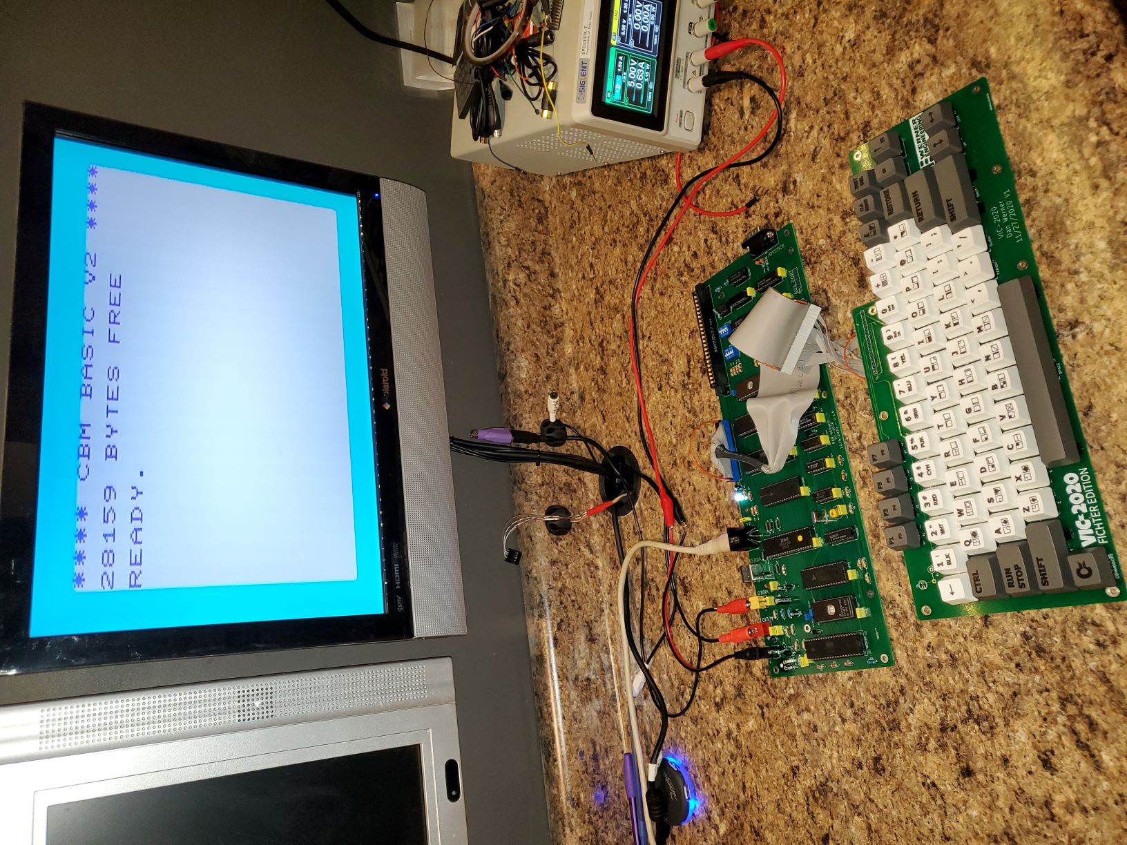

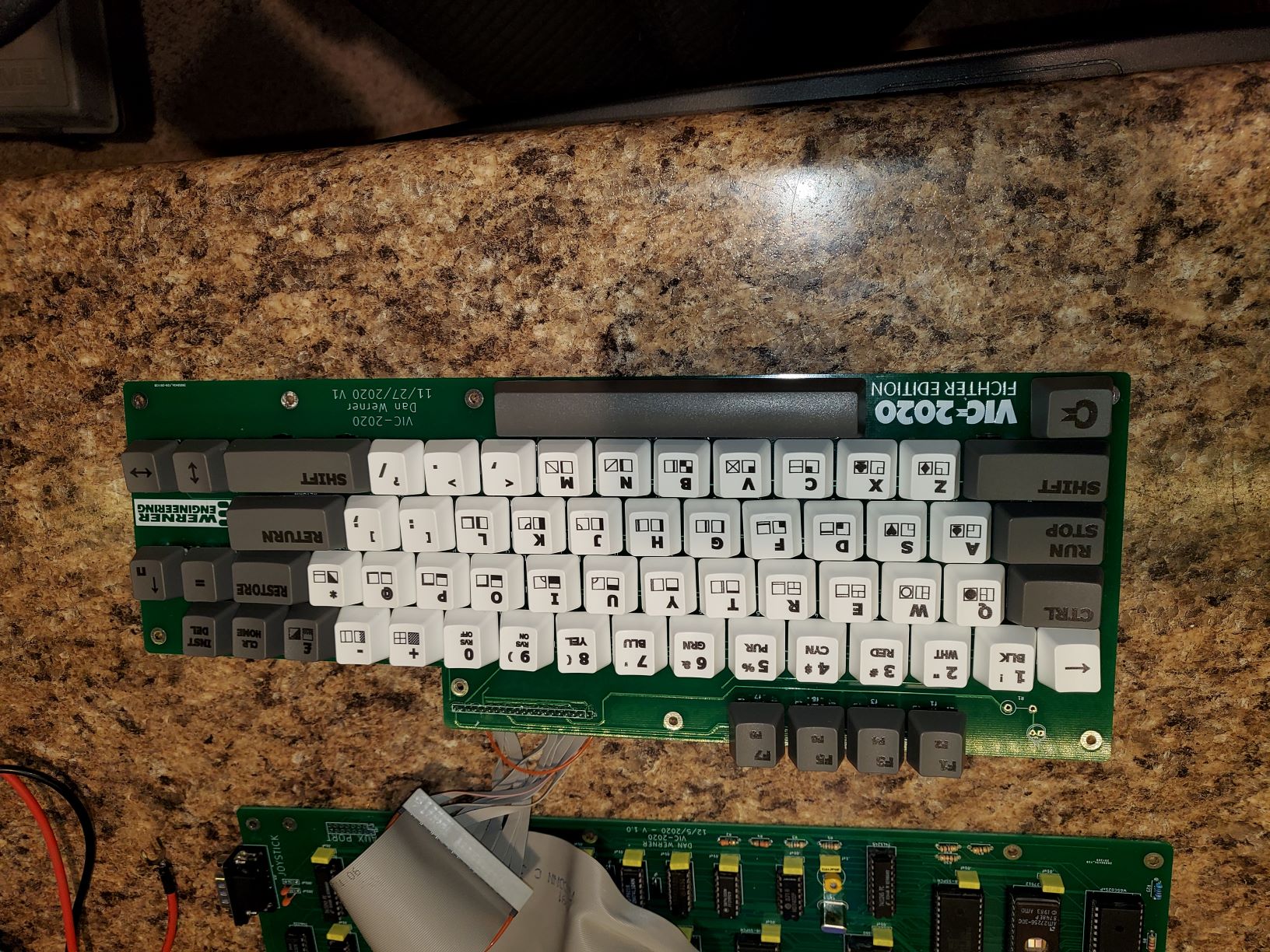

Finally, the VIC-2020 is working well and is far enough along where I can publish all of the project materials. The board works great and has passed all of my initial tests. I really like the Cherry MX keyboard and the custom printed keycaps.
All of the KiCad files, Gerber files and the Keycap art is located at:
https://bitbucket.org/danwerner21/vic2020
There are some project docs that describe the differences from the original VIC-20 and give some general information on how to build the system. ONE NOTE THOUGH -- the 3d printed case is still a work in progress (and will be for a few more days) do not print the STL files that are in the project as the boards will not quite fit in them yet. Will post again once the case is complete and ready to print.
Please feel free to reach out with any questions.
Dan Werner
PS -- I apologize for the flipped images, I have tried several different ways, but the board seems to insist that my images get posted filpped :)

Congrats on rolling out the VIC-2020 just in time! :) And thanks for the pics. The boards look fantastic.
 Post subject: Re: New Vic-20 project
PostPosted: Sat Dec 12, 2020 10:49 pm
On flipped images - if you click on them, they come out the right way up. I think they have been rotated using EXIF metadata, which the thumbnail generator ignores. To make the thumbnails come out right, you need to find a way to "bake" the rotation into the image data itself.
I had the same issue when reposting a photo and happened to have a Windows 10 box nearby, so I tried opening the image with Photos (I think this is the default Windows 10 app for viewing images), which showed it in the correct orientation. But rotating it 90° four times, which brought it back to the starting orientation, and then saving it produced an image that seems to have the orientation correctly "baked in."
