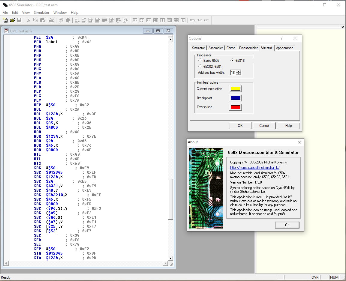

OK, so I thought I'd throw this tickler out.
Yes, I have added support for assembling 65816 code. Right now, it can properly assemble all of the 65816 opcodes and addressing modes, except WDM. The way the code is written, it used one value as a marker for an invalid opcode. For the 6501 and 65C02, there were plenty. The 65816 does not have any invalid opcodes. However, since WDM is reserved for future use, I chose to use it as the marker. You can still have a WDM opcode by using the .DB $42 directive.
As of now, it only operates on the first 64k of memory but I plan to expand that to the full 16MB (24 bit) address space.
Also, the Simulator and disassembler are currently disabled for 65816 mode. That will take a lot more time to complete, if ever.
I am still testing to syntax checker and am working on the memory extension. I will release a copy when I think its ready.
Is anyone interested in this new feature?
Daryl

8BIT wrote:
OK, so I thought I'd through this tickler out...Is anyone interested in this new feature?
Well, I think you know of at least one dinosaur that would give it a spin. :D
BTW, you likely already know that internally all values are stored as 32-bit integers. So I'd think it wouldn't be too much of a leap to get 24-bit addressing to work.
One thing I'd really like to see is
% used for the binary radix instead of @. You can't imagine how many times I've been tripped up by that over the years. :D
Well, the code uses UINT16 and UINT8 all over the place so right now any address over $FFFF gives errors or gets truncated. I know I can do it, its just going to take a lot of time to go line by line in the code to update address references to UINT32.
One thing I'd really like to see is % used for the binary radix instead of @. You can't imagine how many times I've been tripped up by that over the years. :D
Unfortunately, % is used now for the Modulo function for expressions. I could change it, but then others might have issues with having to change their sources. Had % been available, I could have added it so that either could be used for binary radix and everyone would be satisfied.

% the numeric literal prefix and % the binary operator appear in different contexts, with no overlap. It's always possible to distinguish them, although an existing parser might not be structured in a way that makes it easy. It's similar to * being used for both "current assembly address" and multiplication, or - being used for negative numeric literals and subtraction.
I think I've mentioned it here before somewhere, but my favourite notation is [[radix]$]<number>. A number on its own is in decimal. With a $ before it, it's hex. If there's a number before the $, that specifies the radix. So 10 = $a = 16$a = 2$1010 = 8$12 = 6$14. Base 23 doesn't come up all that often, but if you ever need it, it's there. My assembler accepts % for binary as well, because it's a common convention.

The parser was not written to allow for the context of % to be distinguished. I do not plan to rewrite the parsing code, but have come up with a workaround for those who want % for a binary radix.
I have created a new option flag "SwapBin" which swaps the symbols % and @ functions. When added to the source, % will be the binary radix and @ will be the Modulo operator.
     .opt SwapBin
     LDA #%10100101 - returns LDA #$A5
     LDX #13@5  - returns LDX #$03
I hope everyone will find that acceptable.

Looks like a good compromise to me. I use binary values much more often than I use the modulo function.
