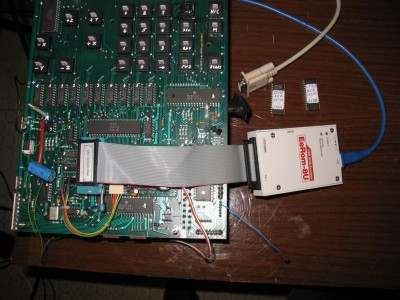

I had already an old EPROM-Programmer and by trial and error (about 5 EPROM burnings) I found the place in the HEX file
for 1200 Bd (the maximum possible without transmission errors, there is no flow control).

Fortunataly a friend had an EPROM emulator and this made the next modifications possible.

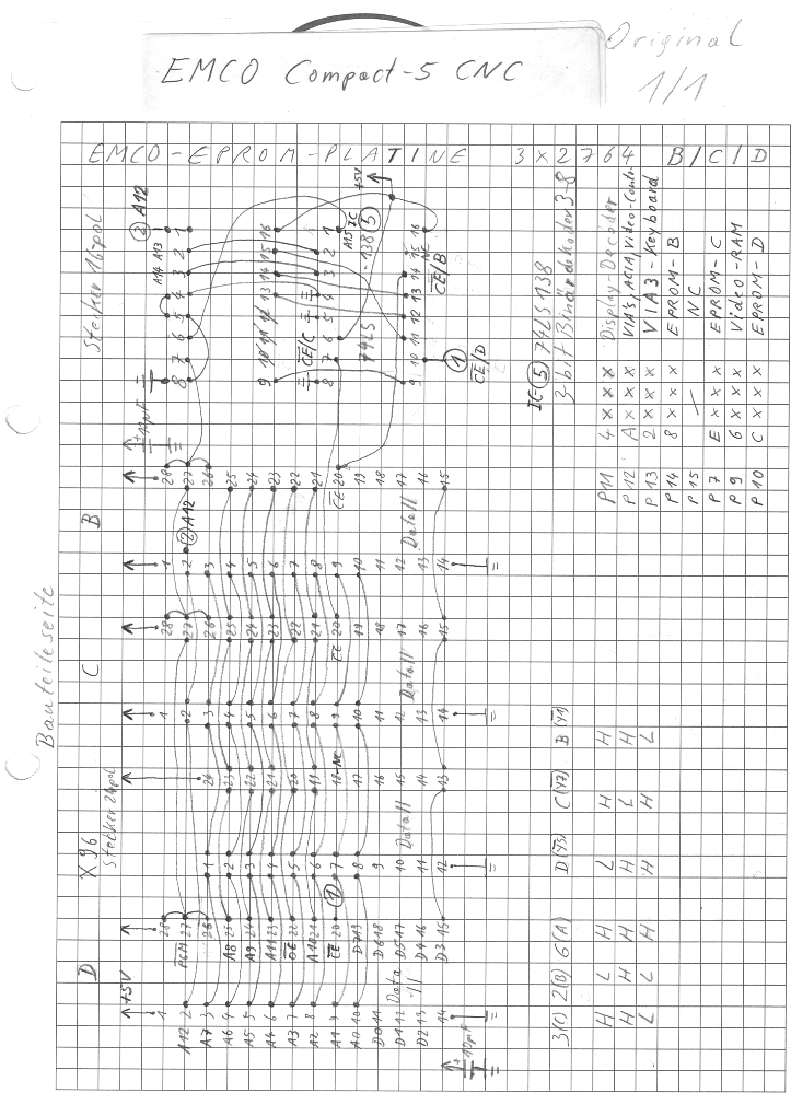

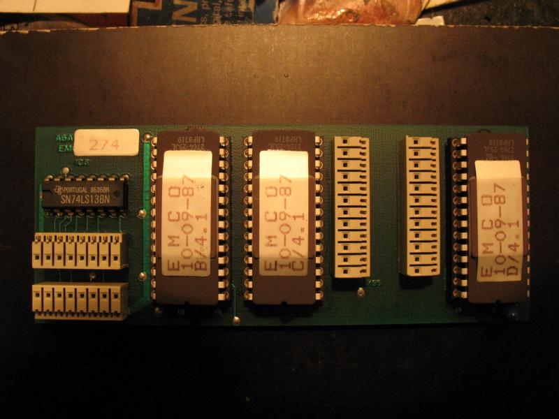

I replaced the 3 2764 EPROMS with a 27256 to store the whole code in the emulator by wiring OR the
3 CS with shottky diodes.

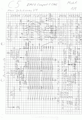

With 5kB of memory a CNC program was limited to 210 blocks. (it seems that machines existed with 222 blocks)
To extend the memory at 16kB I moved the addresses for the display driver and the keyboard matrix VIA
to a free space and used a 256 kb CMOS RAM I took from an old PABX CPU.
A Gold cap saves now the memory, impossible with the original RAM's (NMOS)
and they are now disabled by wiring CS to VDD.(no need to desolder, they draw only a few mA in standby)

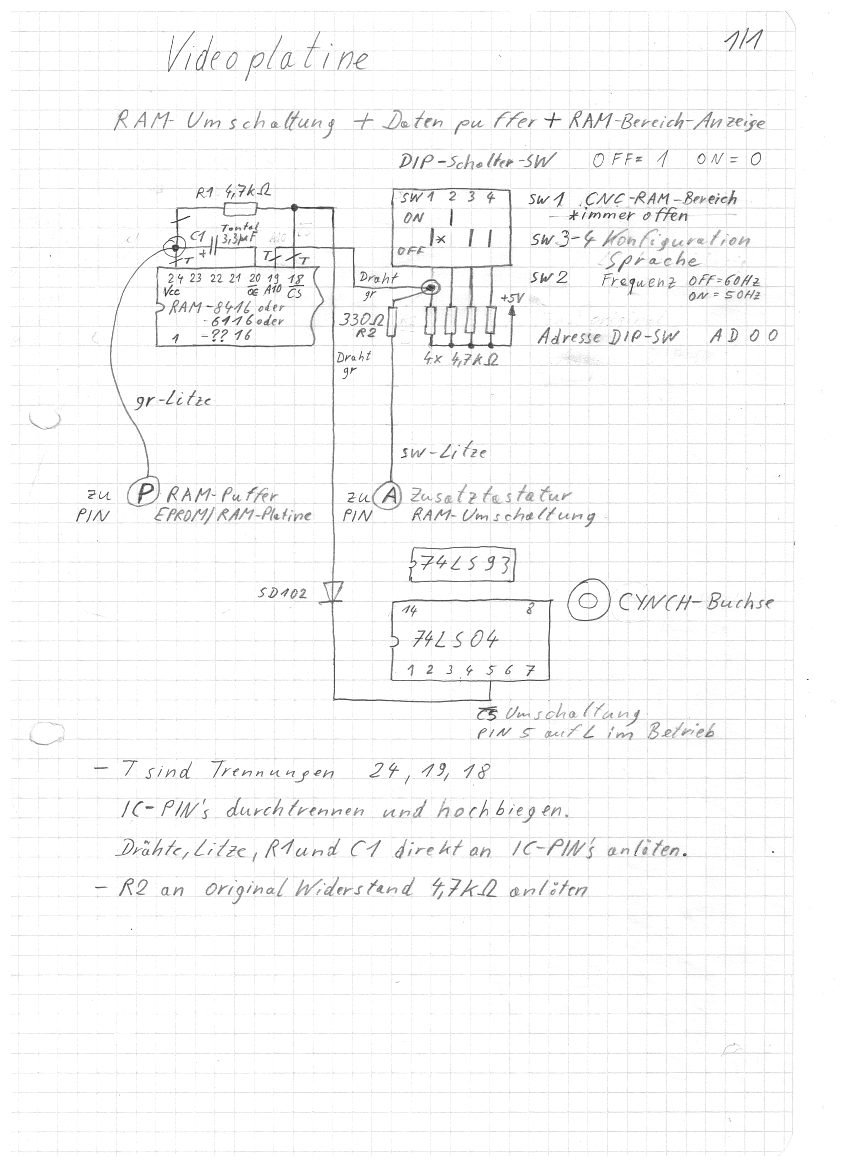

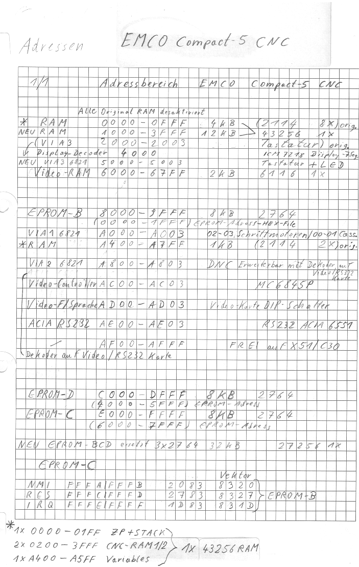

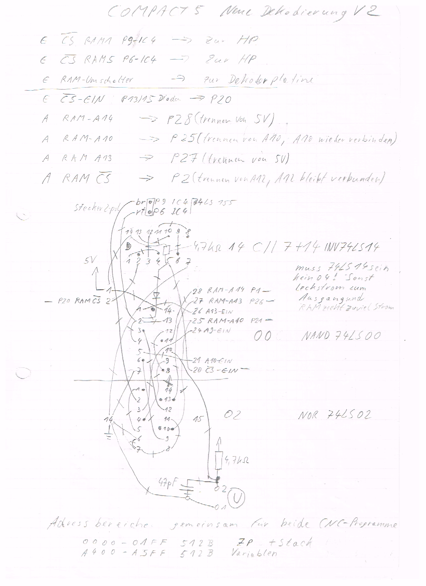

But half of the new RAM and half of the original video RAM where not used so I made a manual "bank switching"

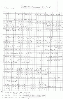

to store two independend CNC programs. The zero page, stack and the area used for variables
don't switch, only the CNC program area, this made the address decoding more complex.
The RAM area is rugged: $0000 - $3FFF used for page zero, stack and storage of CNC programs
and $A400 - $A7FF for variables (originally installed on the CPU but not in use in my software version,
if used it frees the end of CNC-RAM area and one can store 222 blocks with original RAM's, it's funny
that EMCO didn't use it immediately, but RAM was expensive and there are pictures of CPU's without the last 2x 2114)
The new RAM allows 2x 990 blocks of CNC Code.

The video RAM now stores comments present in the CNC program files and is also switched.

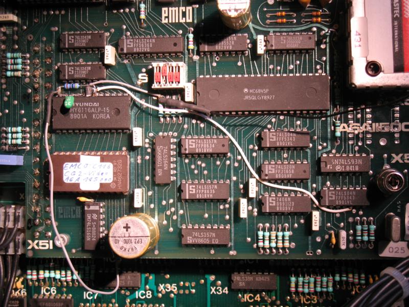

A lot of "flying wires" where necessary and it doesn't look professional but it works.

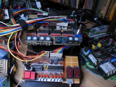

I added a reversal relay board for the spindle motor and added the CNC command M04 for counter clockwise rotation,
an additional keyboard to emulate important commands which need double keystrokes (STOP and intermediate STOP of
a program, loading/sending programs over serial link), the "bank switch", an X/Z indicator when hitting end stops etc.

File comment: The video and RS232 board on the lathe, you can see the "flying wires" for EPROM bank switching".

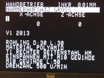

File comment: The screen in "HAND MODE" showing a header (workpiece name) and comments imported from the CNC file.
The inverted 1 shows the CNC program bank (1 or 2).
I added this feature and meantime one can also use lower case letters (modified character EPROM ) and I changed also the layout of the first line.
Originally the screen showed only the first line and the X / Z position, what a wasting of screen area. :-)

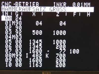

File comment: The screen in "CNC MODE" showing now only the header in the second line and the CNC program.
The second line is originally used for alarms and messages, so the header is overwritten and restored when necessary.

If you consider the time it took it's not very impressive, I made it over years with long pauses.
I got the machine in 2012, the first mod was the baud rate by playing "Battleship" to find the parameters in the EPROM's.
I looked in the datasheet of the 6551 for the 300 Bd rate parameter and replaced step by step the corresponding value.
If I remember correctly it took about 5 EPROM burns, I had only an old Eprommer.
Step by step I learned but I forget so rapidly, I must always "Restart".

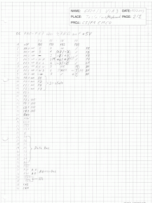

Don't expect detailed and professional drawings, I make a sketch when needed an it's good for ever.
Hope it's clear enough, the text is mostly in German.

Here is the result of my "research":
To get the remaining addresses not found by probing I had to retrace on the CPU:

- And you've done a very tidy job with the board you built to trap A8 - A15 -- I'm sure it's a pleasure to use.
This was the first version.
I made an extension for 16-bit PC and Data address trapping and reading the data
with HEX-coding switches and added TIL 311 HEX- Displays:
A switch selects either only PC or PC with data address for reading data.
An other switch selects R/W or both when searching for data.
The DIP switches (you see them it in the background) allows finding of PC addresses by
disabling the last 3 latches, finding the highest address with the HEX-coding switches,
then enabling the next latch, finding again address etc to find the complete PC of an event.
It's far from perfect, it lacks of reading 2 Bytes immediately so I must make 2 reads for 16 bit data.
File comment: Extended 16-bit PC / Data address trap and 8-bit data readout with ancient TIL311 HEX displays.
I can switch them off, they get relatively hot, even with reduced voltage for the LED's.
I will make a try by pulsing the blanking input.
Some more pictures:
File comment: The original EPROM board with 2764 EPROM's and decoder.
EMCO made this board to upgrade from 2732 to 2764 EPROM's with the old CPU avoiding a new PCB layout.
File comment: Modified Version 1 with 27256 EPROM, 43256 RAM and Goldcap memory backup.
The new components are added in "Tube Radio" fashion.
Limited by the address range of the CPU a large area of the RAM remained unused.

File comment: Modified Version 2 with additional 2x CNC RAM address decoding board.
Now the whole RAM is used by switching between 2 CNC RAM areas, the ZP, the stack and a variable area remain the same.
The ribbon cable allows changing the EPROM without unmounting the Video board.
It adds however signal delay to the more complex address decoding, perhaps I need to remove it
or change to faster IC's when using 65C816 and higher clock rate,
it works with 1.5 MHz and original UM6502.

File comment: Sketch of modification on the Video board for CNC RAM switching and connection to the memory backup Goldcap on the EPROM board.
The leftmost free input from the DIP switches is used for display of CNC RAM area 1 or 2 on the monitor.
The other originally used switches select language and monitor frequency.
File comment: Modified Video board
