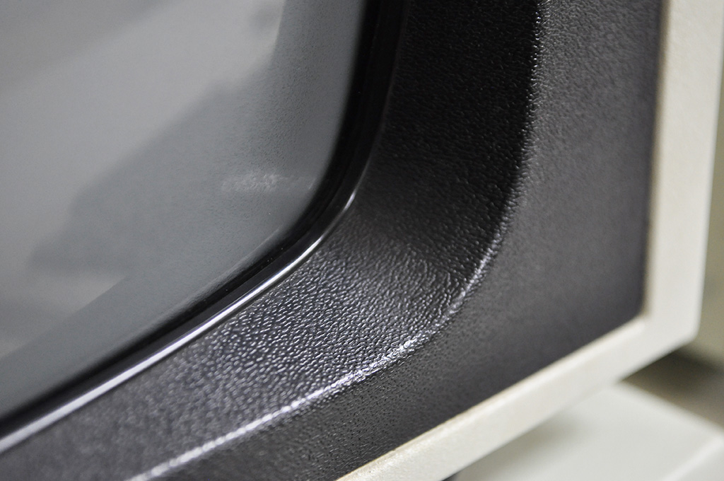

On a more current note, the one design issue I will be up against this year is the monitor bezels.
I don't intend to use the 1702 monitor bezels because I want more of the PET look, and I want to make them myself.
This is exactly the look I intend to copy....
This is most likely vacuum formed plastic.
My first thought is to carve the bezels from wood by hand and then cover them with epoxy and attempt to get the rough look later.
I don't care how much work it is, but I do want to get close.
I would consider farming this out as well if I could find a plastic prototyping service that didn't cost a fortune for 2 of these.
Not sure what's out there these days, but a few years ago I looked at 3D printing something, and it was crazy expensive.
Any suggestions here would be great. I want these completed before spring.

PostPosted: Fri Oct 09, 2020 4:35 pm
Posts: 1378
For a textured bezel finish, it reminds me of the 50's... ARRL manuals. Homebuilt radio gear was finished in either Black Krinkle finish or Gray Hammertone finish. You can still get the black textured paints... they generally refer to them as wrinkle or textured... but I still prefer krinkle :wink:

You might find something in an arts & crafts store with the desired CRT bezel surface that could serve as a mold. It would have to be applied in pieces, so you'll have to get creative as to how to hide the seams. It's amazing what a big place like Michael's has. I like to go and just browse. It gives me all kinds of ideas of how I could do something.
