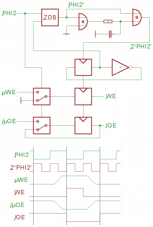

Another idea for generating the register write clock signals:
Running the microcode latch at twice the speed of PHI2:
Doubling PHI2 frequency with a ZBD (zero delay buffer) might be possible, but CY2302 only can generate 133MHz max. when driving a <15pF load, we would have to find a faster ZDB...
..or to creatively use XOR gates for doubling the output frequency of the ZDB like in the picture above.
74AUCH16374 clock is specified 250MHz min., implementing the microcode latches with that chip would limit PHI2 to 125MHz, not sure if that's a good thing.
Since one microcode latch output only drives the clock input of one register chip (not much capacitance), using PotatoSemi PO74G374 here might be an option.
Placing an AND gate in front of the microcode latch input to make sure that WE0 only can be high in the first half of the PHI2 machine cycle:
Of course, one could use a fast 2:1 FET switch instead of the AND, but plenty of 74AUC2G53 chips with the select pin tied to PHI2 won't be a good thing (PHI2 capacitive load).
There are bigger chips designed for switching bus systems, containing 16 2:1 switches or such.
Renesas\IDT IDTQS3VH16233 probably would be too slow, maybe TI has a similar chip, PotatoSemi PO3B40A looks interesting.
