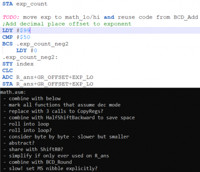

Coming up on a year since the contest began, so I'd like to give a little update:
The circuit is now on protoboard instead of a breadboard, so it starts reliably every time. The only thing the circuit relies on from the breadboard is the power rails. Surprisingly, even though the voltage takes a long path from the power source through the rails, it doesn't drop any voltage along the way. Running the supply voltage through a breadboard jumper wire drops 0.4v which was the problem I had before moving everything to protoboard. This must be what was keeping the circuit from working half the time.
The LCD is now a 128x64 graphical LCD instead of a 20x4 character LCD. In the picture, you can see the pins running along the top of the LCD since it's technically upside down. This makes the screen writing code a little tricky especially since there isn't room for a screen buffer with just 2k of RAM. Another challenge was getting the 6532 to output data to the LCD. The LCD Enable pin has to be raised to write but then needs to be lowered before the data bus changes since it doesn't latch on clock up like you might expect.
The LCD is arranged in 8 rows that are 8 pixels tall. This makes it easy to use a 5x8 font (6x8 including white space) instead of the 8x8 font above. Now all 12 digits of precision fit on the screen for floating point numbers. After posting in another thread about free fonts, I made one myself, then made a few different versions. The squarish font with thin lines is my favorite so far.
calculator fonts.png (5 KiB) Viewed 6485 times
The firmware is coming along slowly but surely. Adding, subtracting and multiplying works for floats. They have 12 digits of precision with proper guard, round, and sticky digits. My reference implementation is an emulated HP-48GX. One plan to verify my calculations was to generate random floats, send them to the HP-48GX for calculation, then check the result against what my firmware computes, but I decided against that since it's not easy to get large amounts of data into and out of the emulator. Instead, I ported my javascript 6502 emulator to node.js so I can run the emulation from the command line. A Python script generates millions of float pairs and outputs them to a file which comes to about 200MB that the emulator takes in as key presses. Running the tests 24/7 for weeks probably won't shorten the life of my SSD, but I set up a RAM drive for this anyway just to be sure. The first test is a round robbin where every number on the list is added, subtracted, and multiplied with every other number on the list. Edge cases like 0 and the largest and smallest possible float values are on the list every time so they get tested with a lot of randomized numbers. The second test starts with two randomized significands and generates number pairs from them where the exponent difference goes from 0 to 16. This is good for testing addition and subtraction since the exponent difference in the pairs in the first test is usually so big you have to skip adding. The Python script also outputs the expected answer to the file so the emulator can check the result and halt if there is a discrepancy. The Decimal library in Python can be configured to use 12 decimal digits, round ties to even on calculations, and round 5 up on input, which is what the HP-48GX does. Testing in node.js is only a little faster than running the test in the browser, but it's easy to keep it minimized 24/7, and I can still use the emulator in the browser to work on the firmware while the tests run. Someday I'll try either porting the emulator to C so I can compile to webassembly and have it run much faster in both the browser and in node.js or I'll just port it to a console C program to make testing faster and leave the browser emulator as it is. Doing this randomized testing has helped me catch several mistakes, although it's not enough by itself to ensure my calculations are reliable since it can only test a very tiny number of possible calculations.
The firmware is now under 6k and hopefully will fit in an 8k ROM. Next will be division and trig and log functions then the rest of the Forth system like loops, IF..THEN, and deleting words with garbage collection. This will probably be more than 8k, so the plan is still to go back and rewrite some of the assembly in Forth once all the pieces are together. My source files are marked with tons of TODO comments in places that can be made smaller, and I made a little script to search all the files and shows all the TODOs:
