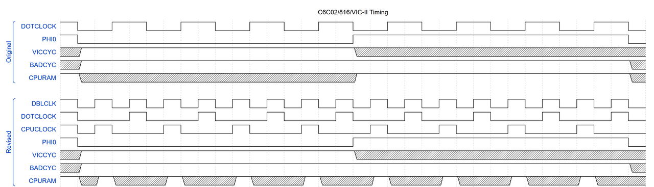

In a C64, the VIC-II controls the CPU, giving it the clock and stopping it
through RDY and AEC pins.
In a C64, the VIC-II receives two clock ticks. A "COLOR CLOCK" for the video
color generation, and a "DOT CLOCK" for its internal workings, where it gets
divided for external CPU clocking. A 8701 chip gets those clock given to the
VIC-II.
What about this?
Put a clock in a board of double the rate a 8701 needs to be fed with
(double of 14.31818 or 17.734472 Mhz).
Make the clock send: one tick to the 8701, and the other one to a 65c02/816
chip, so both the chips would receive its intended tick one each following
the other, alternately.
The VIC-II would behave as always, and the 65c02/816 would too. Both of them
would be able to access the RAM never at the same time, because their clocks
would never overlap.
But maybe that wouldn't stop the VIC-II to need being able to stop the CPU
to gets its reads during badlines, sprites and so.
Also, the VIC-II wouldn't be able to stand access for read or write to its
registers at such a high speed from the CPU (although the datasheet does not
list a "minimal" time for that - or I can't read a dataheet).
What do you think?

If I understand you correctly, you'd do this:
This assumes the VIC-II can handle a cycle width half as wide as it normally sees, but for sake of argument...
As you can see, PHI0 is still 1MHz, and a bad cycle still consumes 100% of it, meaning the entire cycle is not available for the CPU.
(For reference, this timing diagram is from WaveDrom - https://wavedrom.com/editor.html and the code to create it is:

An alternative would be to send 8 double speed clocks to the VIC, and then 8 periods of no clock, and let the CPU use that second set of 8 clocks to do work, but I doubt VIC would operate with such an irregular clock, so I think that is a non starter.

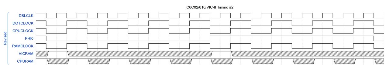

The best bet is to throw each address/data line set into a mux with some really fast RAM (if you're planning to run the 65C02 at 8MHz, that means RAM needs to be <125nS, but you need to access it only on the high half cycle, so 62nS or better) and a latch. In the front half of each half cycle, you allow VIC to access, latching the data into a register and then presenting it to the VIC as DATA for the remainder of that half cycle. On the back half of the cycle, let the CPU have the RAM directly. Most of the VIC accesses would go unused, but each device would have total access to RAM (some provision needs to be made for when the CPU needs to talk to the VIC, but to do that, it needs to slow down to 1MHz, and then you're waiting on the VIC anyway:

Realistically, the VIC address lines won't settle down that fast, so you'd need to put the VIC data access about midway through the 1MHz half cycle (but, I didn't feel like updating my diagram, so just imagine it). In any case, that's the best way to use a 1MHz VIC-II and an 8MHz '02/816 and not have to deal with bad cycles.

If the CPU tries to access the graphics data when VIC is accessing, it'd have to be halted for the duration of the VIC access time (could be up to 65uS). So, your idea is more prone to stalling. If you mirror the RAM, then reads can be done from other RAM, while writes would still stall.

I understand, and you can do NOP instead of halting the CPU, but the effect is the same (62-65 uS of the CPU waiting). A badline is 62-65 cycles of consecutive double VIC-II accesses, with no RAM time available for the CPU.
Jim

Beamracer implements a dual port functionality in the CPLD/FPGA, just like I described initially.
Yes dual port RAM would prevent accessing the VIC registers. You'd have to have a "bypass" that allows the CPU to talk directly to the VIC-II
And, 1024MAK is right. Anything is possible, but it requires lots of glue logic to implement.
