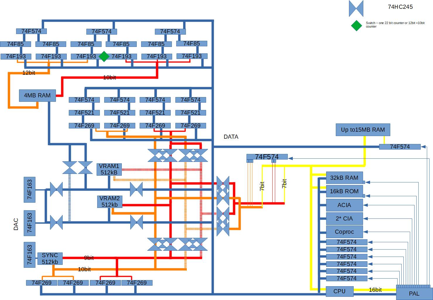

Design goals:
VGA Video 640x480 or 800x600
no FPGA or micro crontroller
I like the Vulcan copy machine
16k part of the video buffer should be mapped to the CPU 64kb memory space
some extra memory for data (64kb is not much for data)
I also want to add a AMD coprocessor ... just for the kicks.
64 colors (2 bit per color)
I came up with this layout:
The CPU controls a number of 574 chips. I will need a number of GALs to create the selection logic. The whole address space looks like

The extra 574 register to the top right helps to map the extra memory (16kb at a time).
The Video memory is double buffered. One buffer is used by the sync counters to generate the VGA signal. The second buffer is written to in parallel either from CPU or the copy machine. That means I have a number of possible datapaths between the components, and I plan to use (a lot) 245 chips to separate each of them. Another issue is the bus width of 9 and 10 bits - that adds the need of some extra 245 chips.
The sync signal is generated by 2 counters and a 512kb memory chip. I will need to set up correct information in the memory during initialization of the computer. The 8bits will also reset the 2 sync counters at the right time.
There is a copy machine. The source counter is made up of 193 chips and can be switched between 2 separate 12bit counters and a full 24bit counter. I figure a simple transistor between counter four and five should do the job, pulling the ripple input low if I need 2 separate counters.
The destination counter is made up by counter-comparator-register trios forming 2 10/9 bit counters to address the buffer ram.
This little trick should enable me to access a 64x64 (7bit by 7bit) Window of the Video memory. Adding 3x bits and 2y bits to the IPC of the 6502 should allow me to directly draw into the video buffer
So please tell me what you think and help me straighten up the design

PostPosted: Thu Jun 18, 2020 8:35 am
Posts: 10943
Welcome Michael!
Nothing if not ambitious - anything is possible, but some things take longer to build or longer to debug. I'd recommend an incremental approach, especially for any aspect you haven't tackled before.
Also, while anything is possible, as you add complexity you are likely to be sacrificing clock speed, so if you want an unlimited complexity budget, you might not meet some specific clock speed that you had in mind. And the closer your design gets to not quite working at speed, the harder the debug. So a modest speed goal might be a good place to start.

very interesting design. for practical approach I personally think using a FPGA/CPLD is test out the design (I know you said you didn't want to use FPGA); otherwise it will take alot of time and effort to wire-up all the TTL chips and debug the design.

It's a very ambitious project, but have you thought about the sort of speed the 6502 will be able to write to the video RAM? I suspect that 640x480 (at 8bits per pixel) will take far to long to clear the screen, let alone write some text to or draw a line, or scroll.
Even if you used the 65816 block-move instruction, you have 300KB of RAM to clear, so at 7 cycles per byte on a 1Mhz CPU it will take a shade over 2 seconds. It will be worse on the 6502 as it'll take more cycles.... Get the clock up to 14Mhz or more and it will obviously be much better but you're not going to get 30fps out of it...
Back in the late 70's/early 80's the consumer level display technology (ie. TV sets) mostly matched the hardware capabilities so it wasn't much an issue then - we put up with what we got - 280x192 on the Apple II taking 8KB of RAM, and a couple of years later the BBC Micro dedicated 20KB of it's 32KB RAM to the highest resolution (640x256x1bpp) and we wondered how we'd be able to write any code for it! But don't let that put you off... Especially if you can separate the video part well enough to adapt other CPUs to it in the future, should you want to - or even "FPGA" the whole video part for other retro-system to use?
Hope it goes well!
the main copy/clear operations happen in the video system itself based of 74F chips at 10MHz+. There is an error I discovered after posting in the data bus routing - but the idea is the 6502 writes into the 4MB video ram to set up he graphics. What is necessary is then copied via the multiple counters to either of the buffer memory. Once a buffer memory has been set up, and a VGA cycle is complete, the 6502 switches the 2 buffers.
