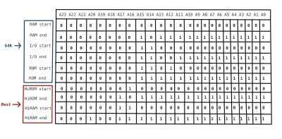

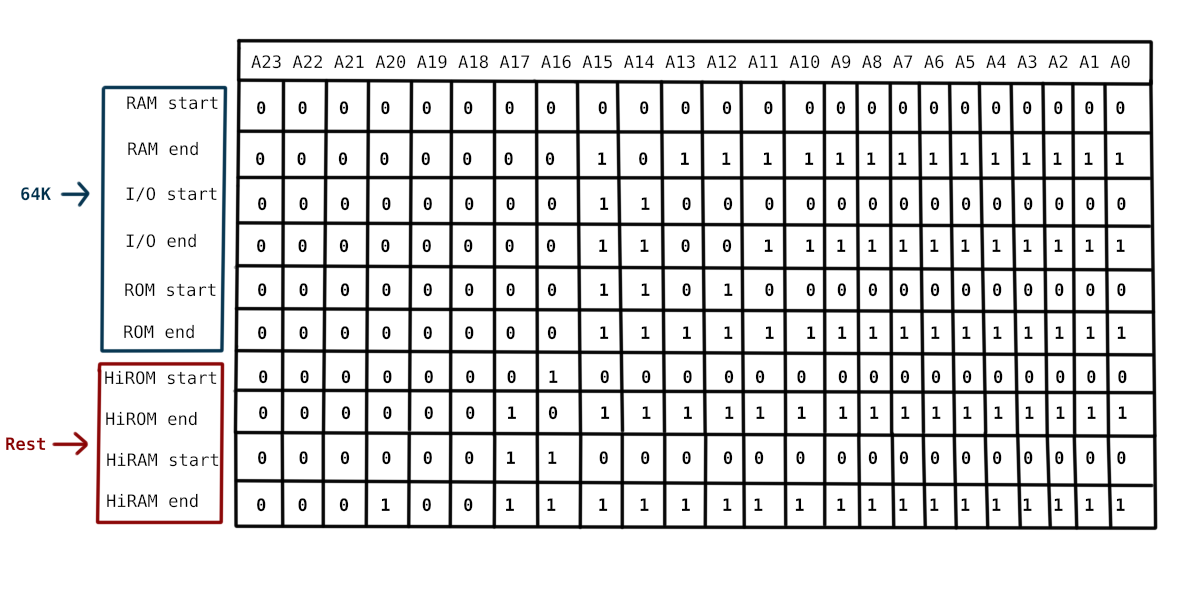

Hello members of the 6502 forum! I'm designing my first SBC computer, and I opted for the 65c816 over the 6502 despite the quirks for numerous reasons, one being RAM. It's quite an ambitious project, but I'm certain it will turn out great in the end. It will primarily be a gaming machine.
However, I've ran into an issue with address decoding since the 65c816 starts in emulation mode on boot and requires a reset vector within the 64K of RAM since that's all the 6502 can map.
I've come up with a memory map that I think would work well for my project, any advice on how to implement it (or a similar, simpler one) would be very welcome. Here it is:
$0000-$BFFF: RAM [48K]
$C000-$CFFF: I/O [4K]
$D000-$FFFF: ROM [12K]
$10000-$2FFFF: HiROM [approx. 128K]
$30000-$17FFFF: HiRAM [approx. 1.37MiB]
$180000-$FFFFFF: Misc. external devices [approx. 15.2MiB]
Attached below is a chart of all the address line bits for the above memory map. I know it is possible to use CPLDs, GALs, PLDs, etc, to make address decoding easier. However, since I'd like to keep the cost down (since I've already opted to use an FPGA for the video generation), a solution with logic gates (or ICs) would be appreciated. If it isn't possible without too much trouble, then I'll opt for an easier solution.
Thanks in advance everyone!

Welcome! If your aim is to keep address decoding simple, then two things will help a lot. One is to keep an eye on the powers of two - the round numbers. And the other is to allow yourself certain forms of inefficiency - you will need to make tradeoffs. So for example, not fully decoding addresses will allow you to use less logic. That means some devices or areas of memory might appear in multiple places in the map.
So, instead of 48k RAM, which is not a round number, consider 32k. You're going to have heaps of high RAM in any case. And 32k is already a lot. And if this means you don't get to use all of the RAM chip, that's just one of your tradeoffs.
Instead of a 12k area for ROM, consider 16.
And then you have 16k for I/O. As you plan to put some I/O devices into high memory, where you have lots of bits of address available, you might minimise the amount of I/O in this 16k area. It would not be wrong to have two or three devices fill up the 16k, by incomplete decoding. In fact, if you use individual address lines as device enables, one device might take up 8k, the next 4k, the next one 2k, and the remainder of the 16k area would be forbidden territory, because multiple devices will appear at the same addresses.

Perhaps the missing piece is this: if you're using higher banks as well as bank 0, then all your decoding for bank 0 will need to(*) detect the high bits and ensure it is bank 0.
That is, the 816 memory map is up to 256 banks of 64k each: it's not 64k and then a lot of banks above that. The bottom 64k is bank 0.

Please carefully study the attached and then ask questions.
BTW, you may need to consider a wait-stating mechanism to deal with relatively slow ROM accesses, but that's getting ahead of the program, so to speak.

I'd prefer to not waste any address space, even if there's plenty on the 65c816.
Remember Thompson's rule for first-time telescope makers: "It is faster to make a four inch mirror then a six inch mirror than to make a six inch mirror."

Better perhaps not to think of waste but spend. You spend some of your address space in the interest of simplifying your system - in this case, the stated aim is to simplify the decode logic.
There are many tradeoffs in an 816 system, because the 816 has various oddities. It does not offer a flat 24 bit address space: Bank 0 will contain the vectors, the stack(s) and the direct page(s). Commonly, I would expect Bank 0 to contain all of the ROM, and also the I/O, although it needn't. There is of course an interplay between your hardware design and your software design.

Yes, I do agree that it'd be more complicated to not waste address space, hence why I'm open to using GALs.
I will be making a simple version in iterations on a breadboard to make sure my design is working slowly, and once I'm happy, I will order a professional PCB. Perhaps this would be enough? Thanks for all the help everyone, and thanks to BigDumbDinosaur for the helpful schematic. It's really helped me understand how to use a different memory map in the 64K than the rest of the address space.

In any case, virtually all 6502-based systems end up "wasting" address space simply because to do otherwise can result in extremely complex glue logic, with little gain achieved.
...thanks to BigDumbDinosaur for the helpful schematic. It's really helped me understand how to use a different memory map in the 64K than the rest of the address space.
Note that by replacing U6b with a 74ACT11030 and inverting the latter's output, you will have the capability to distinguish between bank $00 and the remaining 255 banks. However, the logic required to select individual SRAMs in excess of 512 KB becomes convoluted. Realistically, it is not practical in discrete logic if performance at all matters, which is why I limited that design to 512KB, which is available in a single SRAM.
If you are going to go with more than 512KB it's time to get a CPLD involved. Not only will you need room for the chip select logic, you will need many more output pins to select SRAMs (one chip select per 512KB of RAM).
Also as noted by Ed, I/O could be anywhere, but if not in bank $00, it will be interrupting what would otherwise be contiguous RAM above $00FFFF. That's not necessarily an impediment if your operating system kernel is running in the same bank, as it would be able to access I/O with conventional 16-bit addresses, which is faster than 24-bit addressing. For example, you could place I/O and all of the kernel except the front end of the interrupt service routines (ISR) in bank $01. In bank $00, your ISRs could do a long jump into the kernel in bank $01, at an expense of four Ø2 cycles.
Don't forget that bank $00 is the only bank in which direct page and stack accesses can occur. Also, the JMP (<addr>) instruction looks in bank $00 for <addr> (on the other hand, JMP (<addr>,X) and JSR (<addr>,X) look for <addr> in whatever bank is in PB).
