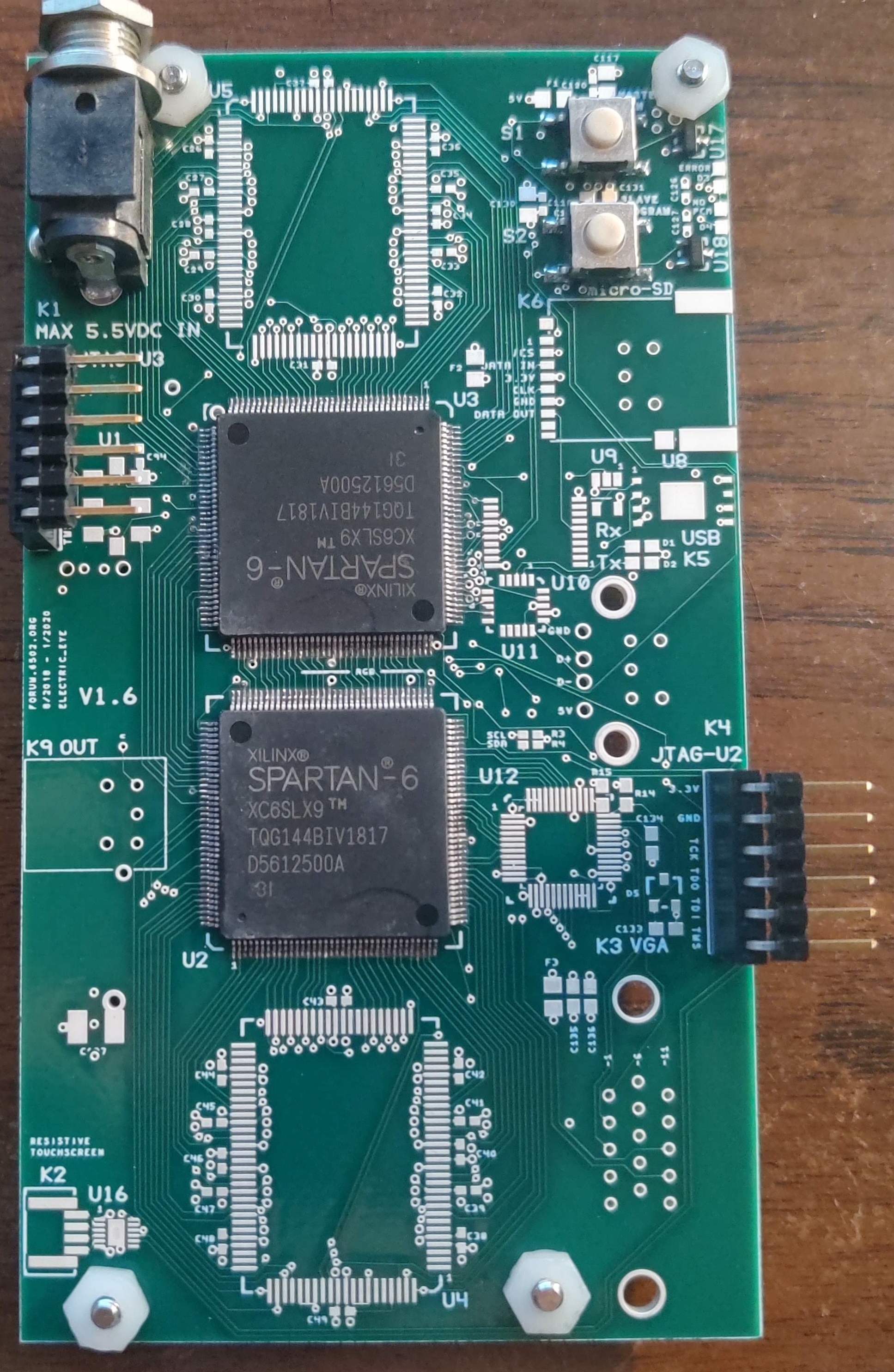

1st attempt, I screwed up and swiped the FPGA pins while soldering and bent them. 1st board was trashed, there was no saving them and they were new parts. I was so pisst yesterday...
After regathering my mental strength, today I desoldered the FPGA's from the V1.5 board where the daisy chain JTAG wasn't functional. I successfully soldered them to a 2nd V1.6 board along with new VReg's and JTAG related stuff. JTAG does appear to be functional for both FPGA SPI FLASHs (W25Q80DV). I chose the legacy device W25Q80BV in ISE14.7. Whew!!
I plow forward with the videoDAC, SyncRAM, I2C and the Si514 programmable Oscillator next. :)
Here's a couple pics... I soldered in a couple 0603 4.7K resistors on pads meant for 0402 (on the bottom). I was out of the 0402, so I tried what I had and they actually fit very nicely!

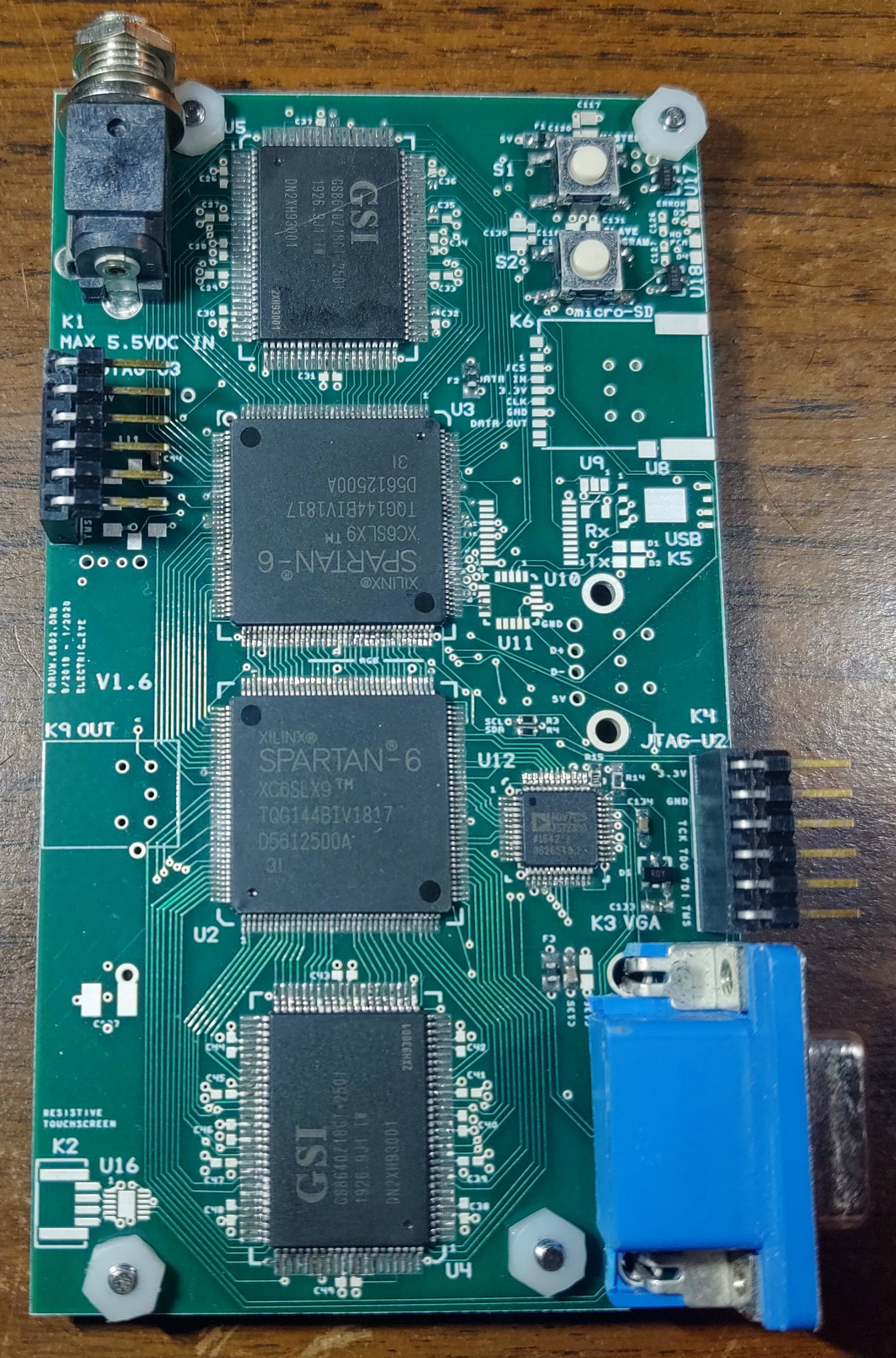

Yesterday I soldered in the 48-pin QFP videoDAC and associated passives, 2 SyncRAM's (1 for each S6), the pullup resistors for I2C, the VGA connector and 3 ferrite beads which are used as power supply filters to some IC's. There is 1 ferrite bead used for the videoDAC and 2 for the digital audio transceiver. Then the board got another ultrasonic clean in 91% isopropyl alcohol. Then I packaged it in an anti-static bag.
As I progress, I find myself gravitating towards a different technique. I use liquid flux now, the ChipQuik CQ4LF-1.0 and fluxless .015" silver bearing solder. This is the way to go! No solder bridges. I hate them! I prefer quick, clean and neat. No cleaning up messes...
Anyway, today after work, I unpacked the board hooked up the 5V main and threw the PS switch. Last time I did this I heard a pop and a ferrite bead jumped off the board! I was fully expecting smoke. But none. And ISE 14.7 saw the S6 and SPI PROMs!
This is a milestone. I can now begin to configure the constraints file to assign FPGA pins to the SyncRAMs and videoDAC. I already have a project to do an initial test.
A sidenote: The Si514 has a slightly different pinout than the Si570. The I2C signals are on different pins. Luckily, the pad spacing is the same for the power and Freq out. I may be able to correct this without ordering new boards.
A pic of the top board as it progresses. Nothing much changed on the bottom yet.
